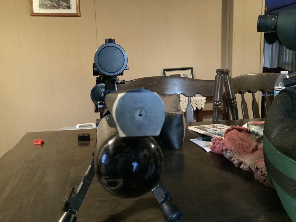

Tape the end of your barrel off. One piece covering up the hole and one piece wrapped around the shroud/barrel/silencer to secure it. Fire a shot then carefully push the tape back onto the muzzle hole. You will probably have your answer. Here are two pics to help you. I do it with every gun I buy and every time I build a shroud.
