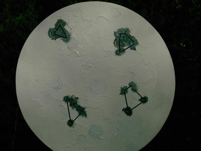

Meanwhile, here are four consecutive six-shot groups at 97 yards with a .22 Sumatra Carbine-
P67, those groups were shot after much tuning of the gun to get good hunting power and a reasonable number of shots per charge. As taken from Airgun Chronicles-
15.9gr JSB Exact, 3000 PSI, tuned for reduced power, 24 shot powerband- Lo= 872, Hi= 905, ES= 33, SD= 6, Avg= 890 FPS/28.0 FP.
Over two years, 61 six-shot groups with 15.9 gr. JSB Exacts averaged .795” c-t-c at 50 yards.
