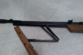

The rifle must be cocked first to pump. The pump system is comprised of 3 separate linkages all attached to the forearm; called the (Push bar), (Link) and (Pull bar); a really odd looking system, but it works! The open stroke (pull bar) must be brought to its complete open stroke to complete retraction of piston pump then the (push bar and link) i.e.; (piston pump) takes over as the forearm is closed and charges the valve. (Best I can explain it)

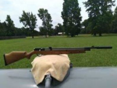

Next will be the accuracy test, conducted at 20 yds. Personally I have no interest in scoping MSP Rifles, I have always found scopes to be a hindrance in some manner while pumping, others of course may disagree! All testing will be done using existing factory sights. All shots from bench rest.

Final thoughts; the DFM2 appears to be a good solid rifle at least in my limited exposure, the PUMP links when first looked at, seem as though they may be fragile, but I have had no trouble so far, only time will reveal this!! The power and accuracy are good. Regarding the ease of pumping with this system, there is still some degree of difficulty in pump effort in this unit, but it is not what we normally expect with our current known MSP units. The upstroke requires a pretty good effort as well as the initial closing stroke (on other current MSP units there is virtually no effort in the opening sequence!) however when the forearm on this unit is about 3inches are so from closing there is no pressure to complete the stroke.
In fact when one reaches this point, it is not necessary to complete the closing stroke, one can then raise the forearm to start another pump up effort.
What this system does attain is no change in pumping effort (1-15) throughout the pump effort start to finish as opposed to other systems that gradually increase effort with each pump!
