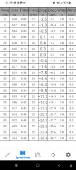

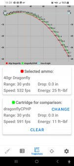

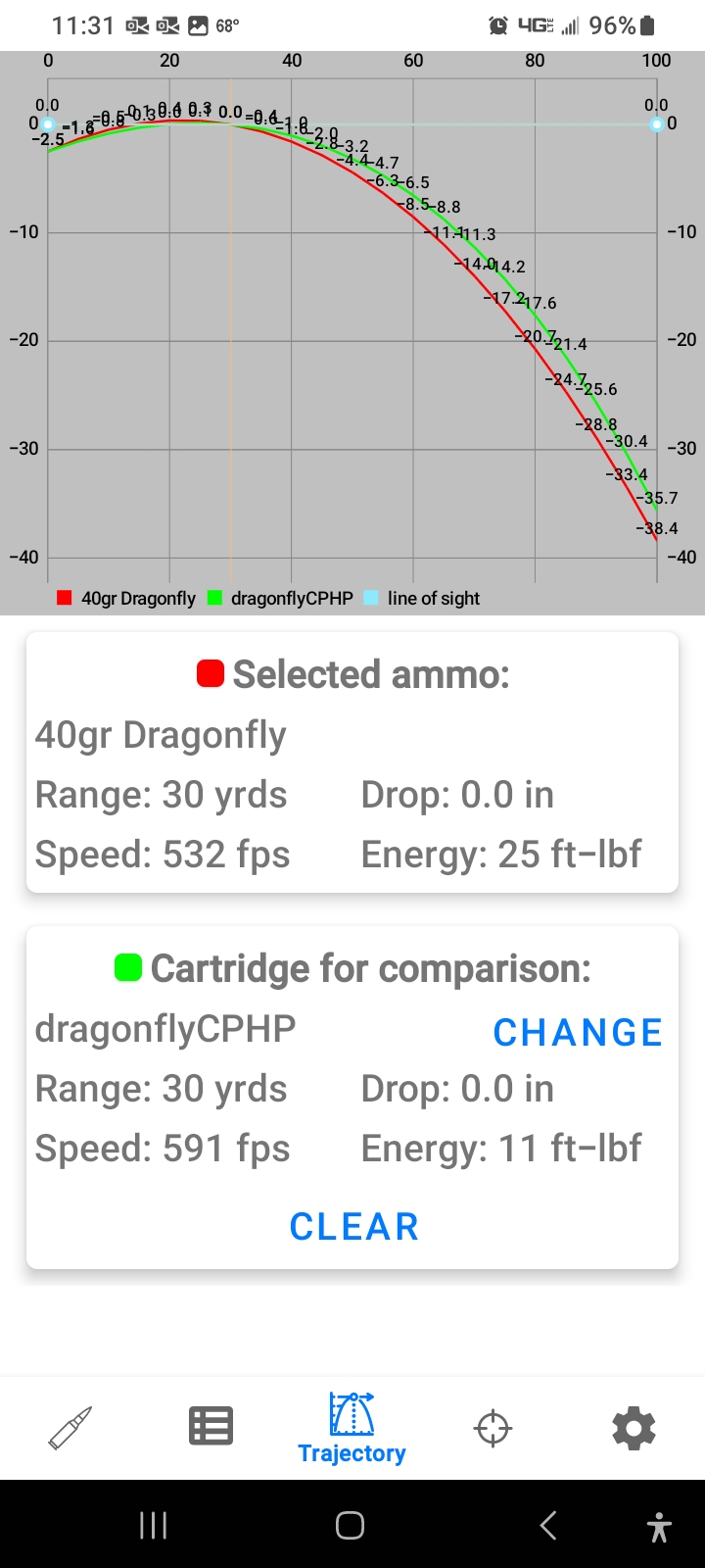

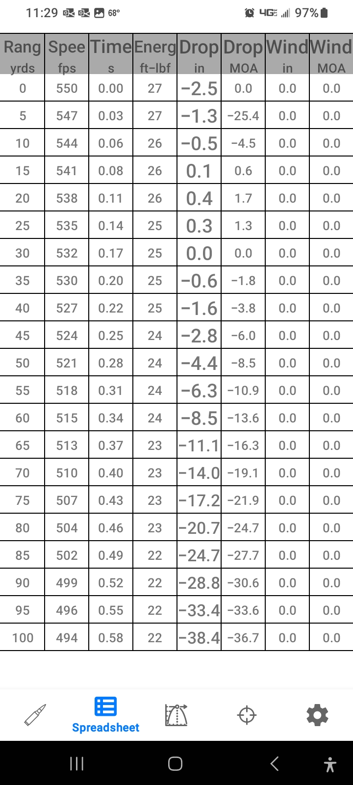

🤟🤓🤙 some.figures for ya
DOPE chart for the particular setup
And then a graph comparing the slugs to a good ole cphp
Enjoy 🫡☯️🤩

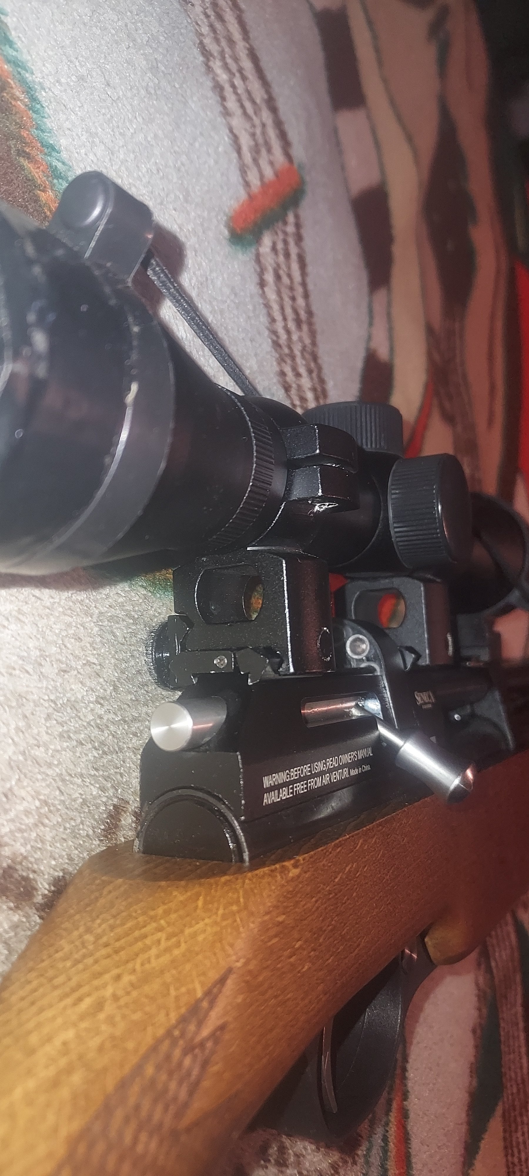

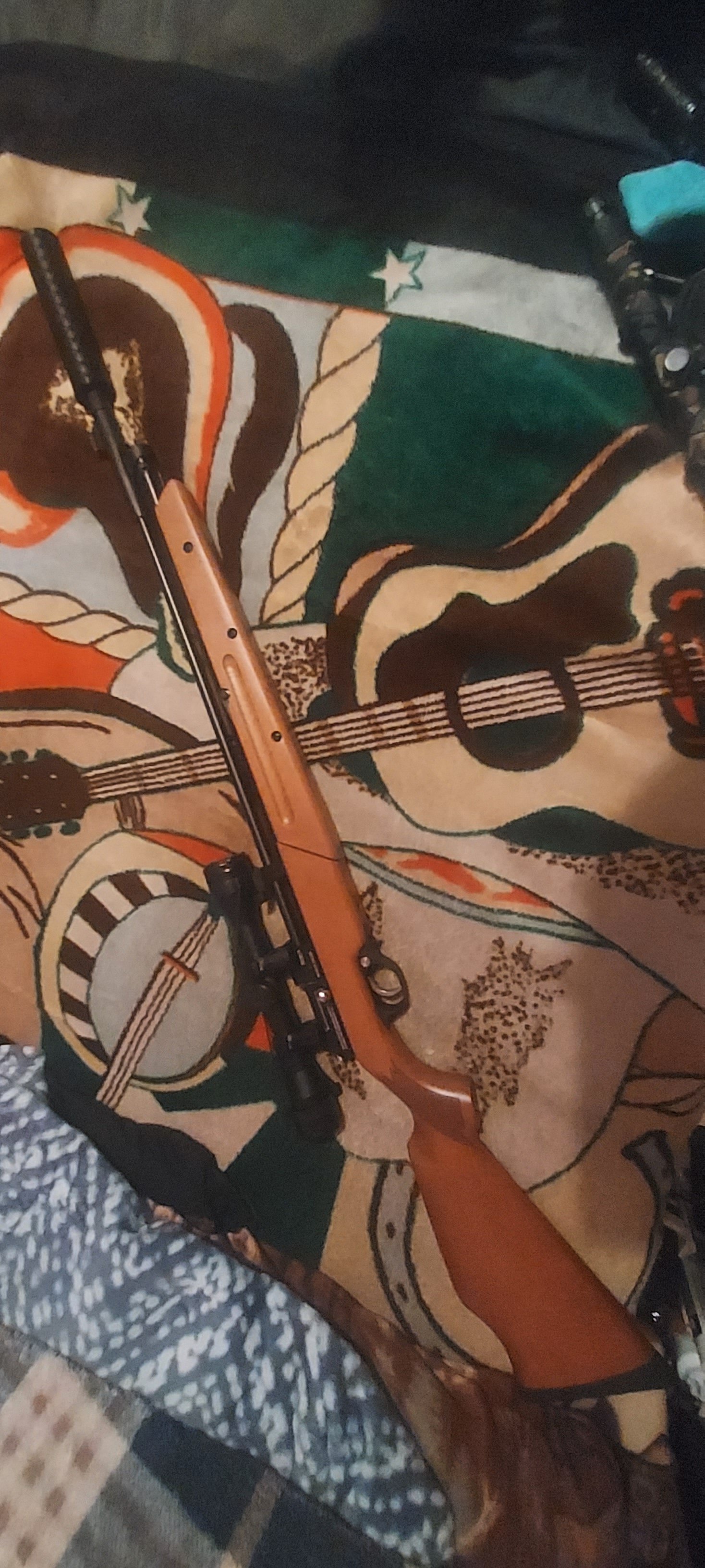

Ok! Enough of the giant scope(it made this thing too heavy).
Put on my ruger scope and found a set of my see thru mounts. They didn't work on another build so I tried them here. I can see my irons under there!🤗
Well....Got enough of a window to make them usable!😆
Scope weighs probably half of the one I had on it.
(The scope that comes with the ruger impact max elite. 22)
Better suited in the lightweight department than before for sure. I can toss it up and down in one hand🤣🤙
View attachment 368363View attachment 368364
