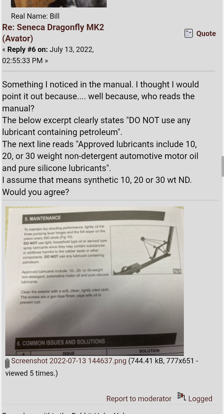

so did you oil the cylinder
AV will never help you i tried year ago
it is a Snowpeak product
https://www.pyramydair.com/airgun-resources/manuals/AV-DragonFly-MK2-manual.pdf
ANCE To maintain top shooting performance, lightly oil the three pumping lever hinges and the felt wiper on the piston every 500 shots (Fig 10). DO NOT use light, household type oil or aerosol type spray lubricants since they may contain substances or additives harmful to the rubber seals or other components. DO NOT use any lubricant containing petroleum. Approved lubricants include: 10-, 20- or 30-weight non-detergent, automotive motor oil and pure silicone lubricants. Clean the exterior with a soft, clean, lightly oiled cloth. The screws are a gun blue finish; wipe with oil to prevent rust.

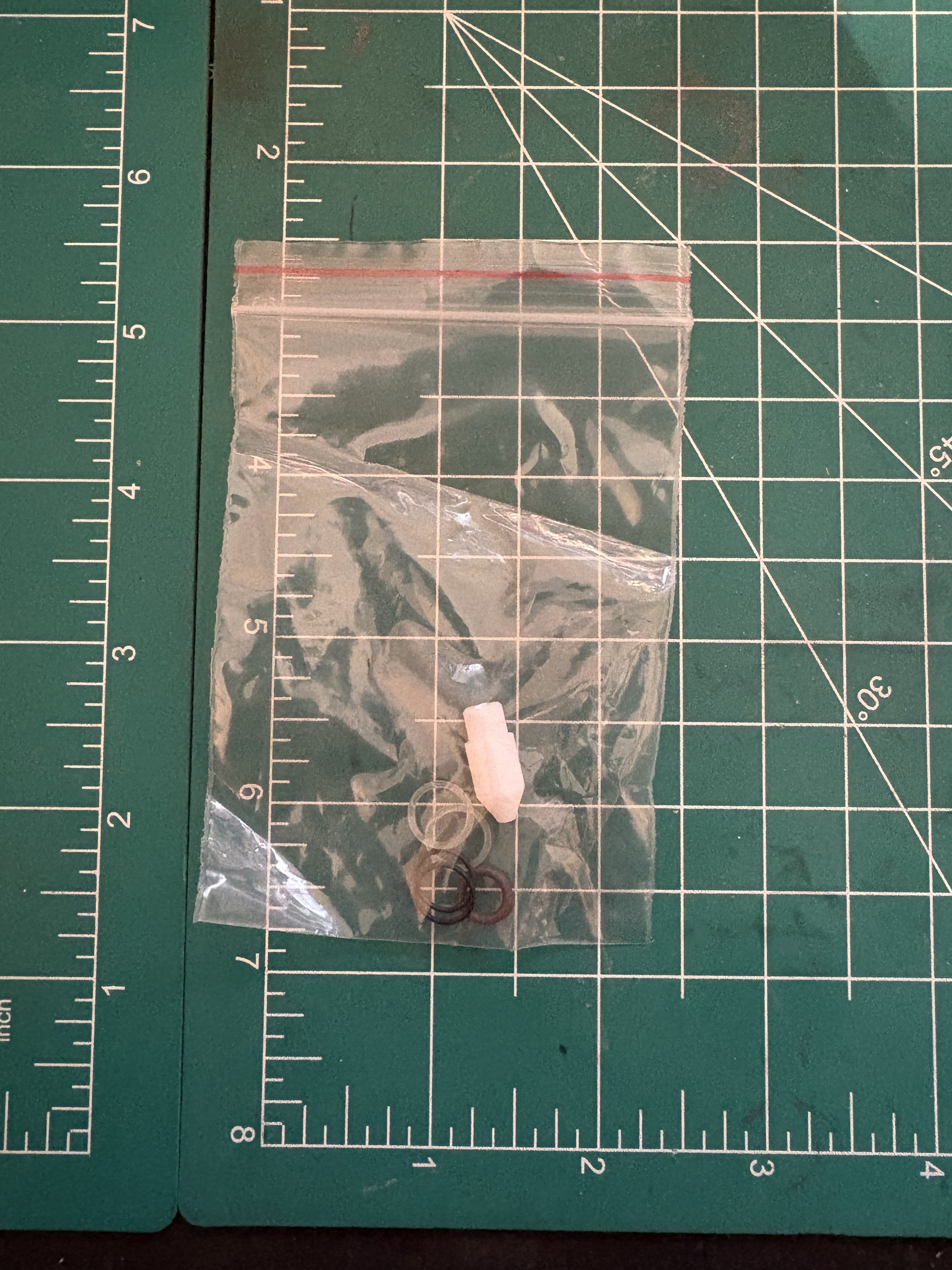

Didn’t realize it came with extra parts!
