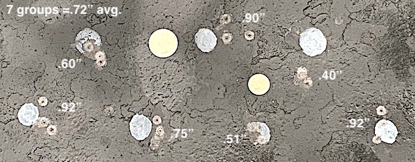

I got out yesterday to take advantage of very light wind conditions for a little more accuracy testing of my .22 Dragonfly M2. But this time I decided on (more realistic for multi-pump guns) three-shot groups at 50 yards; not only for the sake of better concentrating on each shot, but to reduce wear and tear... on the shooter!
Parcel to seeking the best possible accuracy results, (for the first time) I lubed all pump-pivots with DriSlide moly lube, the pump felt and chamber with pure silicon oil. The lubing did lighten and smooth the stroking effort.
Another attempt to reduce wear and tear on the shooter was reducing the number of strokes per shot from my previous 12, to the more realistic maximum of 11 strokes. However, for sort of a 'control', I decided to shoot the first group with 12 strokes. That group measured a promising .90" center-to-center (top-center below).
The next group, the first of six groups on 11 strokes, proved the tightest of the exercise. It measured a scant .40" c-t-c (top-right below)! When the next group went .60" (top-left), I figured I'd found what reloaders call my "accuracy load".
Alas, the next group was one of the two largest; both at .92" c-t-c. Mind you, since I was hoping to achieve a 1" c-t-c (or better) AVERAGE group size, the two largest groups still fell comfortably within my goal. The other two groups measuring .75" and .51" contributed nicely to a calculated AVERAGE group size (of all seven groups) of .72" center-to center; less than the diameter of a penny, and easily completely covered by a quarter. The two smallest groups can be completely covered by a penny, and the smallest by a dime.
For size reference a dime sits between the .40" and .51" groups, and a quarter sits left of the .90" group (shot on 12 pumps). Suffice to say I am very happy with the accuracy results.

That's solid data. Thanks for generating and posting it, AGM. You've got you a shooter!
The chinese can make accurate airguns, they just don't bother with quality control as much as the europeans do. (Slave labor aside...) I do think that you rarely get a chinese gun that doesn't need some sort of improvement from the get-go. It took a year and a half of messing around before I was happy with the QB78 while the original QB77 and QB22 were both great from the start.
I feel you on minimizing personal wear. The Sheridan rarely see 8 pumps these days for that very reason.
