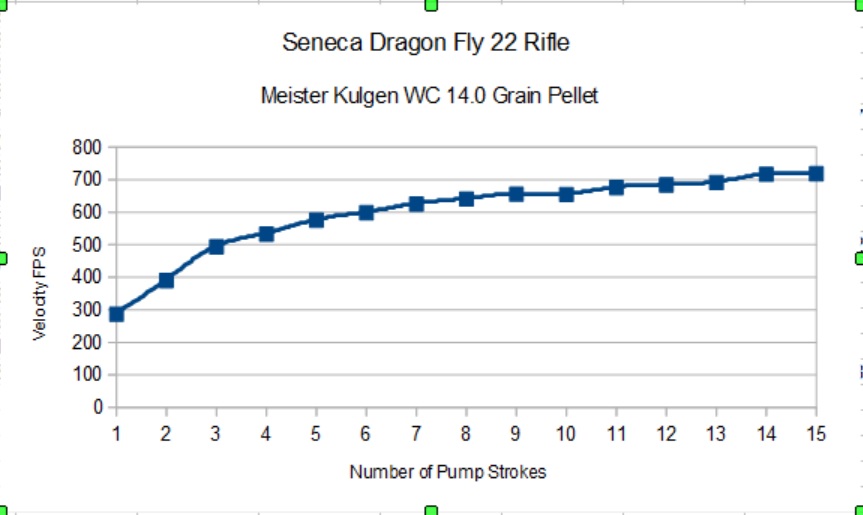

His work there was spot on as far as I have been able to determine. My gun came in this afternoon and (Having read Tom's work) decided to test the velocity at various stroke counts and graph that before actually doing anything else with the rifle. To that end I put some 320 or so strokes into the gun shooting Meister Kugeln 14 grain WC pellets. I chronographed velocities at 1,3,5,7,9,10,11,13,and 15 pumps. I computed Standard Deviations for muzzle velocity at each data point. I extrapolated averages for 2,4,6,8,12 and 14 pumps. I then graphed the average velocities in this chart.
Rather than repeat what Mr. Gaylord said I'll point you to his reviews to read as he addressed all points well. I am going to use this thread to document my adventures with the rifle. I must say I am highly impressed with the rifle, particularly at it's price point. Standard deviations for the velocities were exceptional and averaged out to 6 fps for all data points. I believe that will improve when the rifle is "shot in" which Tom addresses in his evaluations.

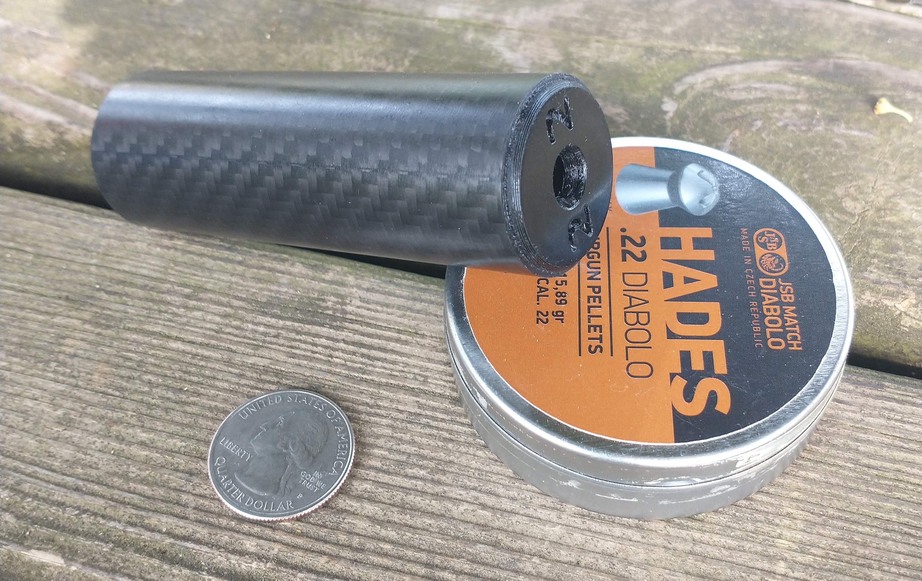

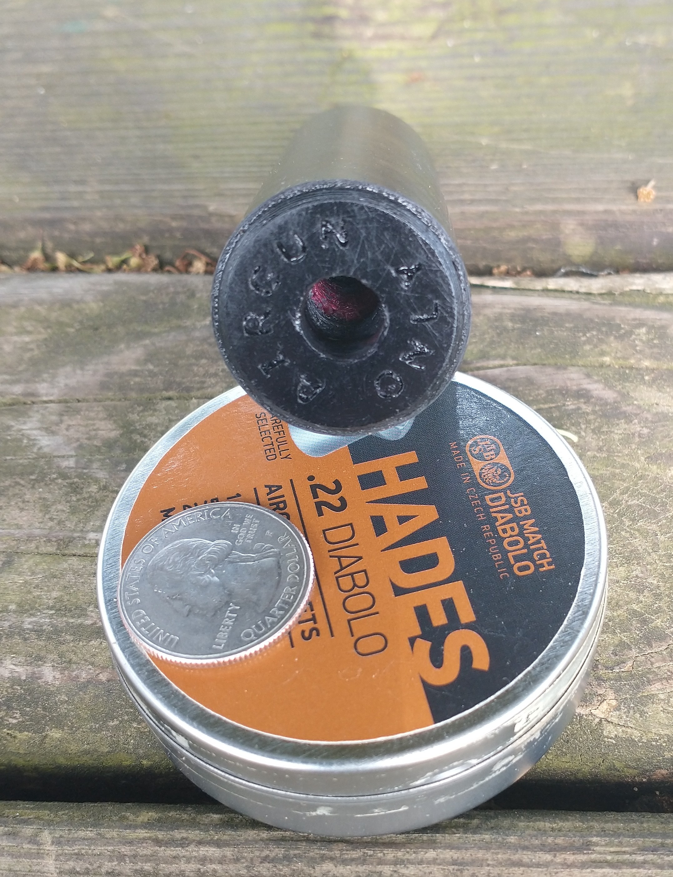

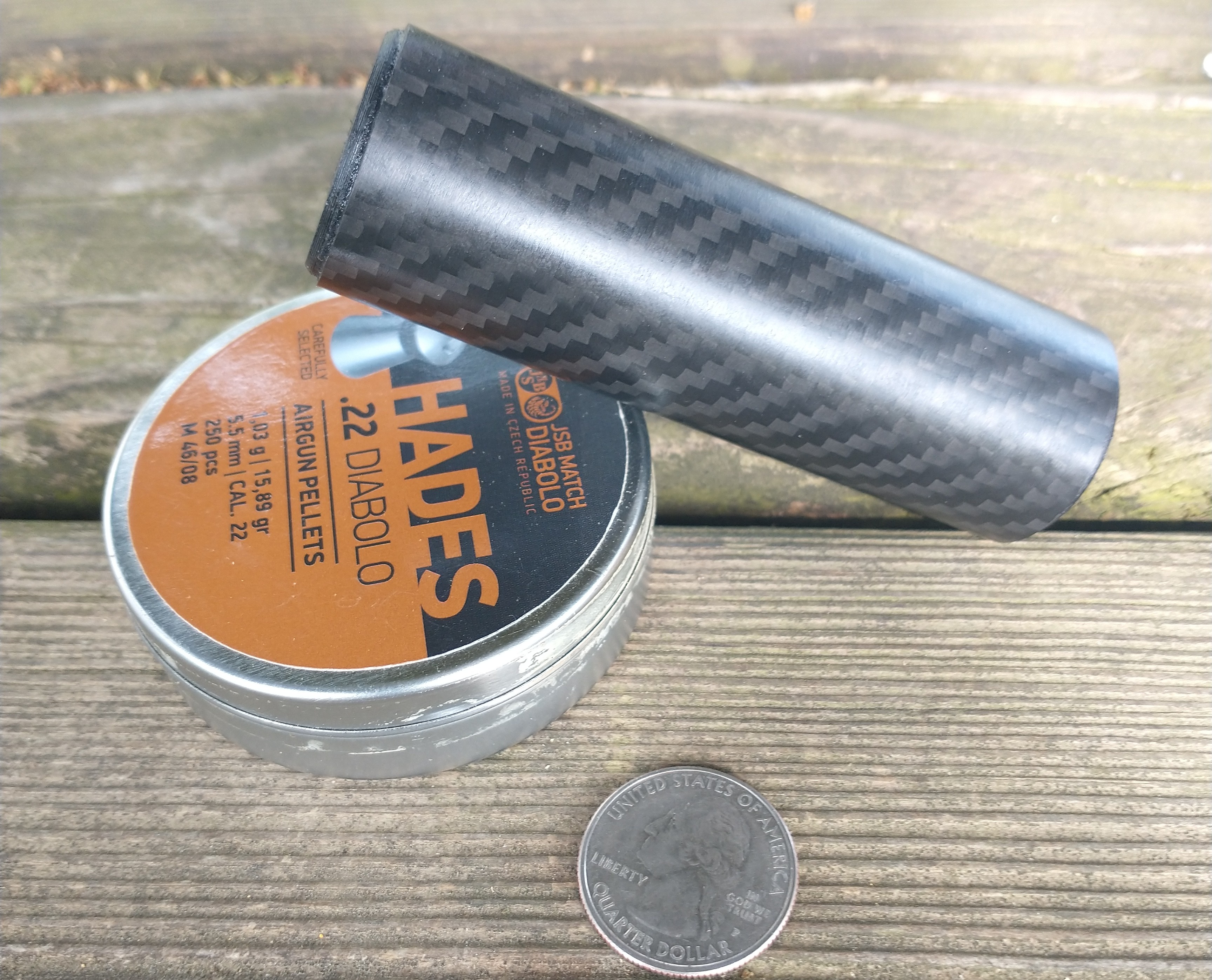

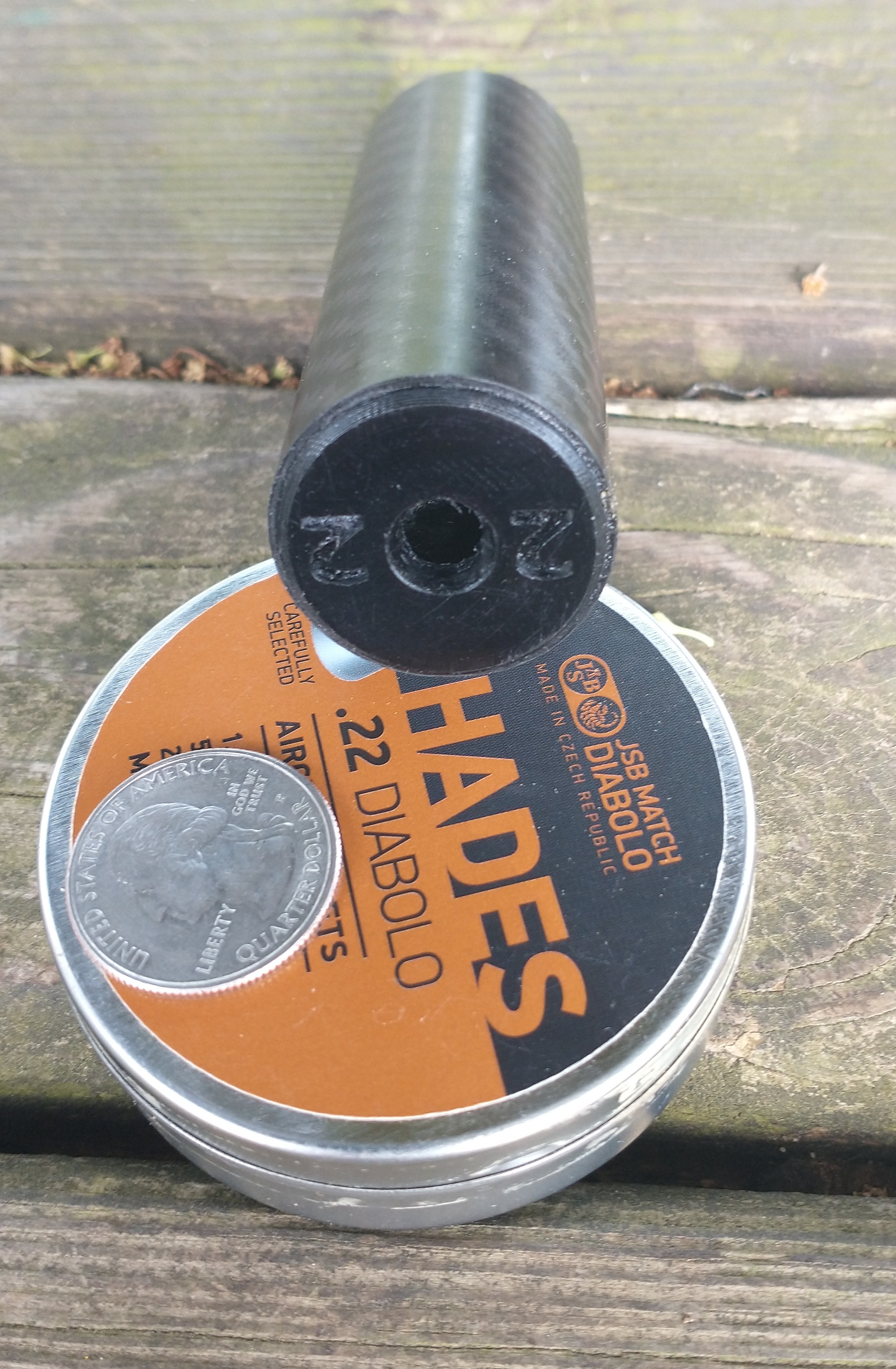

I've pulled the rear sight and am making parts for the gun on the printer this evening. I'm going to build a moderator specifically for this rifle. Since the gun is already long and not really hard to tone down I am going to keep the moderator very short. It will have to mount up on the rifle in front of the sight without blocking it. A nice replacement barrel band will be coming off the printer tonight or tomorrow. It will not have a front sight post but will otherwise be identical to the stock one.

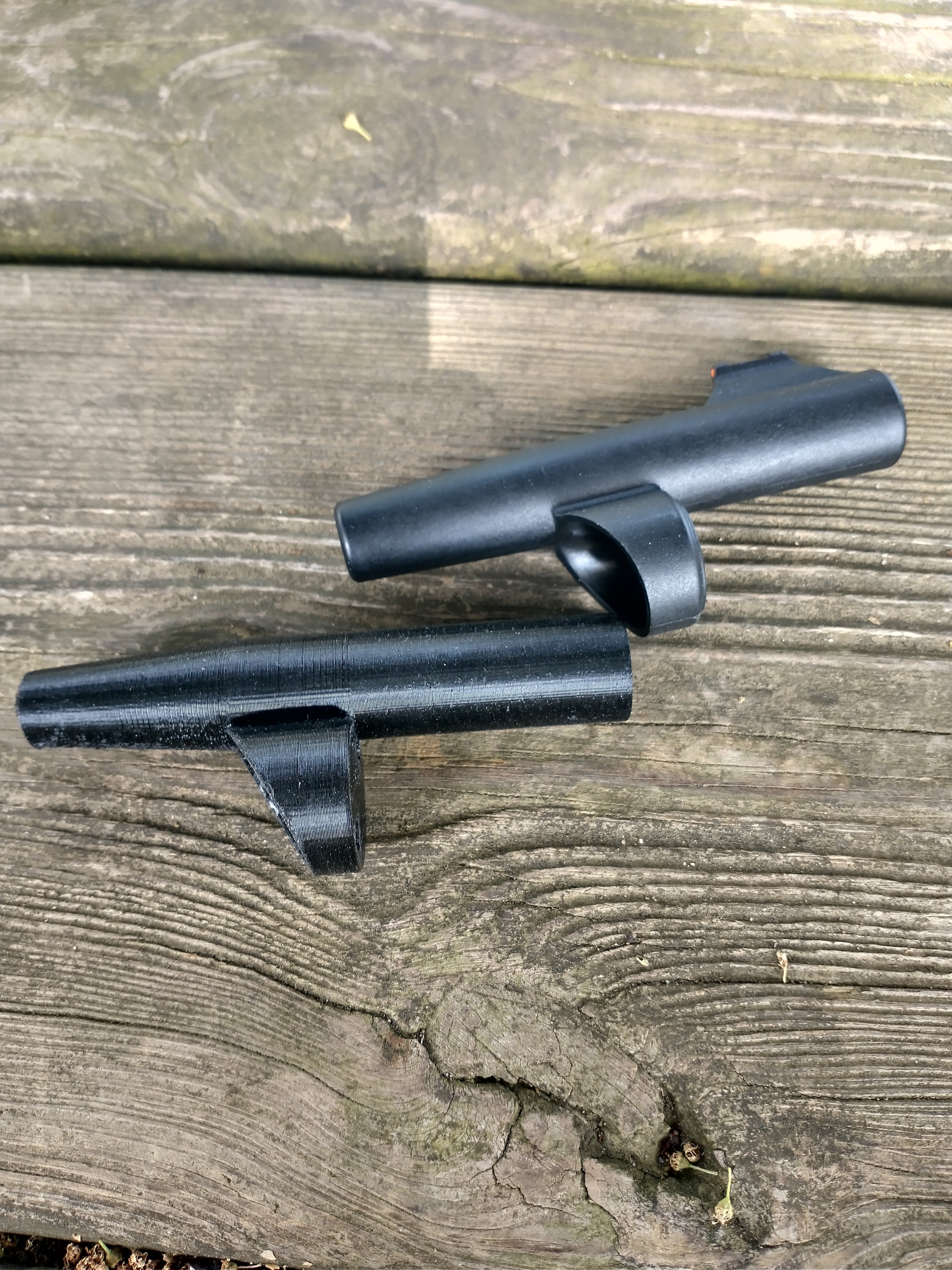

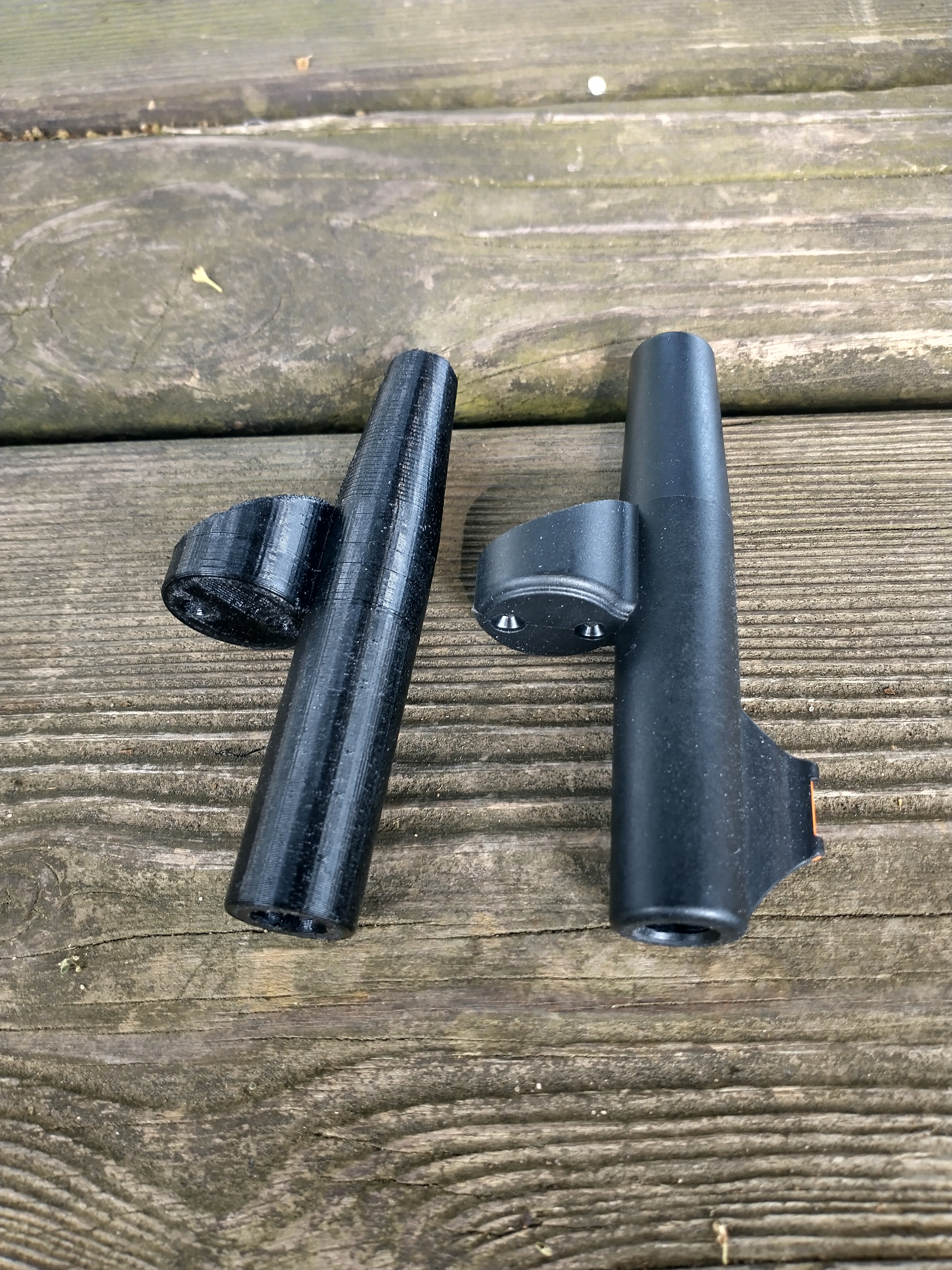

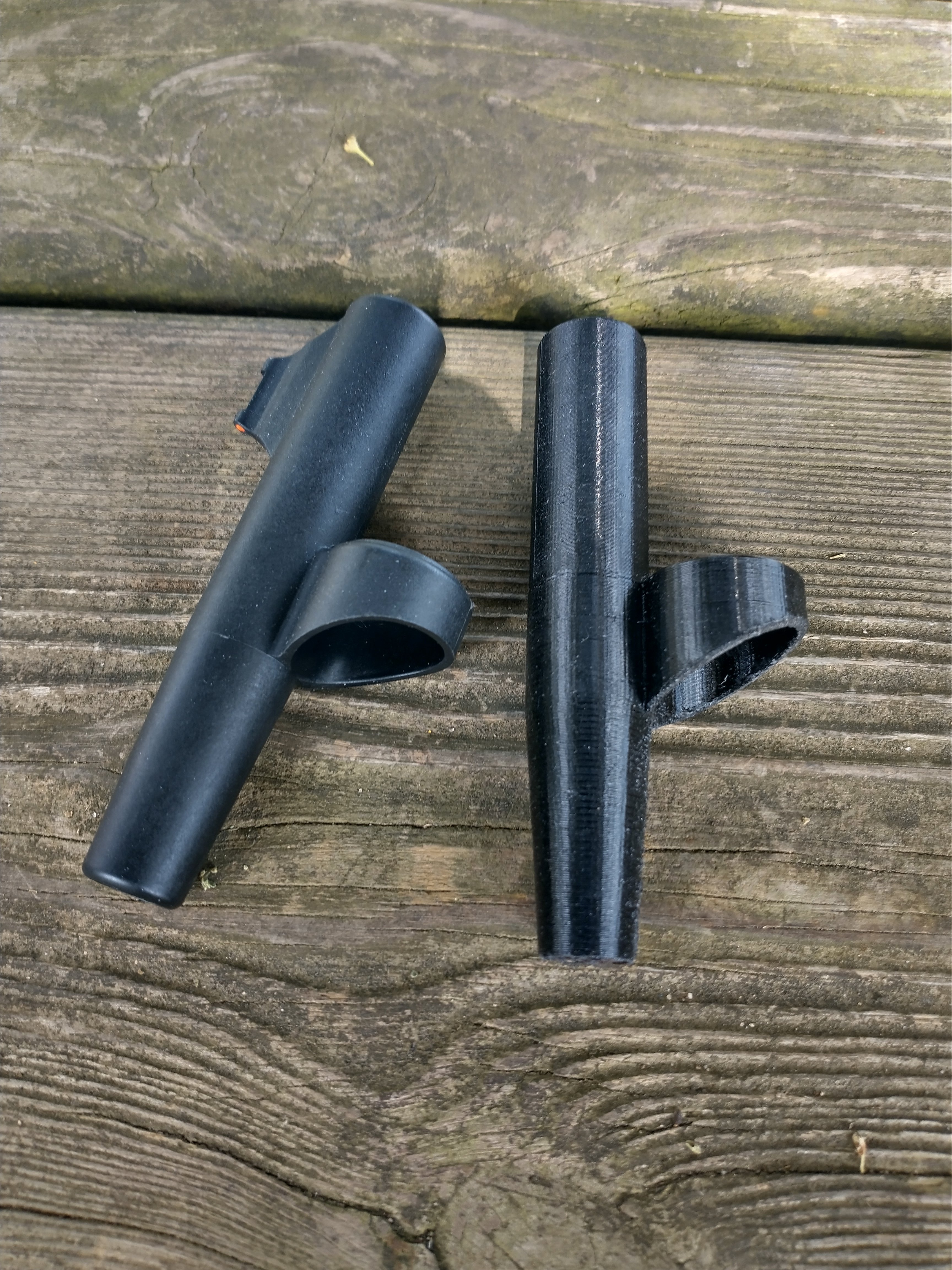

The draft of the front barrel band came off the printer this morning and it fits with a little sanding. I'll refine that drawing sometime today. I have to go check some groundhog traps at an orchard for a friend.

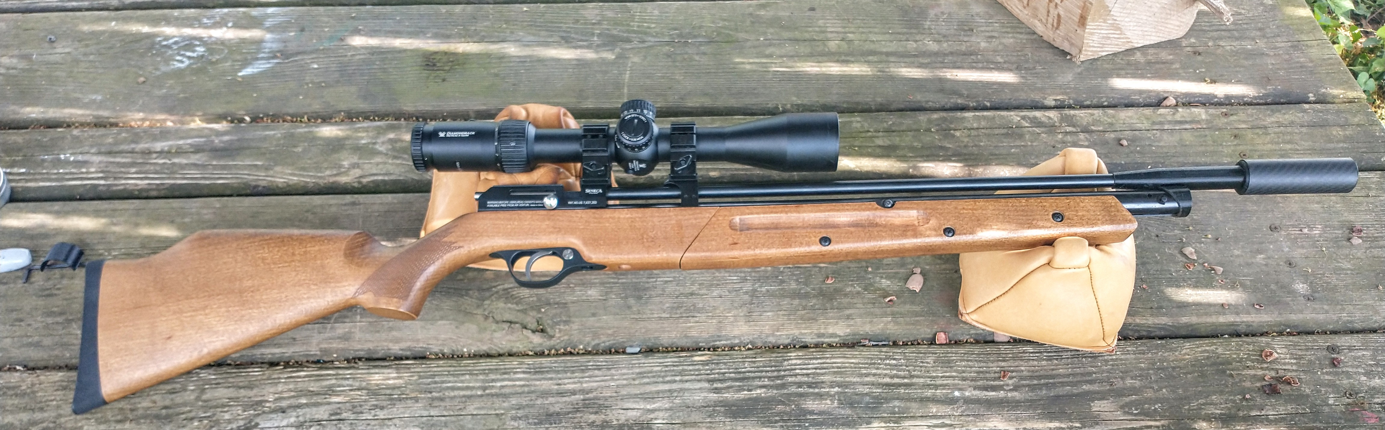

More optic than needed but the gun can deliver the accuracy this glass wants.
In this configuration it puts me in mind of an XM21 but at about 4 pounds less weight.
Shot at 30 yards in a light breeze. The rifle can out shoot me.
Roughed out these parts for this specific rifle. Should have them coming off the printer perfect in the next couple of days.
The moderator has three baffles and a stripper section. At five pumps, which you will remember is almost 600 fps you can hear the hammer bounce.
