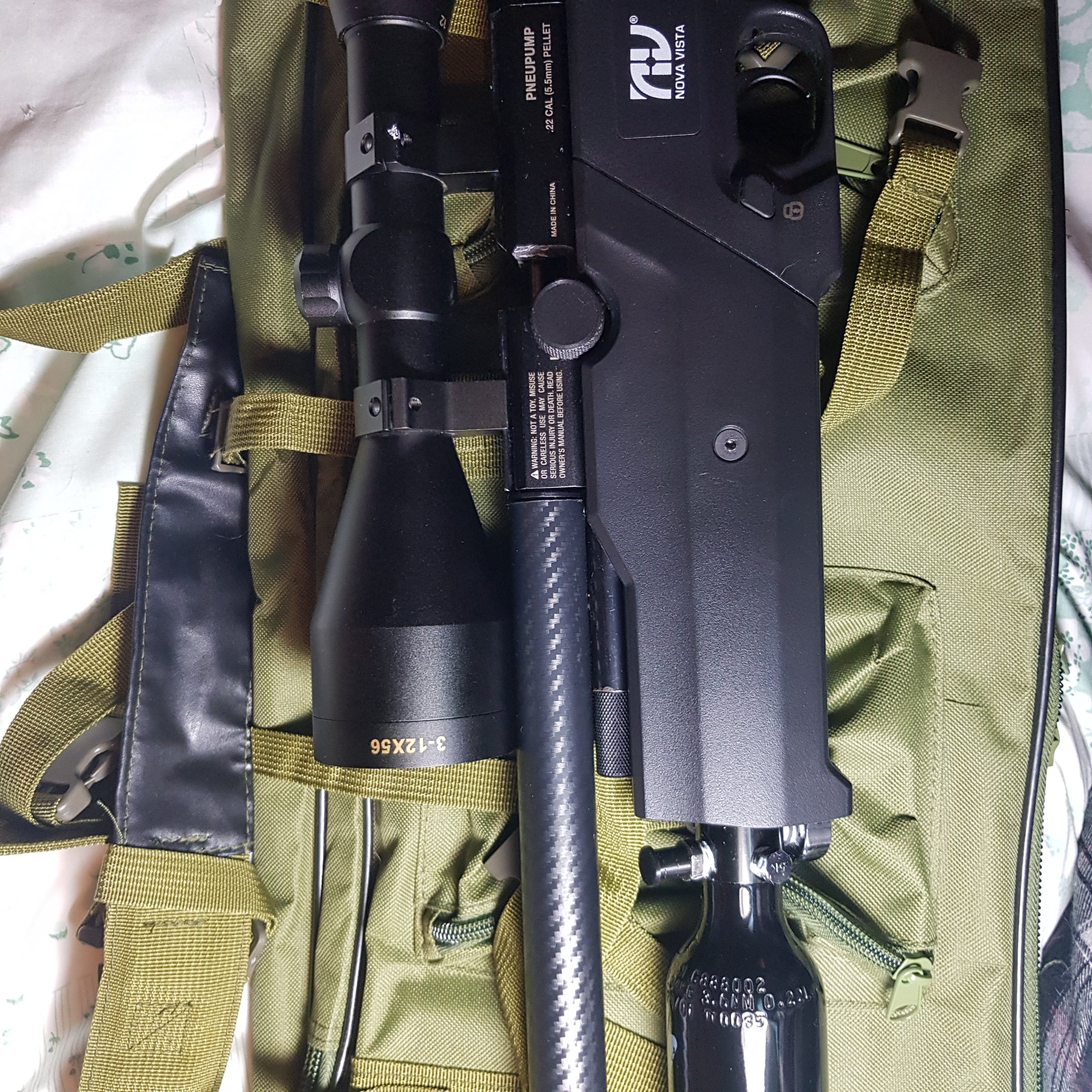

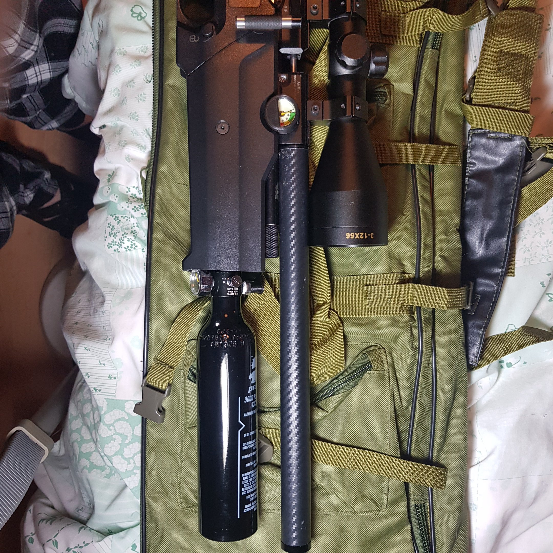

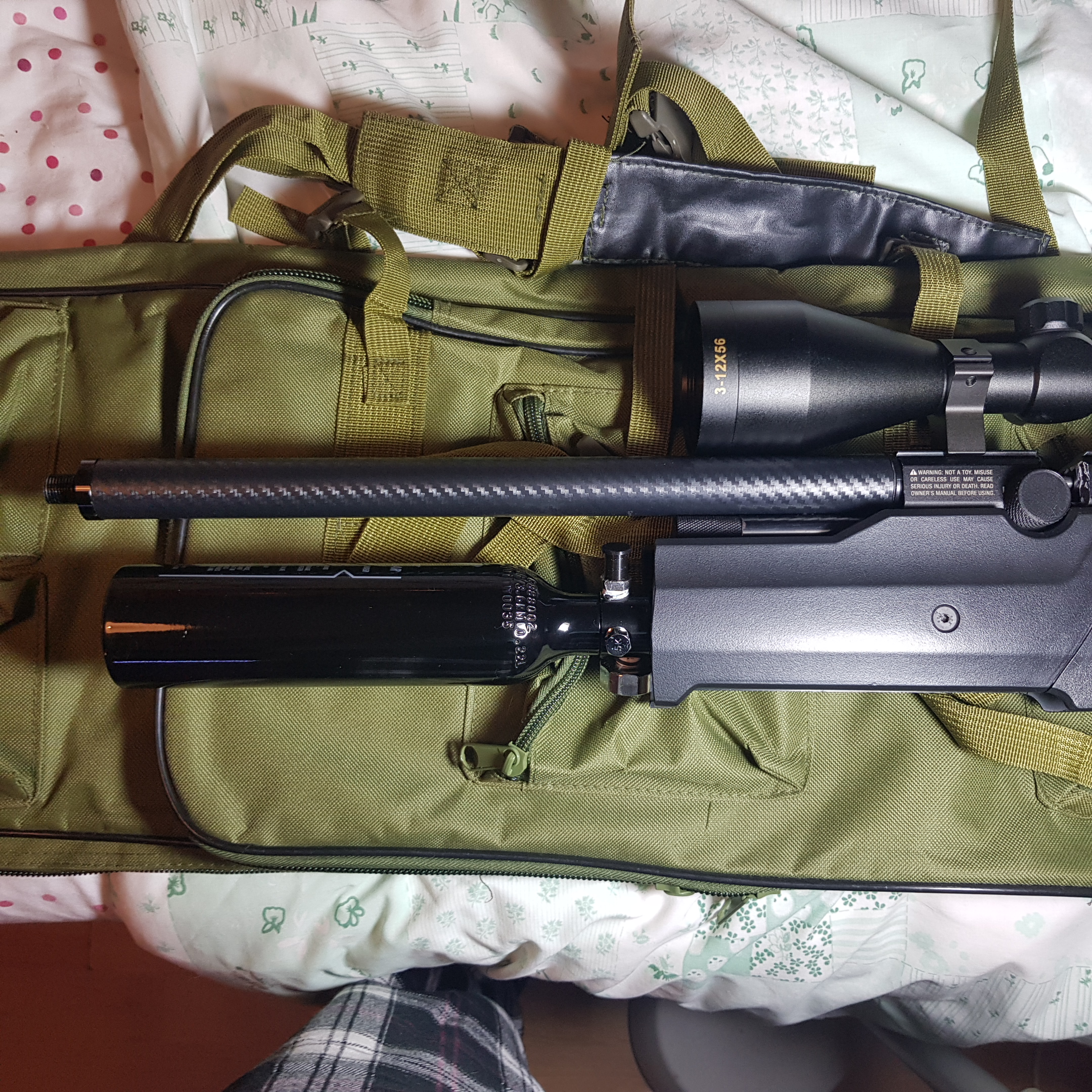

The actual pump thread I'm sure is m14
The skinny air tube is held by a pin next to the air gauge.
The skinny air tube I have cut down too 4" as this retains the valve spring in place"
I then had an adapter made from the m14 thread in the block which also holds the plate closed inside the block that the pump usually does.
Then fitted a drop block to the adapter
And blanked off probe hole.
The adapter needs making on a lathe which isn't too hard to do.
The rest can be done with a tap and die set and a few tools.
The gun is much better regulated
I should imagine the doux silencers pump part fits the aspen but not the air tube blanking plug" but not 100%
