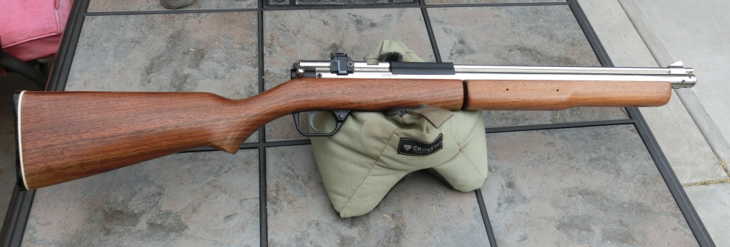

If it's a C9A like this one, with a removable valve, no special tools are needed and they are simple to rebuild. Driving out the roll pin's would be the hardest part and if you have a punch and a hammer, it's no problem, if not get a set at Harbor Freight. Really it's easy, watch a youtube vid about it. This is one of my C9A's, they are much fun!
.... hey , lessismorr , if your pumper looks that shape and model above (gun color doesnt matter) , i can teach you how over the phone - that's why i left my phone number for you in my reply. green terror is right , the rifles crosman produced as benjis and dans after they acquired the benjamin, sheridan, sterling company in the early 1990's are easier to dissemble. many times i have to just order a new valve body from crosman for these , tho. it's a trip because they dont make those valves until you order them - or something weird like that. that gun is still in production - they should have lots of those big brass valves handy. most of the time i install a new valve stem for a benji disco as i rebuild those - shoots harder. contact me , lessismorr , maybe i can walk you thru replacing the pump cup ($2 part from crosman) and that'll suffice for now. - rane on (all the witch-hunters).
I apologize for not getting back to my post, life throws stuff at you here and there ya know? Yes my rifle looks a lot like the picture posted, just not as shiny. I got a seal kit for my pump master so I figure if I can get that back in working condition then I will take a shot at the Sheridan. And thankyou Rane I will like any help on the phone since it looks a lot more precision sort than the 760 does
