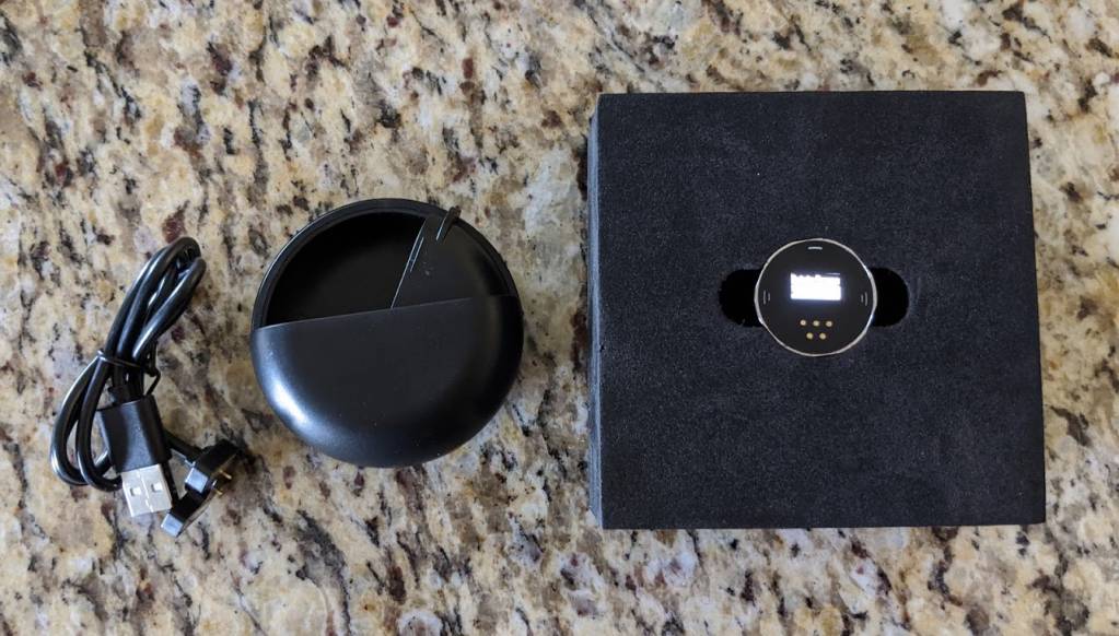

So, here is how they're shipped. The gauge is nested in nice thick padding.
With the other side offering a pocket for the recharging cord and a little compartment with some single-use lens cleaning packets. (Didn't count them but I'm guessing there's at least 5 in there, maybe more).
In the above pics you can also see the included charge cable plastic storage case. It's got a cool little retracting lid that should aid in keeping it dust and lint free until it needs used (which at this point, I'm thinking won't be very often).

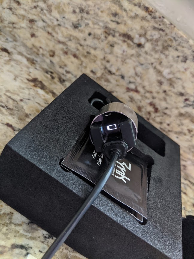

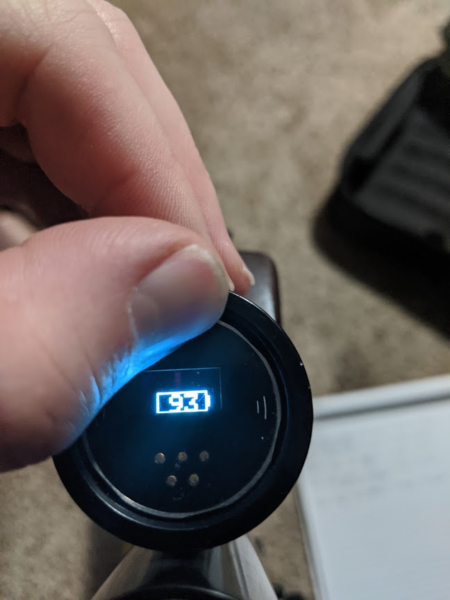

So I decided to charge up the production version that came last week before I install it in a gun. I grabbed a few pics of the screen as it charged. Charging graphics are very similar to most electronics today, slowly filling up as it charges and then showing as full-bars when done. It flashes to "100%" when it is done. I didn't time it, but it seemed like less than an hour for it to go from 54% (where it was when I received it) to a full 100%.

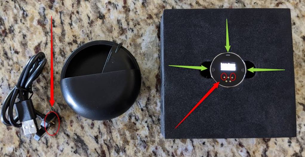

As for HOW it charges, it can be left in the gun for charging. I circled the two charging pins on the cord and on their female counterparts on the face of the gauge in red. Those pins need to mate up for it to charge.
My best guess is that the extra female connection points are for factory programming. They are unused by the charger.
A few months ago, when I was inspecting how this works, I was initially afraid those pins were going to scratch the living daylights out of the face of the gauge. I quickly realized that the pins retract when even the slightest pressure is applied. That seems to keep the pins from scratching the faceplate as they find their way to the females. There is also a rather powerful magnetic assist to hold the head of the charging cable in place.
I also pointed out the three buttons on the face of the screen in the above picture (green arrows). Those buttons don't have haptic feedback or depress, but are like touchscreen "buttons" on a modern cell phone.

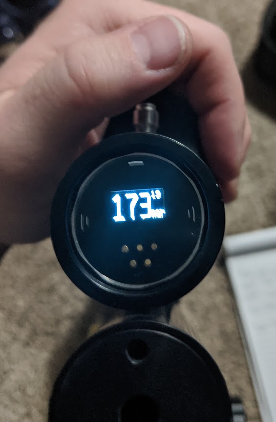

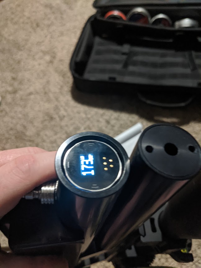

Here are some pics of the beta version from a few months ago, installed in my Shorty.
The display is flippable, by 180 degrees. I flipped mine to orient it correctly to not be upside down when loooked at it from a normal shooting position.
The install on the Veteran was extremely straight-forward. Remove the set screw holding the rotating fill port hole cover and slide the cover off, remove old gauge, steal the oring from it for the new gauge, and gently tighten down the electronic guage, then replace the fill port cover. Haven't had any leaks or issues. I actually did this out in the woods it was so easy.
As for aesthetics, it looks like the gauge was made for the gun, perfect fit and the black face plate matches the coloring of the anodized portions of the Veteran perfectly, down to the gloss level. Just a good looking combo.
When the gun is being filled the gauge acts just like the electronic gauge on a Red Wolf, even down to the fact that it slowly ticks down a few bar as the fresh fill cools off, just like a RW electronic screen.
Pretty sweet little addition to a gun. I was sold in the first few weeks when I saw how long that battery can go between charges. Even the beta version of the gauge gives so much more info, and accurately, than the analog gauge that it just isn't even a comparison. It's like going from a wind-up alarm clock to a smartphone.
