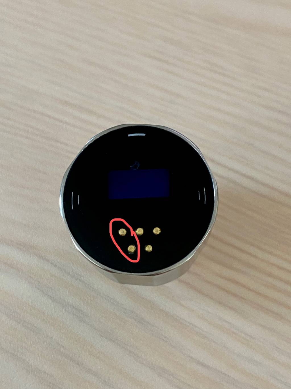

Thank you for sharing. My gauge doesn't even light up when charging. Last time it showed pressure was last Wednesday and the battery was full.

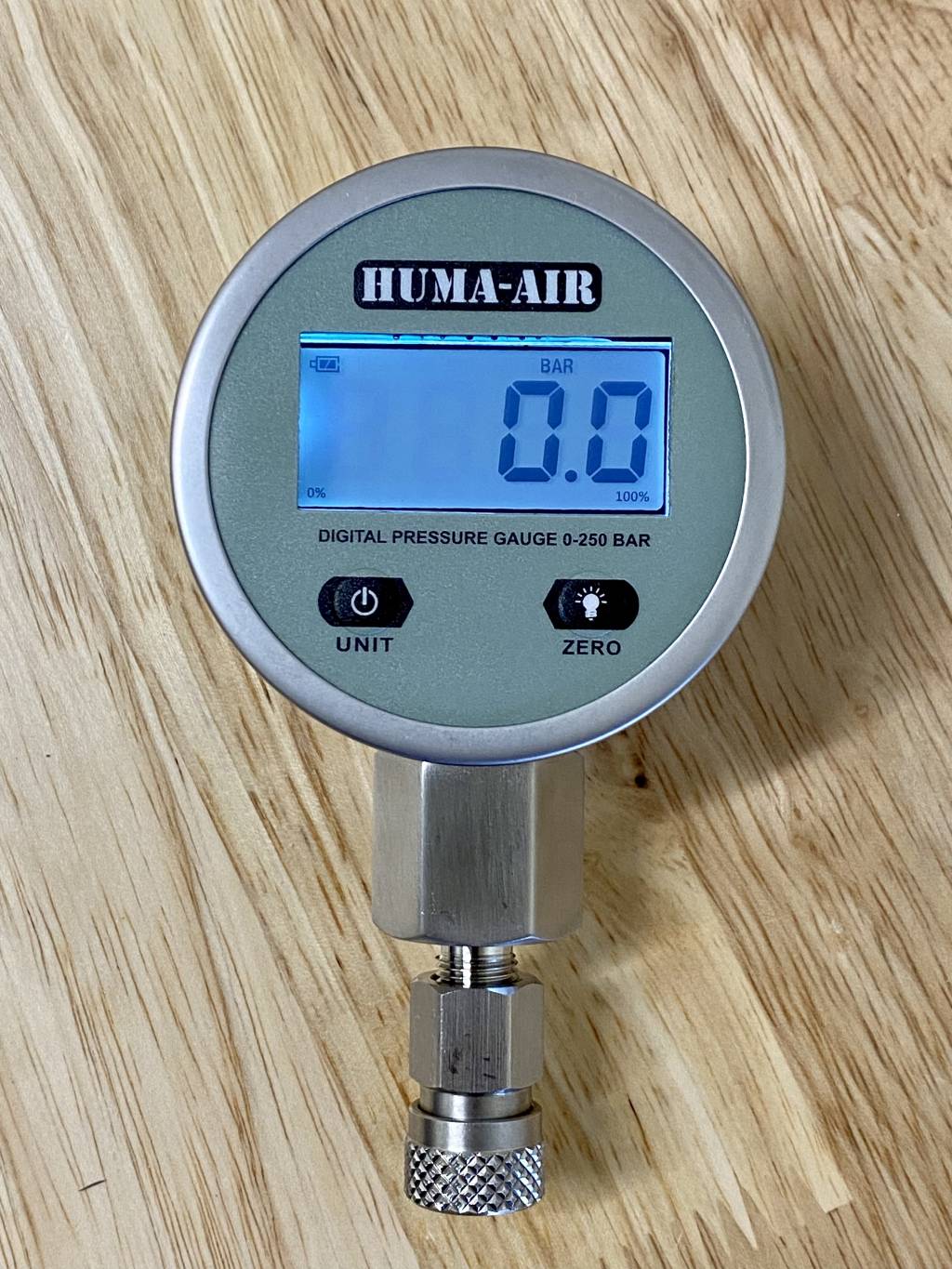

SEKHMET digital gauges are multifunctional when they work properly. Hoping someone from them will response my emails. I compared it with my bigger Huma digital gauge. Just 1 or 2 bar difference between them although I don't know the precision of my Huma gauge is 0.4% or 1%. I also ordered another max 400bar digital gauge which is 0.2% precision since Huma is only max 250bar.
There’s a hard reset by touching two of the contacts at the same time. I had that same problem with one of the gauges I was beta testing a long time ago and it solved the problem. Hopefully they’ll contact you and tell you how to do it. It was so long ago, I don’t remember which two contacts need to be touched at the same time. Their customer service is top notch h, they’ll get it straightened out. Good luck.

Thank you Stoti. Yes, I tried the reset way as user guide, but didn't work.

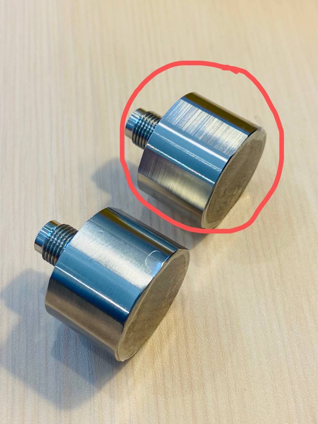

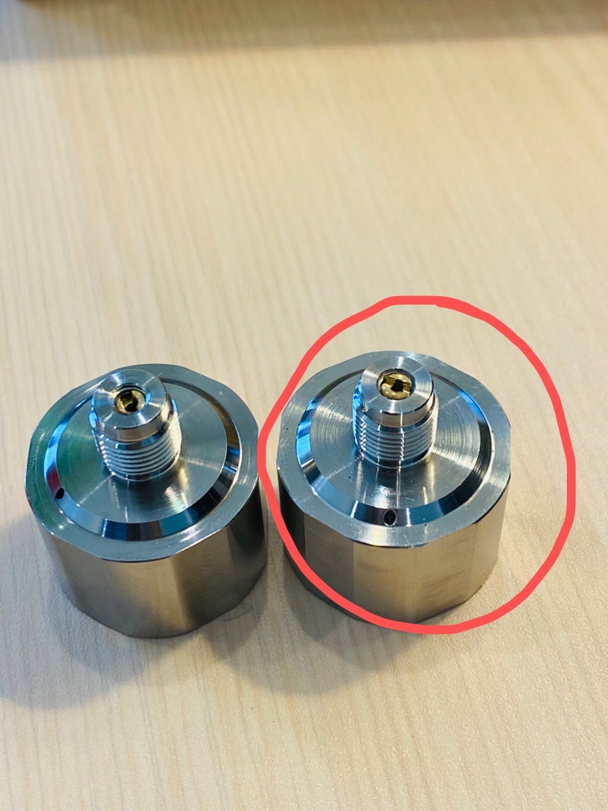

I actually received two gauge with different finish. One stainless shell is very smooth with all round edges. Another one is very rough like the brushed stainless with sharp edges. I requested to replace the rough one with smooth finish. Got replying that the smooth finish gauge is old version and not available anymore. Now the smooth one died only three days after installation, so I don't know if I'm lucky or not...
