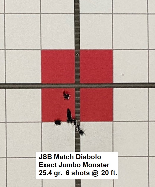

Anyway, about my Walther Talon Magnum in .22. It's an awesome gun, but I couldn't hit the side of a barn with it if I were locked inside with a case of pellets. I've tried open sights and a variety of scopes, several different brands and weights of pellets, but it's all over the place. I sent an email to Umarex about it, but never have heard back.

Thanks, all. I tried the artillery hold, but only for a few shots. I'll try just resting the rifle on a bag and not against my shoulder. I'll look into adjusting that Quattro trigger.
Yep, Hatsan made these rifles. I've done some reading on them, and QC does seem to be spotty. Some shooters had rifles that were dead-on, shot after shot, but others said that their rifle was wild as a March hare.
I checked all the screws - they're tight. The pivot pin is nice and tight also, so I don't think that's a problem. I haven't cleaned the barrel yet, so I'll do that. I've chrono'ed it and the velocity is pretty consistent.
Pellets - I've tried RWS Meisterkugeln and Super H Point, H&N Barracuda Match, JSB Exact Jumbo Monster, Predator Polymag, Crosman PowerShot Red Flight, Gamo Rocket, Benjamin Discovery and even Gamo round balls. None of them seemed to be any more accurate than any other.
I mostly just shoot soft drink cans in my back yard (with a pellet trap behind them) and I don't have a problem with tree rats, but I would love to be able to "one hole" the "O" in "Coke"!
