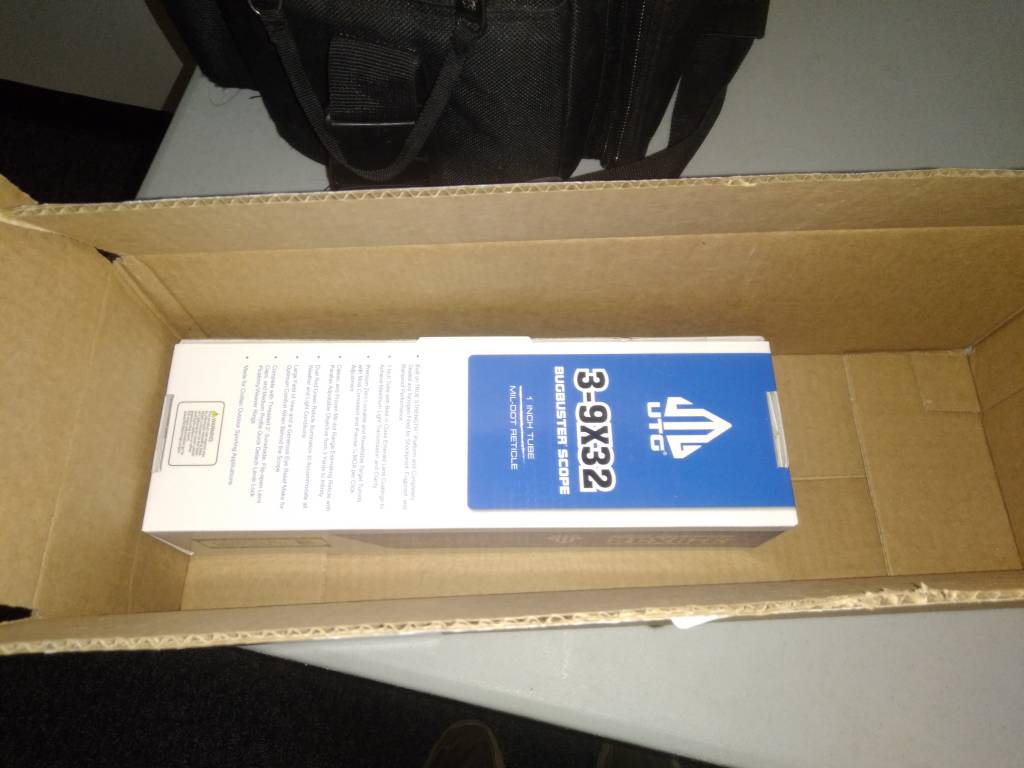

I see a lot of endorsements for the Bug Buster used in conjunction with springers. Today I read a post today from a member claiming that his RWS 34 killed two Bug Busters. It is pretty detailed. Any members have a similar experience with their Bug Buster after using it on springer over a significant amount of time? Here’s the link

I have had horrible luck with UTG/Bugbuster scopes. I would recommend a Hawke Vantage. Very good entry level lineup with a very good warranty.
Airmax not vantage. Airmax is for springers vantage is for pcp and pump airguns. I've used a cheap as in unbranded bunbled with a PCP scope on my d48 in.177. they're a known scope killer but mine are mounted in a ZR mount and no problem with scopes dieing. There's also a mount called a damprin (?) Mount that's suppose to do the same thing but have no experience with it.
