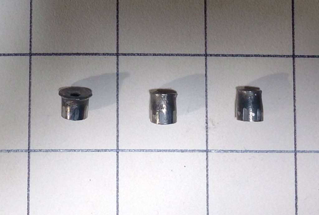

Not every slug performs as nice and neat when penetrating game as it does when going into a block of Clear Ballistics 20% gel, or a milk jug filled with water for that matter. Here are some slow speed expansion results to check out. These were shot at typical speeds of slugs and pellets as they would be reaching game at 100 yards. The slugs are lubed Varmint Knocker slugs in .30 caliber, 50 grains, shot into Clear Ballistics 20% gel block.
Results from left to right:
875 FPS, 0.375" expansion, 7.5" penetration
750 FPS, 0.300" expansion, 7" penetration
725 FPS, 0.275" expansion, 6.5" penetration
Not shown is a JSB 50 grain pellet hitting at 875 FP, 0.000" expansion, with 8.5" penetration.

@Castin’Catchin’ 26 at these speeds and within normal hunting ranges, the JSB Hades in .30 caliber will do more internal damage and penetrate a touch further than the hollow point based on it's design. For pesting birds and small critters, the Hybrid/deep hollow pointed slug is the ticket with it's expansion and huge initial energy dump.
