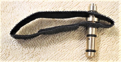

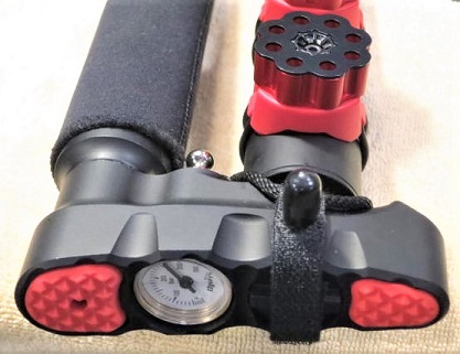

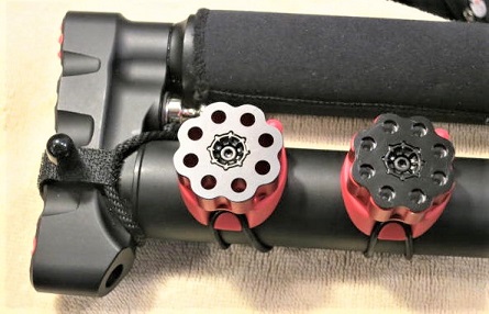

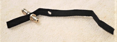

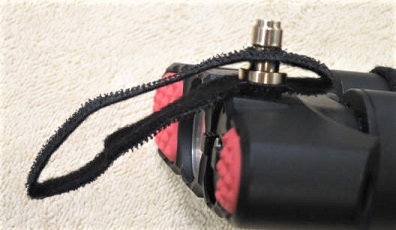

Here's one simple way to do it, it took me about an hour once I had the dimensions worked out correctly. The attached pictures explain it better than the text does. I used a thin piece of 1/2” wide nylon strap 8 inches long – the kind of strap with Velcro on either side which is often looped around a bundle of wires to keep them together. And a piece of thin black elastic cord, or just black string, to secure the strap to the stock.

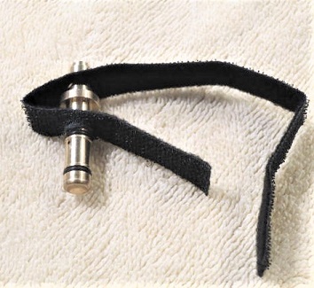

Carefully cut 2 small holes in the strap to accept the stem of the probe, one one at 2 inches from one end of the strap, and the other hole 3.5 inches from end of strap (1.5 inches from the first one hole. Both holes should be smaller than the probe stem because the strap needs to fit the probe very tightly when pushed through the holes.
Press the base of the fill probe through the first hole
and then loop the end of the strap back up over the top of the probe and push the Foster end of the probe up through the second hole
Then finish the loop as shown in the 3rd picture. Using the Velcro strap makes this very easy and I already had a piece of it. But you could use any very thin strong black nylon strap which can be made into a closed loop like this by sewing etc.

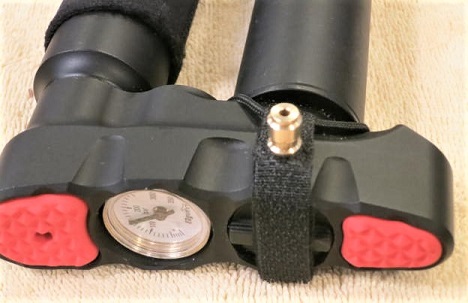

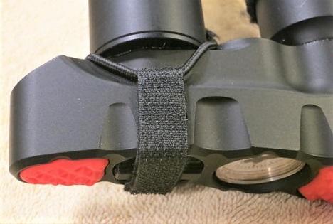

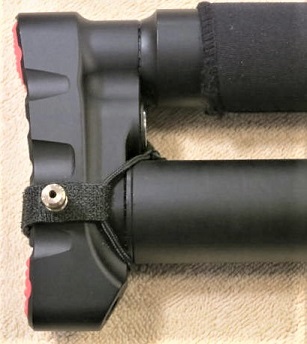

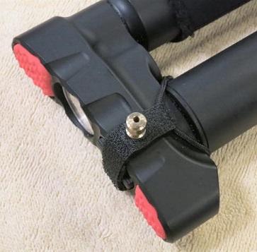

Inserted into the stock
I also found a piece of elastic string to use for securing the strap to the stock as shown in the pictures. That worked better than regular string because of the constant tension. The probe can be easily removed at any time by cutting the string.
This Mod works well, it's small and inexpensive and isn't very noticeable, especially with spare magazines mounted . It's tight enough so that I can rotate the probe in place slowly with my fingers with a firm grip, but there is no in-or-out movement of the probe when I pull on it or when the compressor hose is attached and disconnected to the male Foster end of the probe.

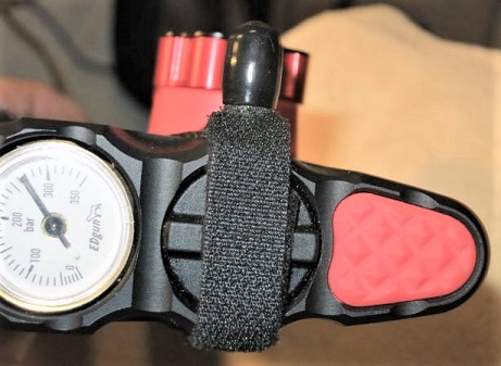

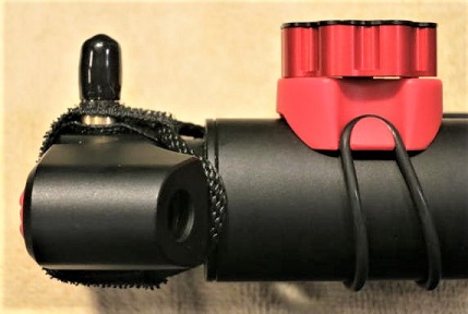

A few more pictures, this time with the protective cap on and using a black shoelace instead of elastic to secure the band. It also holds the probe very tightly in place.

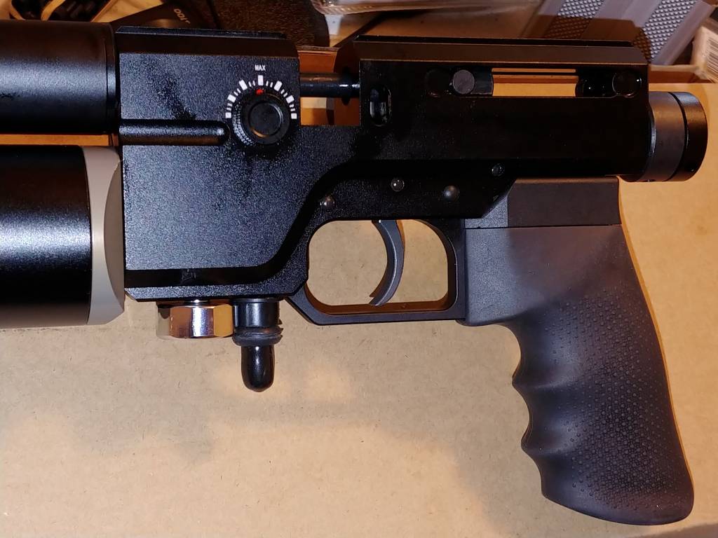

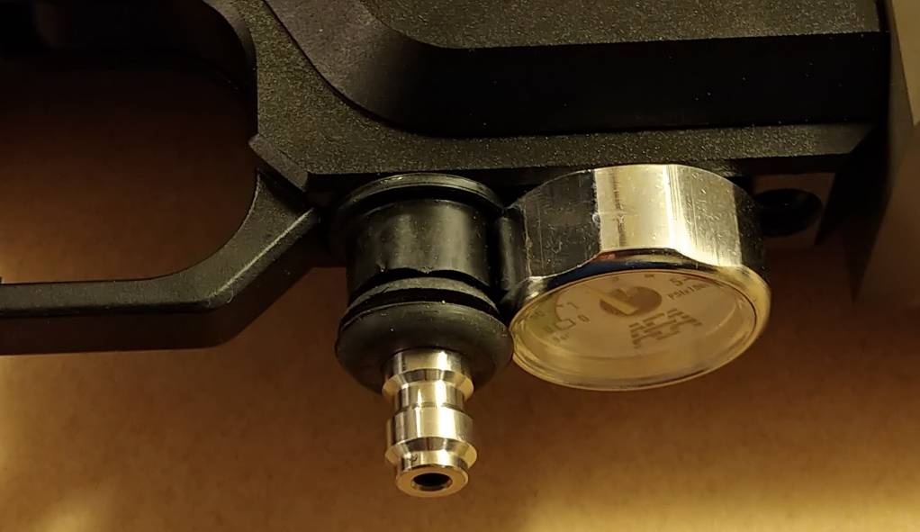

I recently mounted the fill probe semi-permanently in my new 8-shot semiauto ~48fpe AEA SS+ 30 cal. Before I received the SS+ I'd ordered a T shaped fitting so I could add both a Foster fill nipple and a pressure gauge in the original pressure gauge hole. But it stuck out too far and didn't look good.
The pressure gauge on the 30 cal SS+ is located under the gun and in front of the trigger guard and stands about 1/2 inch below the base of the stock. The fill probe stands about 1/8 inch from, and along one side of the pressure gauge. All it took was a rubber grommet (~1/4"x5/8") pressed down over the fill probe to securely squeeze it into the narrow space between the side of the pressure gauge and the fill probe. I could have used a little piece of double-sided tape between grommet and gauge but it wasn't necessary. The quick fill end of the probe now sits immediately between the pressure gauge and the front of the trigger guard so it doesn't get in the way of shooting and it looks like it belongs there.
