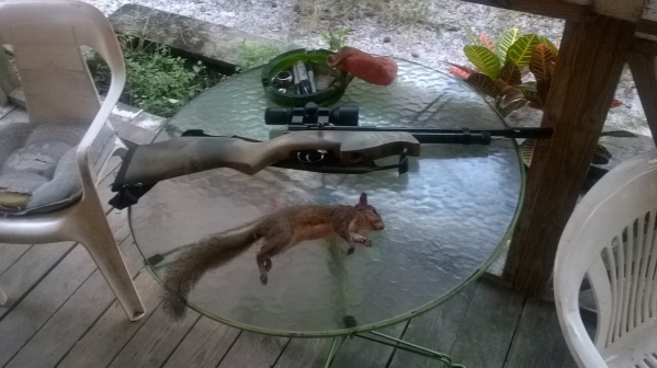

Second squirrel in 2 days with modified QB78
Second squirrel in 2 days with this gun it is a shortened and modified QB78 got a squirrel yesterday early and this one this morning at 31yds yesterday s was at 27yds.
Know to get more for the pot.
Grumpy
Hi Jeff it is a .22 cal. that I converted to pcp opened up the airvalve added a spring in airvalve so the co2 stricker could be removed it can still be used with co2 but the first one in can just be an empty the cap still has the puncture pin. I use a hand pump and pump to 1900 psi get 4 shots and takes 11 pumps to get back to 1900psi. If you have any other questions feel free to ask.
