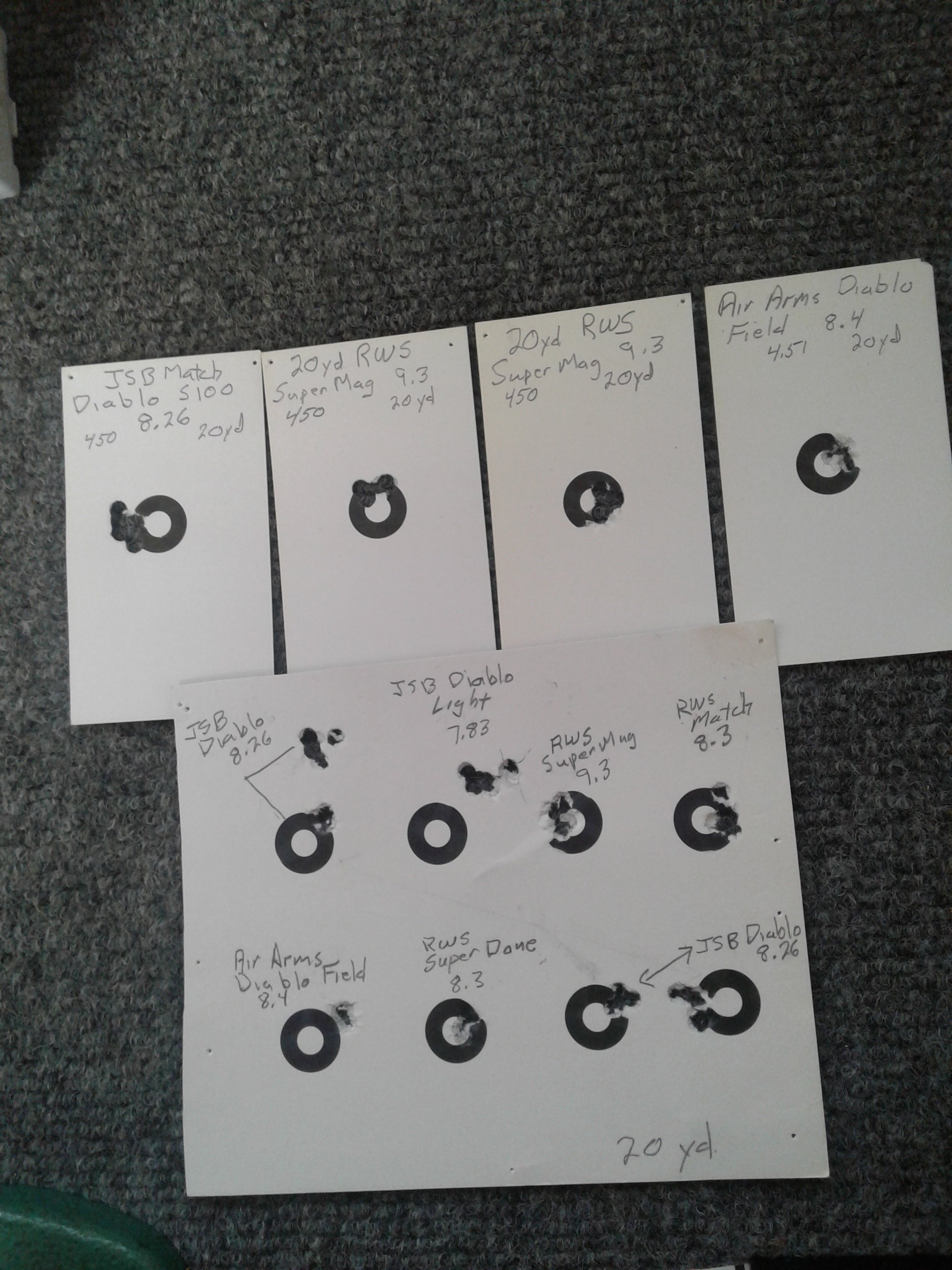

I have spent 3 days shooting flatface pellets required in a winter indoor springer bench rest league. The pics show the results. Teating was 20 yards indoors. No cleaning. You will see the AirArms and RWS Dome both not legal but shot for comparison far tighter. All groups are 5 shots. I love my TX200. No cleaning, no fouling shots.
I have spent 3 days shooting flatface pellets required in a winter indoor springer bench rest league. The pics show the results. Teating was 20 yards indoors. No cleaning. You will see the AirArms and RWS Dome both not legal but shot for comparison far tighter. All groups are 5 shots. I love my TX200. No cleaning, no fouling shots. View attachment 295411
I failed to mention the first day I eliminated quite a few pellets. Gun is tuned to 700 fps. In the flat face pellets this tune showed a dislike for lighter pellets in the 7 grain range. Last year tuned to 800fps it liked the lighter pellets.
