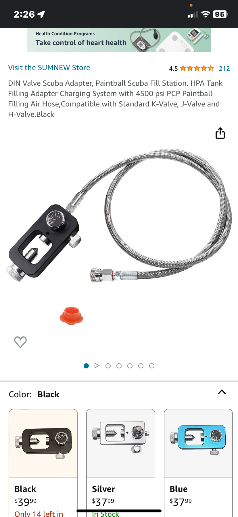

Do I need an adapter to change from what looks like a 3/4" NPT connector, or can I leave the DIN fitting in place and use the small 1/4" fitting on the side opposite the valve handle to connect my air line?
If I need an adapter to fit the DIN NPT, what brand is a good one to buy that has a whip and a quick-connect to work with my GX CS3 compressor whip?

i see some transfer valves that appear to replace the scuba valve, and ship with gauges, a whip transfer line and metering valve. Most cost $65 to $85, some in brass and some in steel. Only problem is I need to figure out the thread size of the cylinder, so I’ll call Divers Supply, assuming this style of transfer system is reliable.
