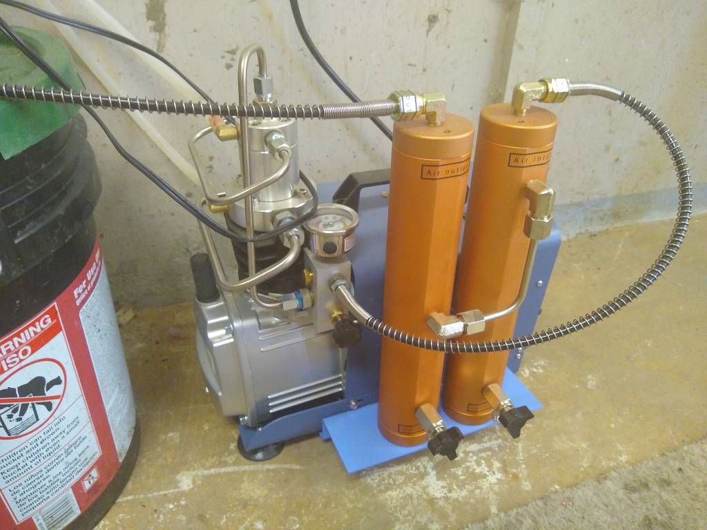

Have this filter set up on the yong heng
Think it was about $270 seems to work good
But obviously must maintain it
