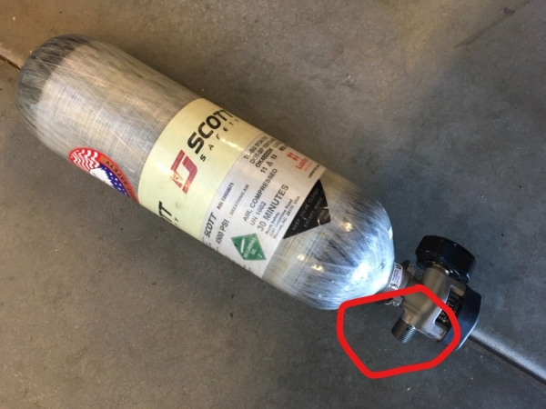

Does anyone know what size female fitting is needed to fit this thread? I have found a few of these fireman tanks on eBay and I am trying to source fittings for a fill setup.
