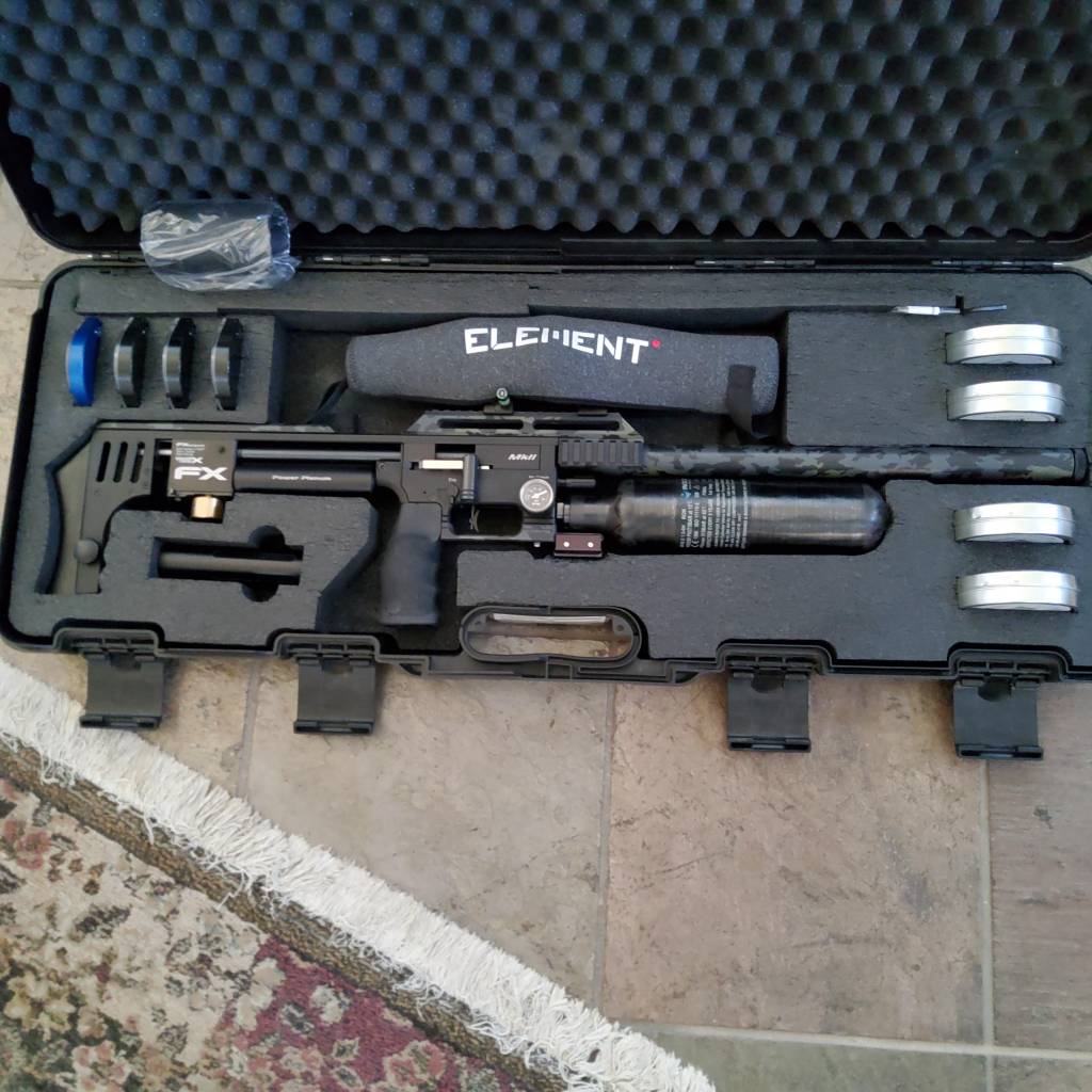

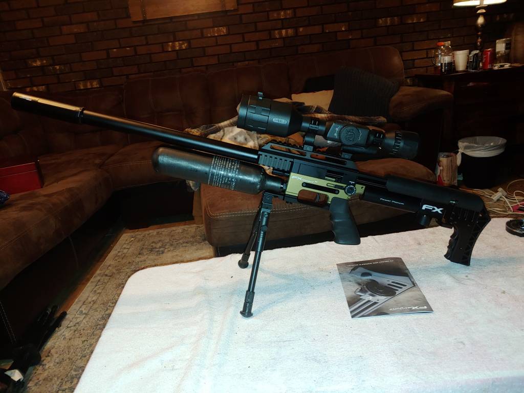

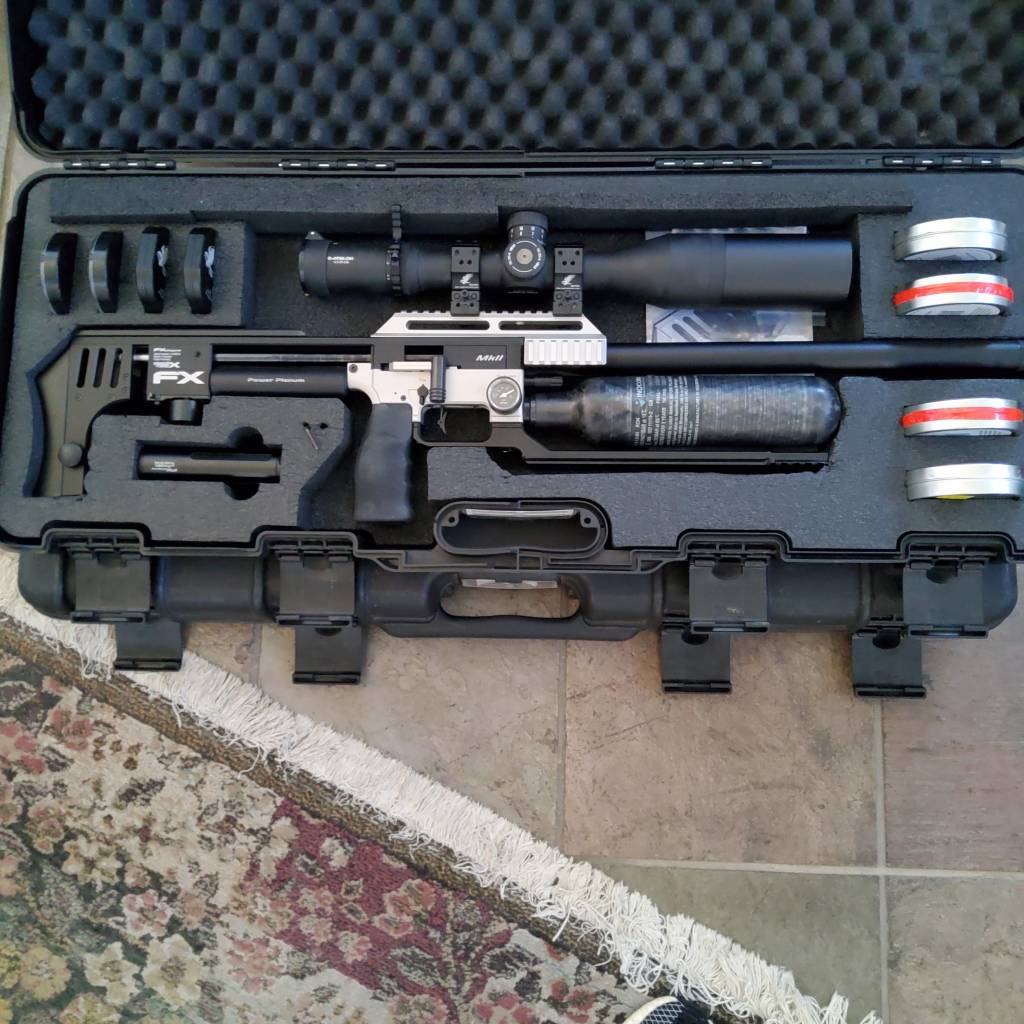

Well all after seeing all the slug hoopla I decided I wanted to get in on the action!!! Have many guns that do damn good with slugs but wanted to get a "small caliber" slug shooter and boy did I ever...
FX Impact MK2 .22 700mm Superior Heavy with the Matt Dubber slugger treatment....I wanted to keep the color stock so did not get the cerakote done but other than that she has the slug power kit, different hammer spring and valve spring etc.
Shoots the NSA 31.2 at 1010 FPS hole in hole!! On power 1 she slings the 25.39 Redesigns at 920 with the same accuracy.....
Went with a Huma reg just for peace of mind and couldn't be happier with how it came out....
70 FPE in .22 and whisper quiet (Huma 40/5 moderator).....
Reg is at 145 bar with the hammer spring about a turn and a bit out from max....
Sorry for the crappy pic but I am about as good of a photographer as I am a ballet dancer.....
Atlas bipod and Hawke Sidewinder 6-24x56 FFP scope on No Limit rings round her out.
