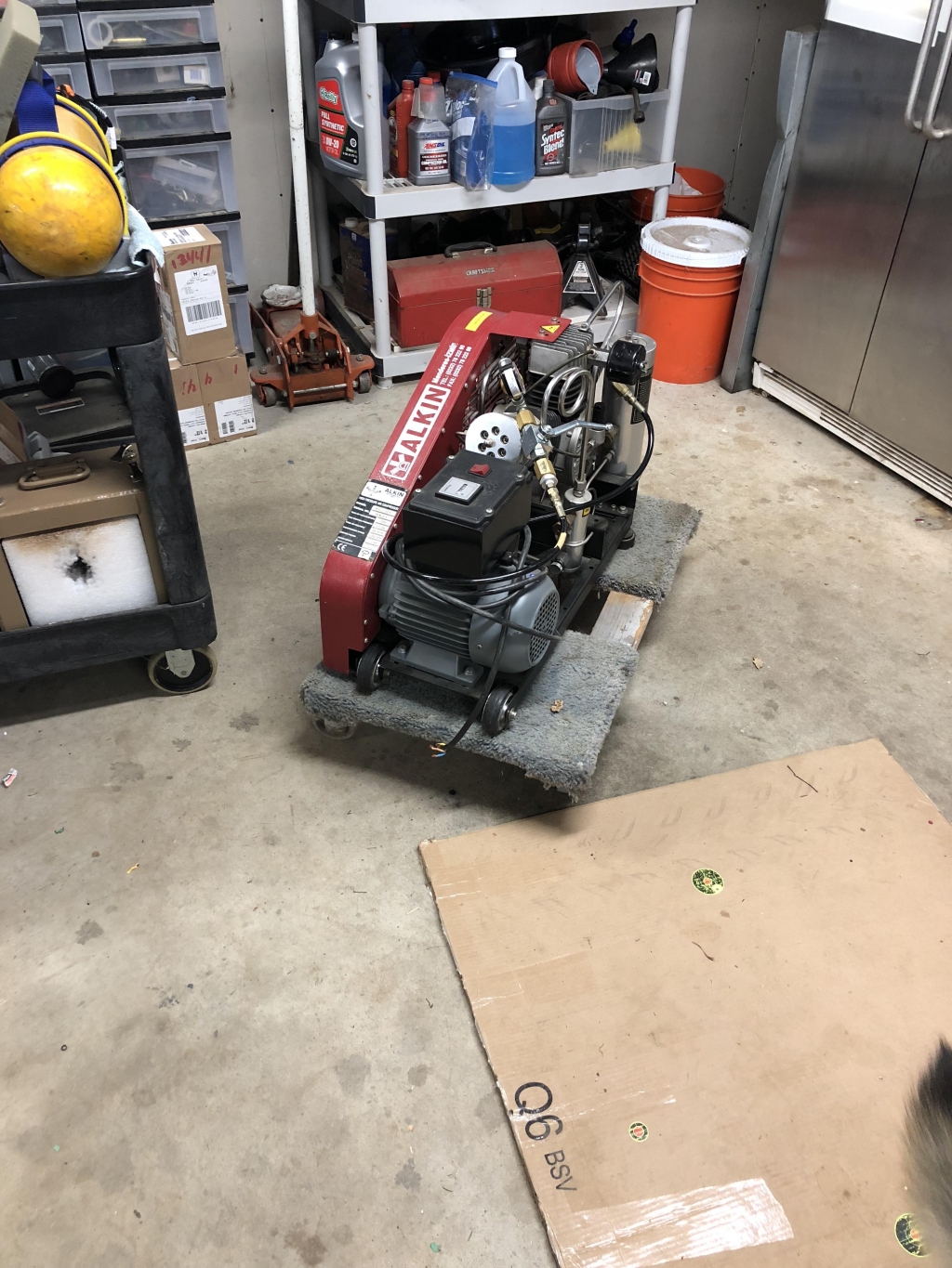

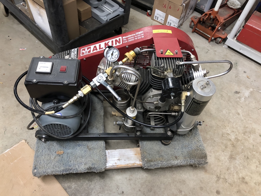

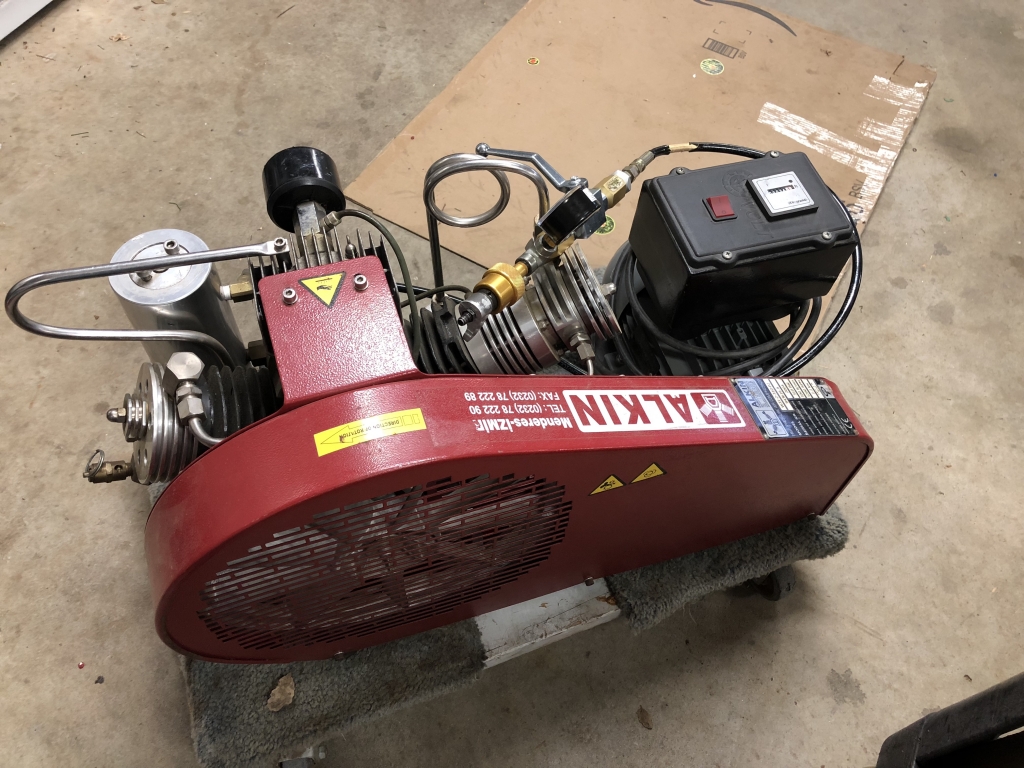

Will be back in business soon as I run the 220 circuit.
Parts for the Lightning compressor are in route, and after I rebuild the HPA cylinder to 100% my Lightning is going up for sale.
i wanted to say a big thanks to JKING for all his assistance this far on rebuilding of the Lightning-

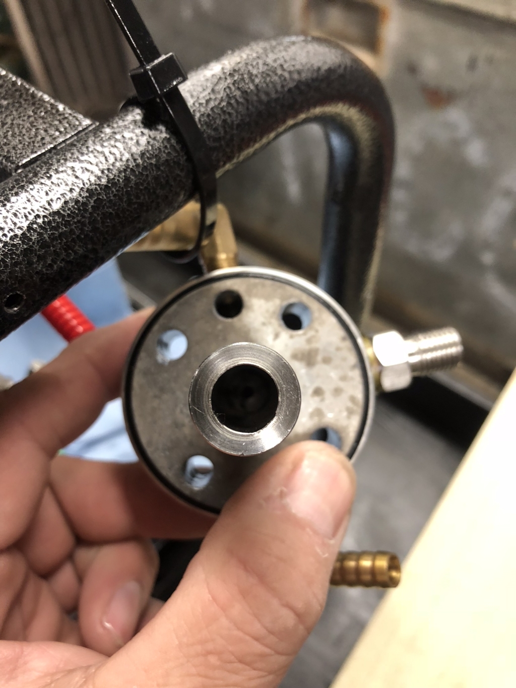

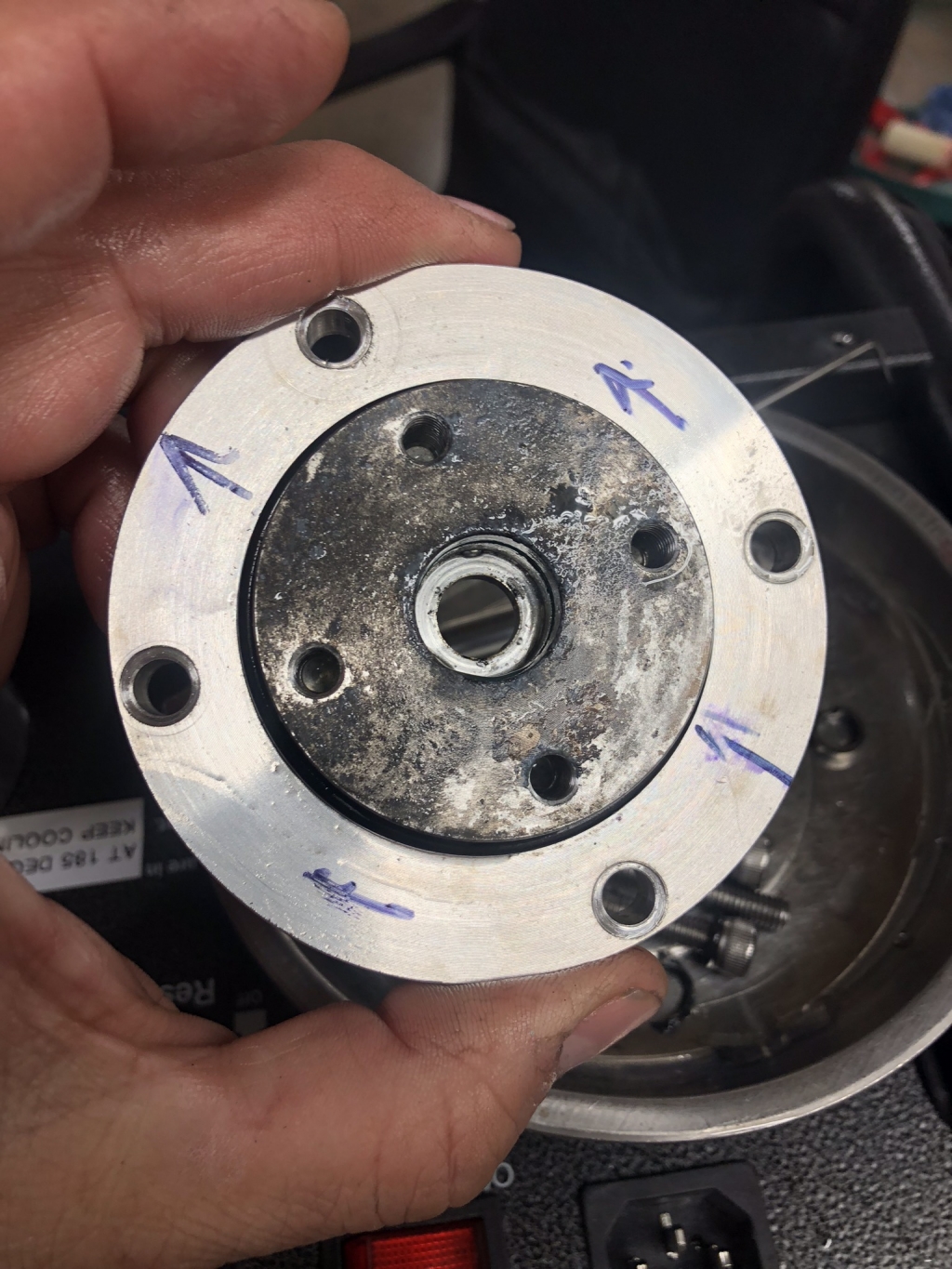

I replaced all piston rings, o rings, cleaned out check valves(two total, one at the high pressure output line at the top of the HPA cylinder, and one at the entry into the desiccant block your fill whip is attached to) and switched out the check valve springs, and still no movement of air pressure. The most it got up to and stopped was at 1000 psi, and that took 1/2 hour to get to.

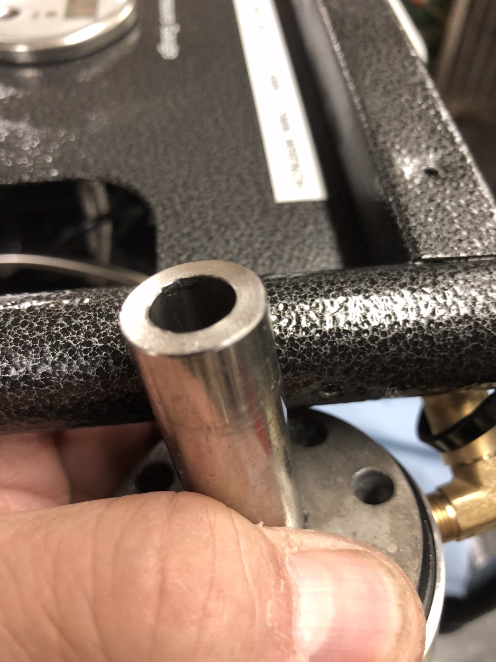

the upper cap of the HPA houses the water jacket, and when removed it has an internal shaft that the piston moves thru. I have a feeling the inside bore of that shaft has worn, causing not a tight seal with the piston rings.
So, along with a new seal kit, piston rings, I ordered the entire HPA cylinder, from the paper gasket up, thru tuxingcn.com. Total cost with shipping was $63.
1579478205_17925972725e24ecbd4d23f0.22576178_FE529C2B-4CD6-499D-B147-14CE496C7904.jpeg
1579478205_14200080795e24ecbdb14702.13772034_F0BC5142-5A62-494C-81CC-5FBE24863F80.jpeg

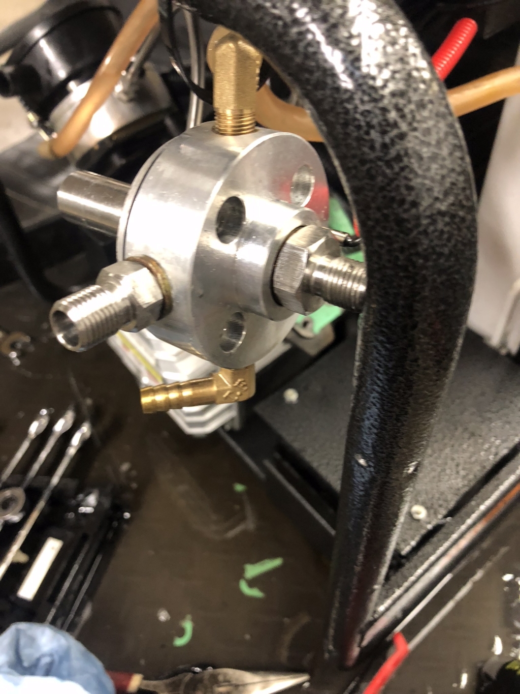

So, LLeon, basically all the shiny aluminum parts on the top of the HPA cylinder closest to the coolant fan can be bought as an entire assembly, already put together with now hard pressure line fittings, check valve, o rings, for $45. I picked up a fresh o ring kit and a pack of 10 piston rings to total up to the $63.
If you look really close at that shaft, you can see the edge of it all butchered up like a bad crown on your rifle.

It topped off my tank from 3400 to 4500 in 5 minutes. The guy I bought it from filled his tank, a 6.8 liter, from zero to 4500 in 20 minutes and so many seconds(showed me his phone timer).
what impressed me was at 4300 he thought the tank was full so he turned the switch off, saw that he had been mistaken, and re started the compressor, while the entire system was fully pressurized. It started without missing a beat, shaking, sputtering, none of that.
That move right there would have locked up my Lightning and or possibly blown some type of fuse. Not bagging on the Lightning for that, as I knew when I bought it it said in the instructions all air must be purged from system before a restart. But, ignorant me, I thought all HPA compressors were that way.

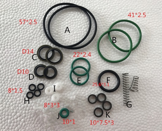

im going to post up the o ring sizes that Tuxing gave me, so if you want to order up o rings from the numerous o ring vendors you can use this to stock up on maintenance parts. Just keep in mind on the metric sizes called out, the first number given is the OUTSIDE DIAMETER and the second number is the CROSS SECTION THICKNESS of the o ring. I had to verify with Tuxing if the first number was ID or OD because where I like to order o rings, that vendor uses the ID as the first number. Example- oringsandmore.com uses the first number to list ID, second number is thickness. For the “A” set of O rings I would order 52mm x 2.5mm.
i also asked Tuxing what material type were the green colored o rings, and they said Viton.
Lastly, the O rings labeled H are for the top four cap bolts that seal the water jacket cap. After you cinch down those cap bolts, those o rings are basically cut up and trashed, so out of all the o rings shown in this pic, the H ones you want a lot more than just four, in case you have to re open that cap.
