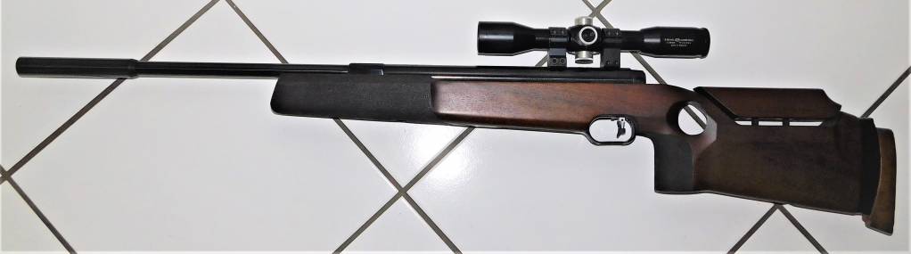

On the FWB300S Running Target rifles there is no open sight option or grooves so they have to be scoped.
B Nickel true Running target scope shown to put gun in its intended configuration,

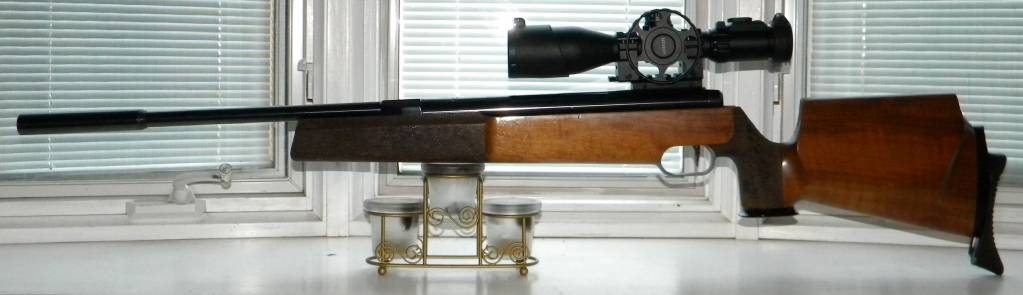

I use a compact Leapers 4-16 when I actually shoot it.

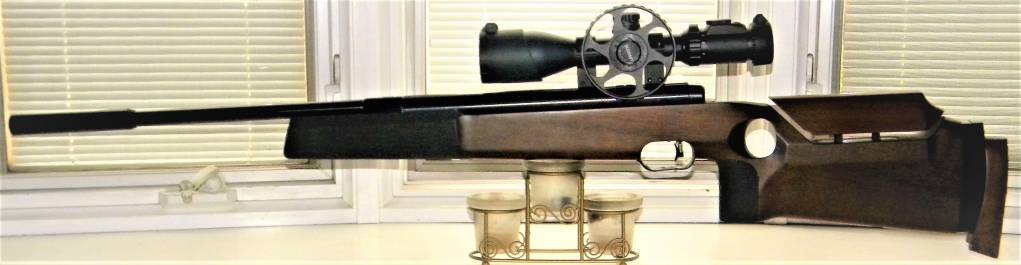

clears the loading port by miles, the same company's Bug Buster would be even smaller and lighter. Hawke is now making an AirMax compact as another consideration.
