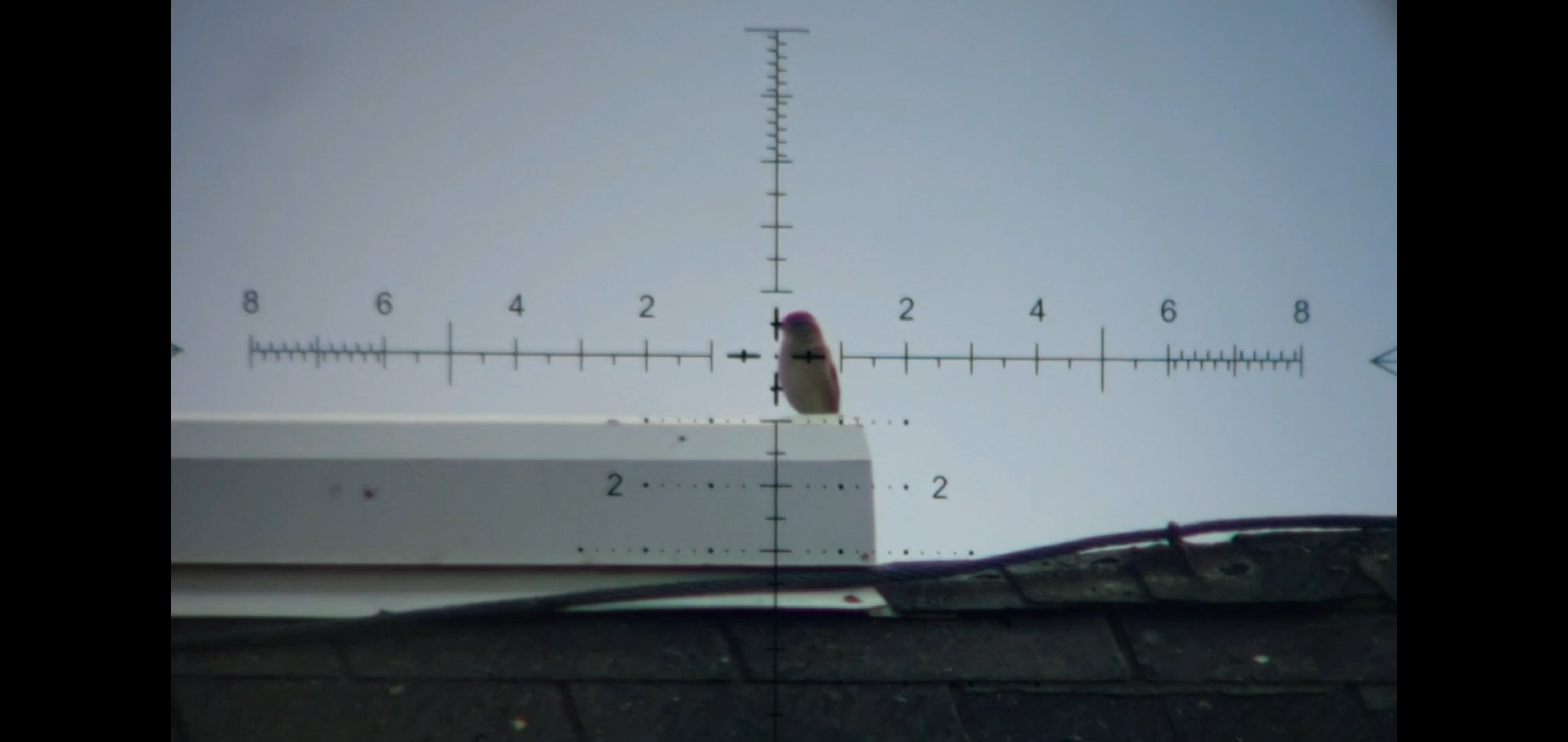

Help me and check if I'm thinking correctly about scope magnification when taking scopecam footage.
I want to record and edit my shots in such a way that the quarry is very large — so large it pretty much fills the frame.
● In order to achive that I need a very large total magnification.
I can achieve that using three methods:
(a) When editing, digitally enlarge the image and crop it.
(b) When filming, increase the digital zoom of the scopecam.
(c) When filming, increase the optical "zoom" of the scope (the scope magnification).
● Methods (a) and (b) make the image more grainy and thus reduce the sharpness of the image a lot.
Method (c) reduces the sharpness only as much as the scope quality goes down when using higher magnification. The top scopes I hear don't loose much sharpness.
