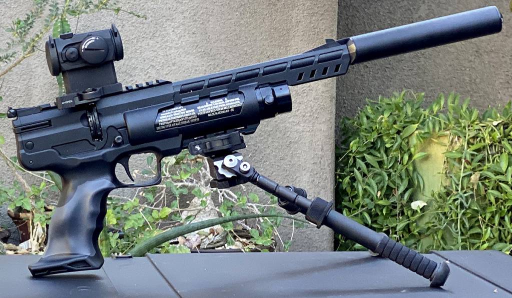

Its a fair comment Mike....I dont wear glasses and not looked at the issue that deeply to disagree with you. I was basing my comment on club members who wear glasses, often moaning about
 them ...but I cannot get on with anything above 2 M.O.A ...dot too big. This is a good one..
