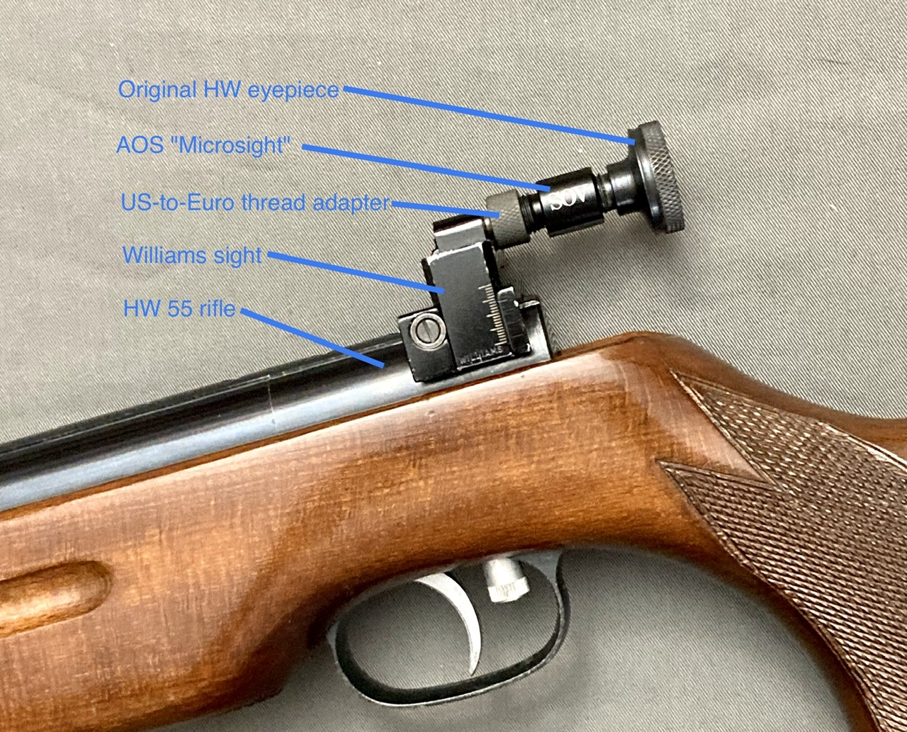

Here is the setup in question.
The adapter is a simple bushing with a male US eyepiece thread (7/32 x 40) on the front, and a female Euro eyepiece thread (9.5mm x 1.0mm) at the back. It allows you to use any accessory made for European sights in most US or UK sights (Williams, Redfield, Lyman, Parker-Hale). IMHO every iron-sight fan needs one of these!
The Microsight is a sort of fresnel lens that aids in simultaneous clear focus on the front sight and target, without magnification (made with the Euro thread, thus needing the adapter). No longer manufactured, unfortunately. Hector Medina has posted extensively about this interesting gadget on some other forums.
The Microsight is a sort of fresnel lens that aids in simultaneous clear focus on the front sight and target, without magnification (it's threaded for Euro sights, thus the need for the adapter). No longer manufactured, unfortunately. Hector Medina has posted extensively about this interesting gadget on some other forums.

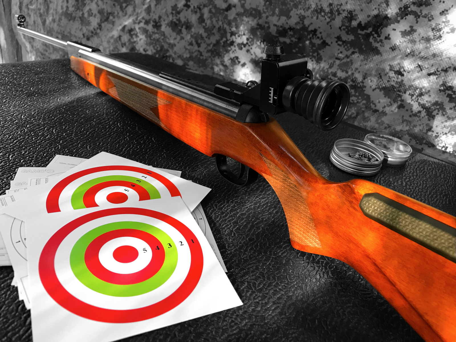

A HW30 is the perfect candidate. Here is my newest build (last week)HW30 from Krale with the Weihrauch diopter. An extension tube on the Williams diopter would do the same and keep the gun even lighter. Try it and you’ll be hooked.
I haven't tried it and I'm already hooked ,

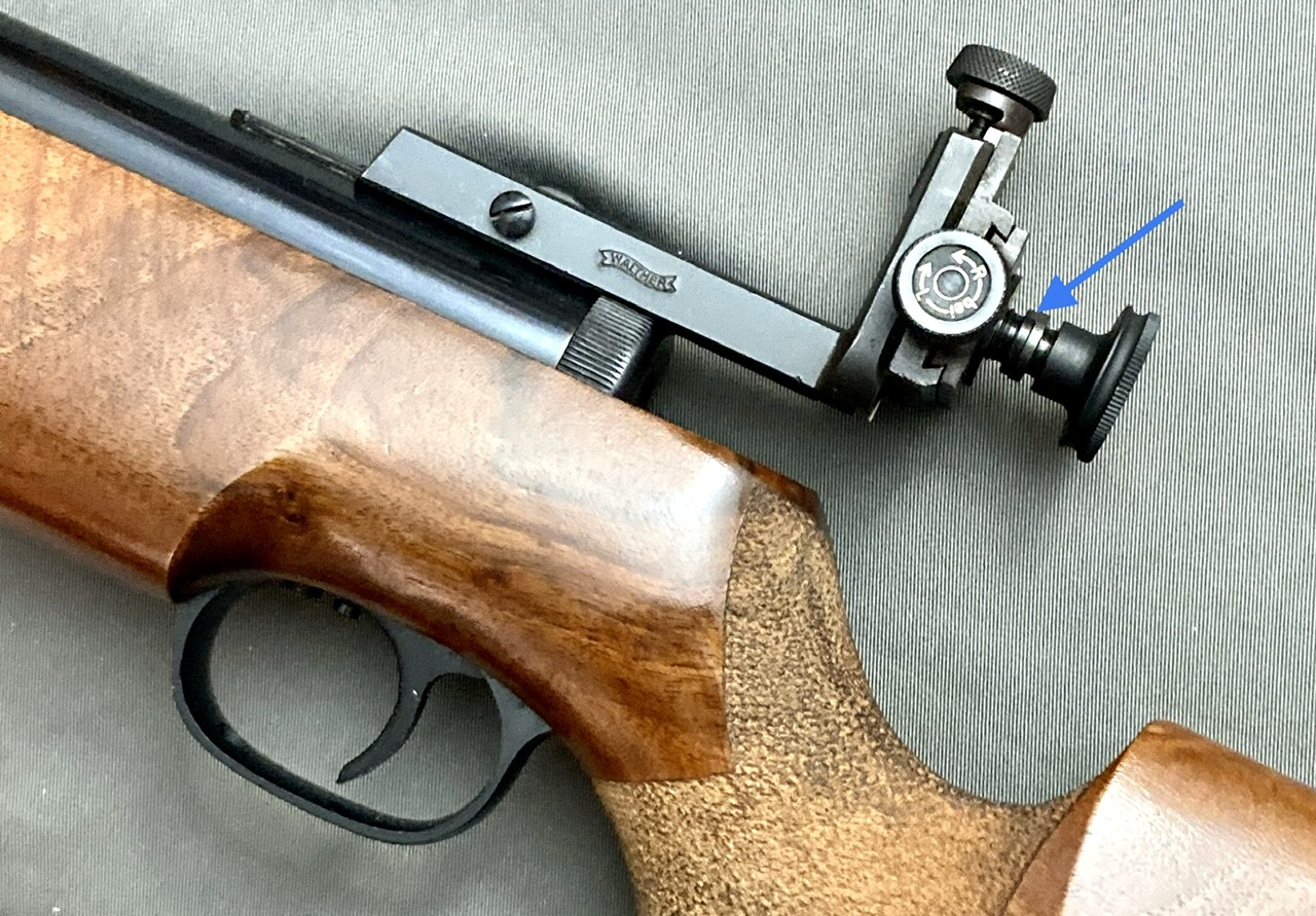

Going off on a tangent...but here's a vintage detail you might find interesting.
Like Weihrauch, early Walther (and FWB) diopters anchored to a few fixed points on the receiver. Later Anschutz and Diana came up with mount designs giving limitless fine adjustment of the sight's position, which must have been a solid selling point.
To compete with that, Walther came up with the idea of making the eye disk in two pieces, with the front shaft made in different lengths (pic is an LGV "Olympia" rifle from the late 60's; things are loosely attached in the photo to help make this visible). I've never seen any but the shortest shafts like this one, unfortunately. So, we aren't the first to think of variable eyepiece extension, ha.
If you could find some of these, they could of course be used in a Williams sight with the adapter bushing.
