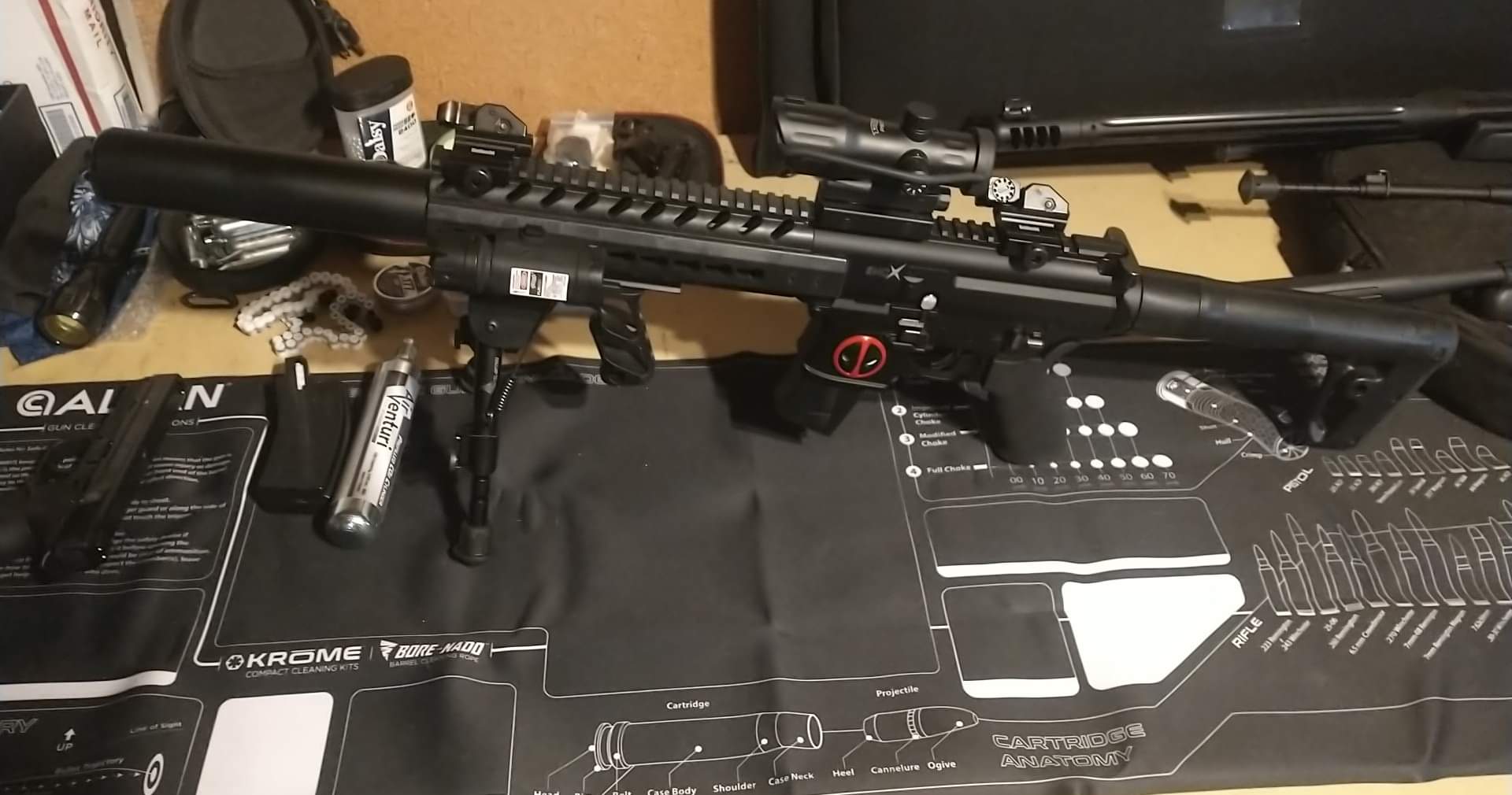

P.S. off topic, but check out my new sig CO2 !
