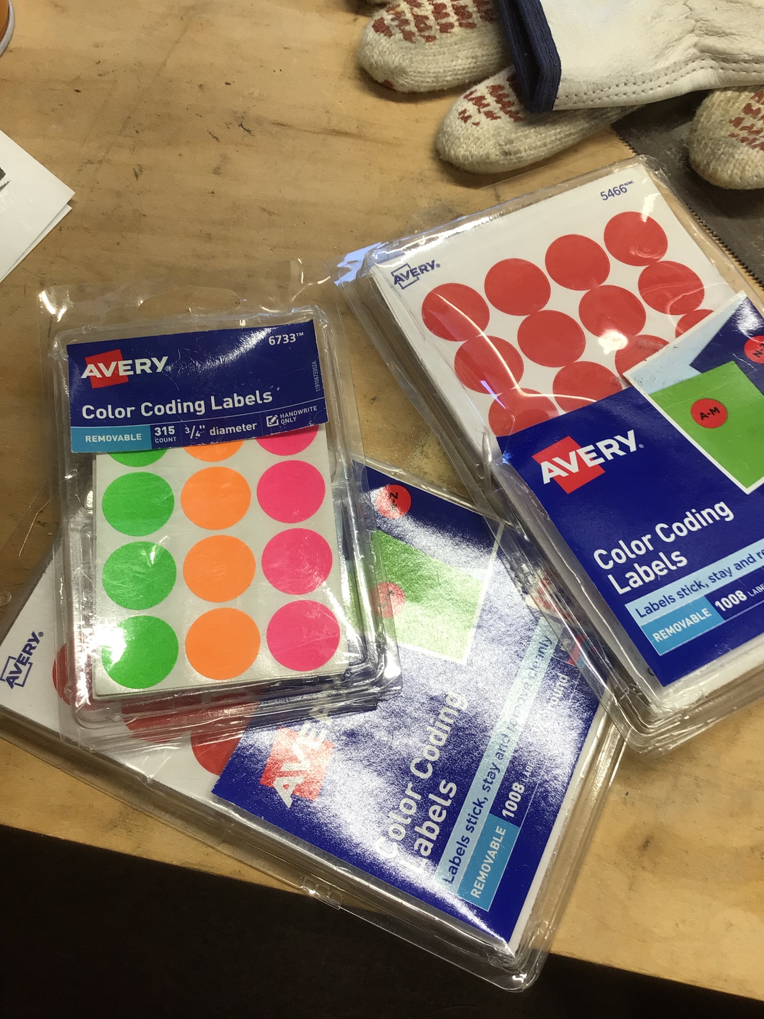

My normal MO for targets is cheap Walmart white card stock and 3/4" round colored sorting stickers. I can easily pick out 22 caliber holes at 100yds with fairly inexpensive 3-9x40 scopes. 17 can be a little tough but doable.

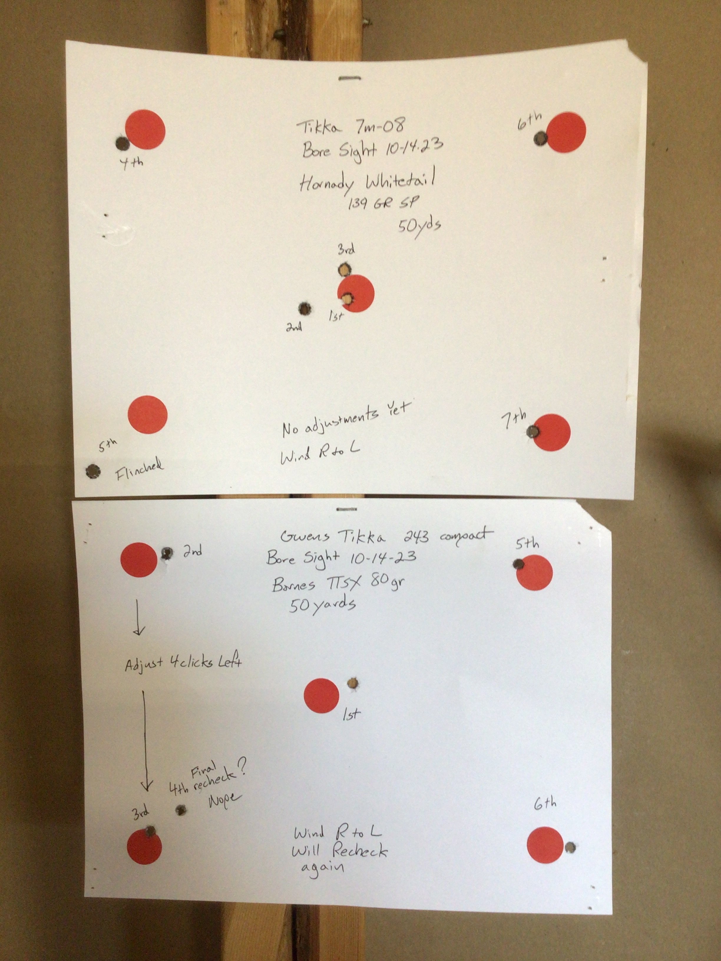

The trick is using the right target colors for contrast and learning how to properly focus a scope. I make my own targets out of cheap Walmart card stock and 3/4" colored sorting stickers. Properly focusing a scope just requires a little YouTube. Spending a couple of days a week at the range has taught me that probably 75% of people don't know how to properly focus their scope. Too many people use magnification to replace clarity. I've seen people at the range with high end rifles an 500 dollar Leupolds complain about clarity when they simply didn't know how to focus the scope properly.
Here's a sample of my homemade targets. Some times with the dark red stickers a hit in the red is hard to see but it's really the misses I need to see. Those are easy on white.
