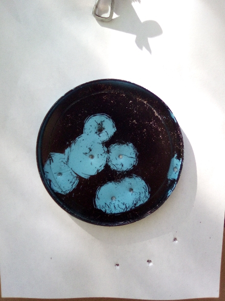

Light colored plastic lids painted black makes a " splatter" type bulls .😉
100y and .177
