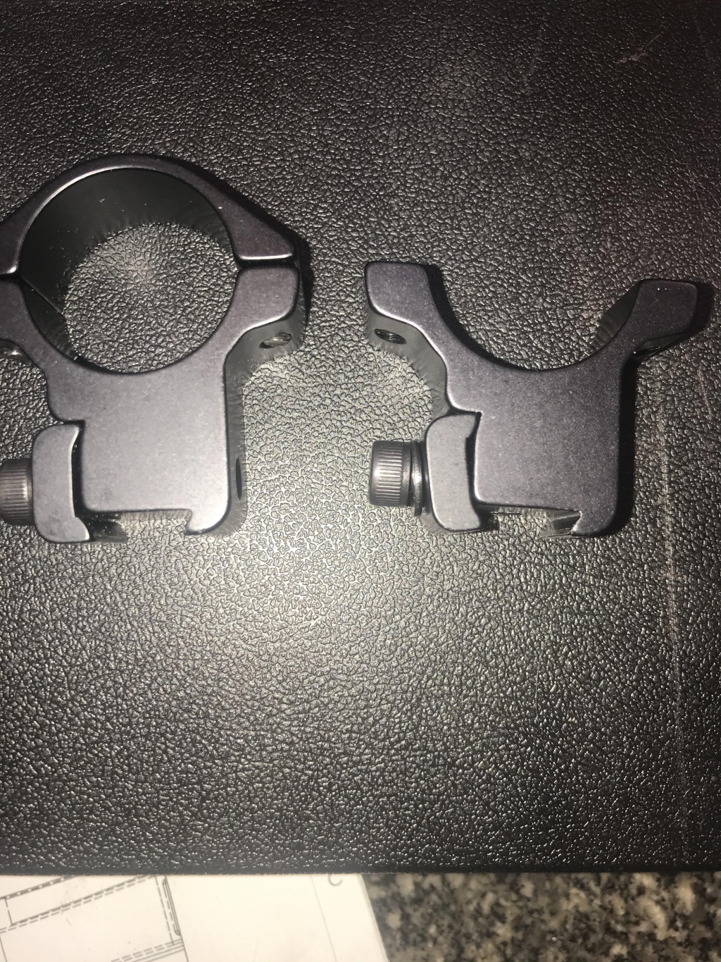

Scope rings with Reversible dovetail clamps 3/8 & 11mm
Which way do they go on 11 mm rail
1581111291_17326489415e3dd7fb9cb9a4.25250582_A407E69D-C821-495E-A80B-D40AF549BFEE.jpeg
Yes I'm sure. It's worth noting you can often mount the scope either way. As long as it clamps securely, you're good. That will almost always be possible with a 3/8" rail since it's slightly wider. The idea is to have the scope centered above the bore but as long as you orient the scope properly and hold it level when shooting, it makes no difference whatsoever. The scope mounting method I'm referring to is described in this thread https://www.airgunnation.com/topic/canting/#post-379913
