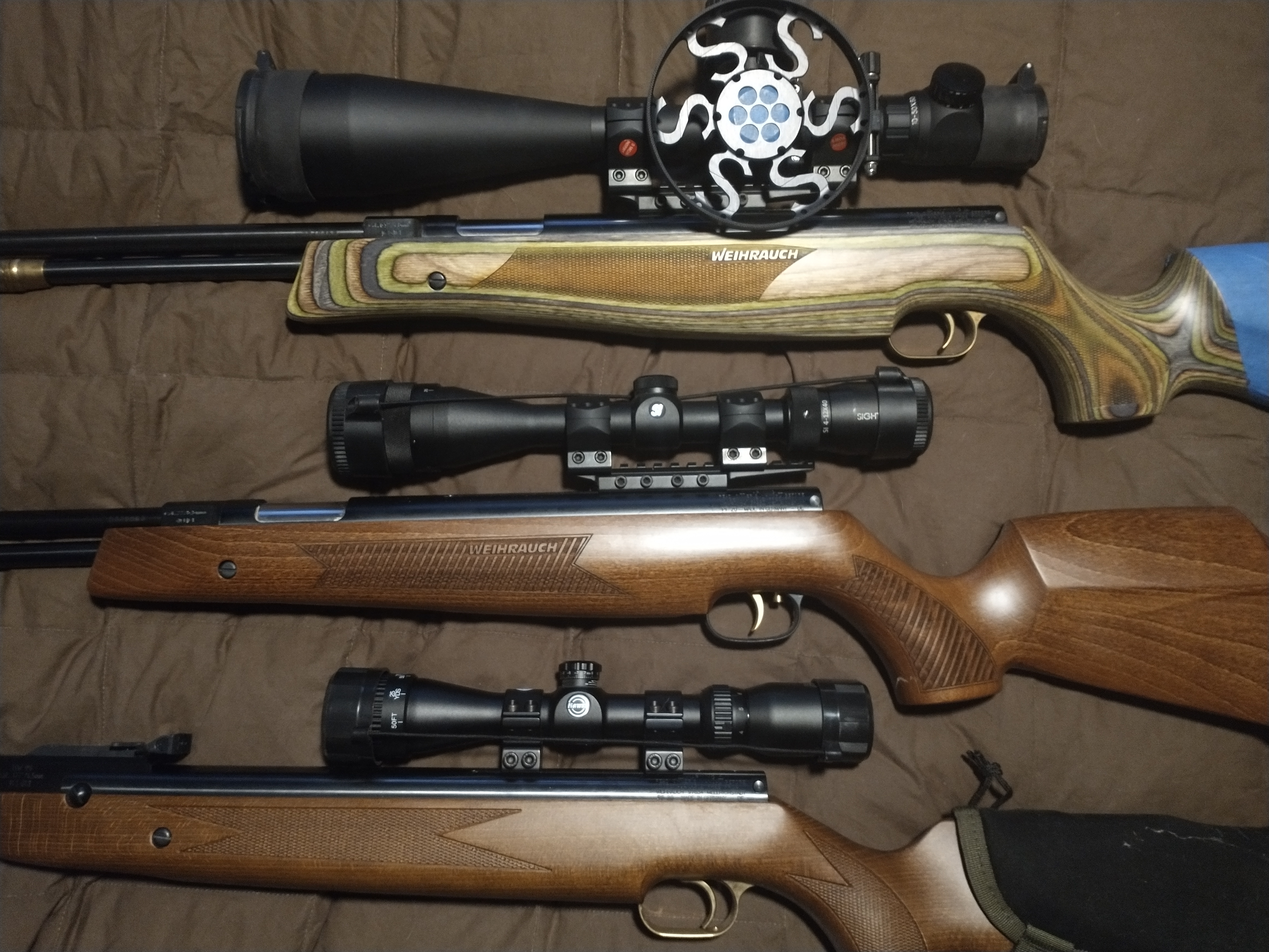

I use highs on both of my 97s to get a proper, comfortable cheek weld. I also use 50mm objectives and sunshades (personal preference) so that it doesn't look weird. Keep in mind that actual ring height will vary from manufacturer to manufacturer so double check your math when ordering.
Edit: My .177 97K scope actually sits at an "extra high" height due to a rail adapter. I do not particularly like thos and will likely grab a set of lower rings to amend that at some point.

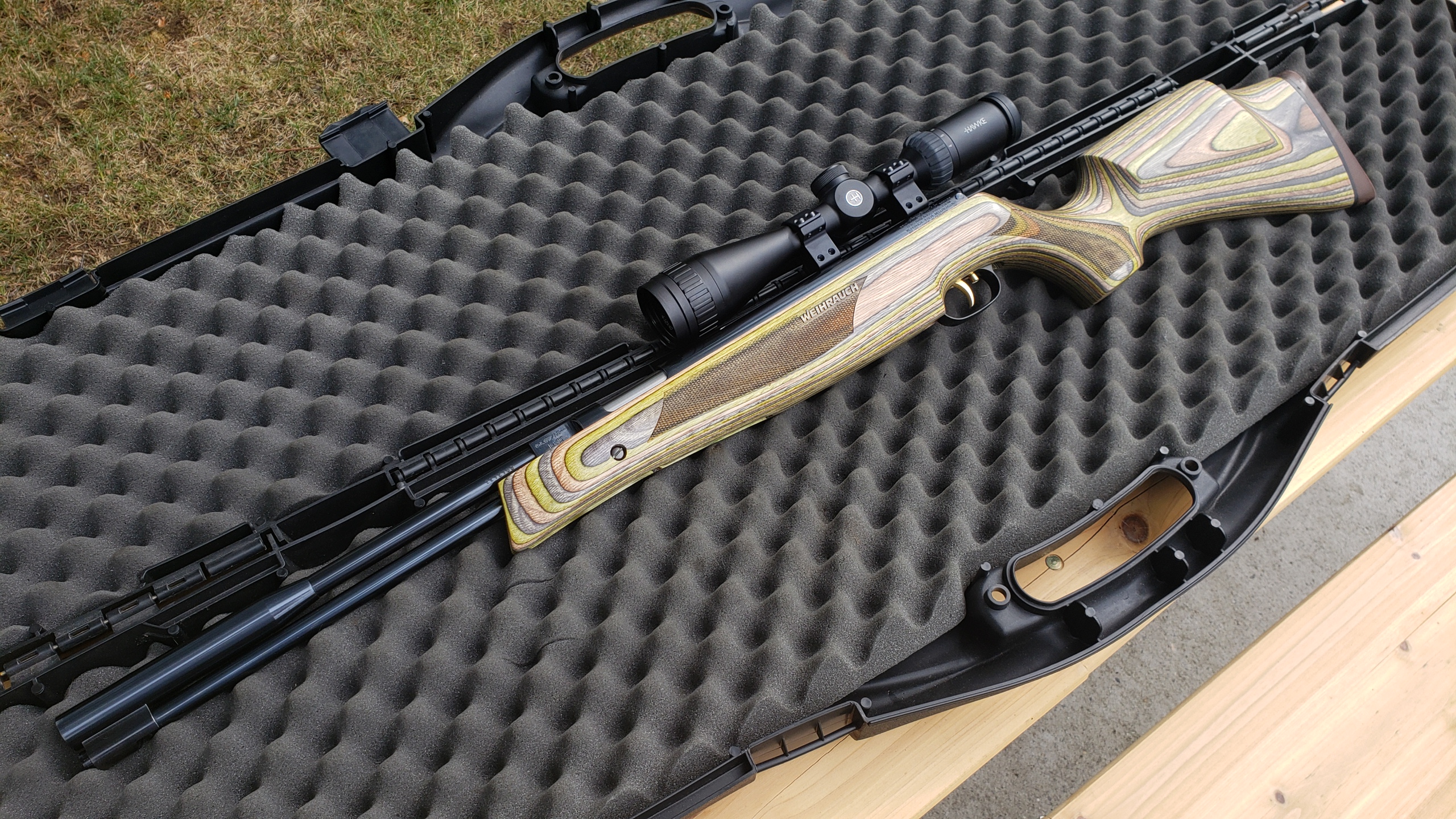

I have a Hw97kSE. Basically it's a 97 in a green 77 stock. The new 77s are as high as the 97s. I use Sportsmatch T04C rings and a 4-12x40 Airmax. I highly recommend those rings they are a medium height. I have a fat head and the scope lines up fine with my eye.

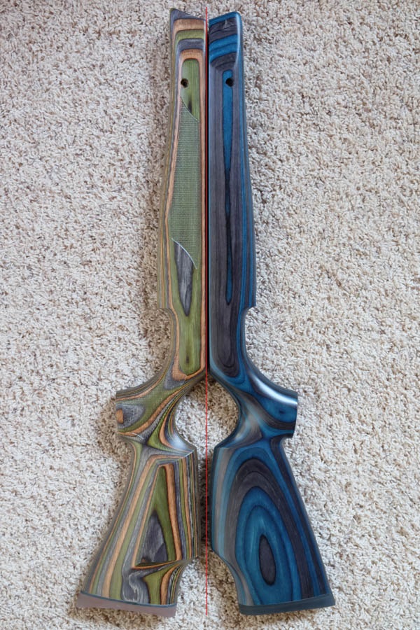

The blue stock is from a 97 and the green stock is from a 77. I can't see any difference in comb height.
