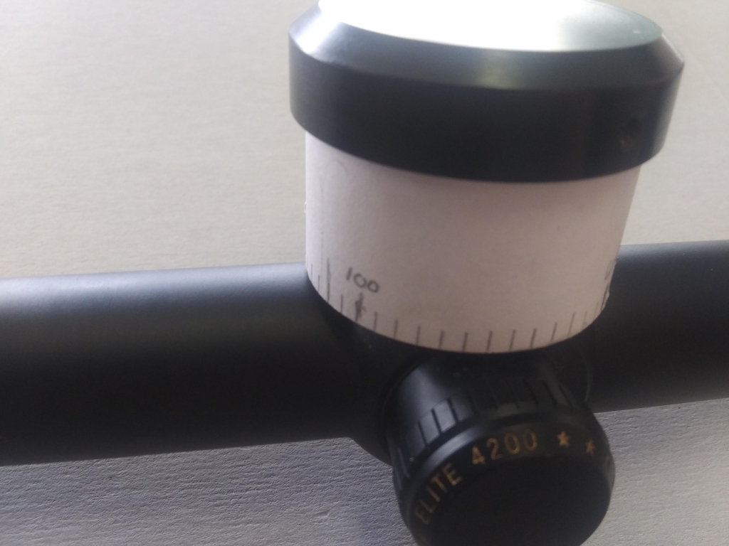

However, I've found many scopes have less positions in their turret positioning than there are click positions on the dial. They use grooves on the turret shaft that line up with grooves on the dial...but there are fewer grooves than there are turret positions. For example, I counted 20 grooves on a $500 scope, that had 60 turret positions. This means you can only adjust to every third hash mark which means you could end up 2 clicks away from zero on that scope. This wasn't an oddball example. Found this to be true with many scopes and not once mentioned in reviews. This kind of defeats the purpose of zeroing the turret if you can't line the indicator up with zero. With those scope you need to remember the zero is two clicks to the right...or add tape. At that point, why have zeroing?
