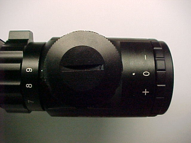

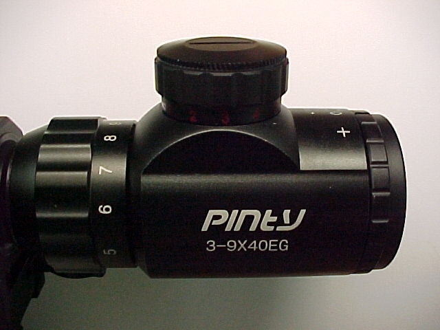

What scope is this? And the +/- is on the objective or ocular?
Here's the scope, a Pinty...
I had that outter ring cranked all the way CCW (+) when I started to notice the parrallax.
Normally it's about where it sits now. When I was goofing it around, I just thought it was something I had never noticed. I didn't realize that I had just created it.

The + / - you are referring to is typically the diopter adjustment and located on the ocular lens which is the closest to your eye. A parallax adjustment is usually side focus, opposite if your windage turret or on the objective lens at the far other end of the scope. They are a few models that have parallax adjustment up front, but not many like this. You can get a decent scope with adjustable parallax for around $150 but wil need to spend much more than that if you want something really good.
