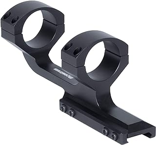

If you have the 11 mm Dove tail add a picatinny, "it will most likely raise the scope, or maybe something like this?

Thanks to all for the suggestions. I think my choices (IF keeping the 3x9 BugBuster) are: #1/Cheapest-- just remove the rear portion of the Gamo RRR, and move the front part (the "long" section) of the rail towards the rear of the receiver, and then remount the scope using my existing Hawke low rings. I don't think I need more than 3/4 to maybe a max of 1" rearward movement of the scope, to gain the proper eye relief. Of course, this method will negate the recoil absorption feature of the RRR, if in fact there ever WAS any benefit (gimmick comes to mind here) to that two piece RRR rail. Choice #2--is a LOT more costly: Purchase the "longer" (of the two available) Hawke cantilever ring set, and RETAIN the 2-piece RRR. I hate that if I DO use THIS method, I have to spend more cash and the scope height will be significantly higher (no low height cantilever rings from Hawke, the medium height is the "lowest" available). I'll probably lose my good cheek weld as a result. Choice #3: Completely remove the RRR, and remount the scope directly to the dovetail cut into the receiver tube. May need medium height rings, though, to get the scope back to same height as current because of the RRR now gone.
For beerthief--the "install both rings on the front of the scope" idea won't fly on the BugBuster, not enough scope "tube" to do that. And no way just using ONE mounting ring will cut it. That BugBuster is pretty heavy, and this is a bona-fide 27+ft lb energy rifle.
