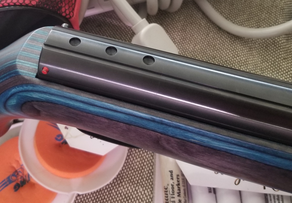

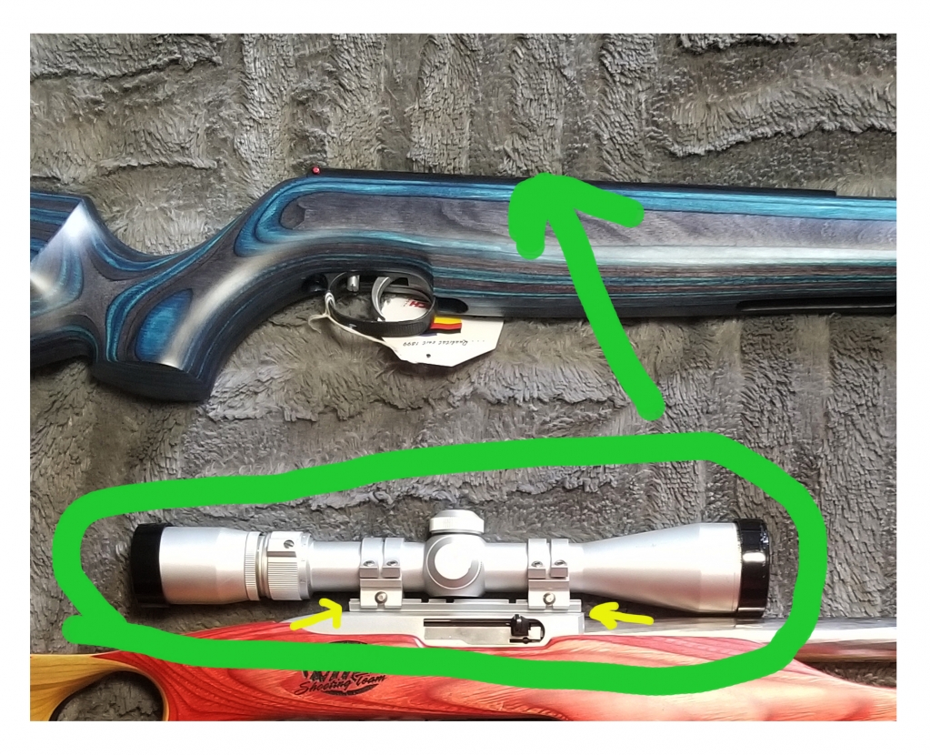

Hello,
I have Scope Weihrauch HW97K and also have following nikon scope - nikonsportoptics.com/en/nikon-products/product-archive/riflescopes/prostaff-3-9x40-silver-nikoplex.html
What will be a good mount for that scope/airgun combination?
Basically, I want to move scope from the bottom rifle to the top one. My understanding i need to get just a mount riser (not sure which one) - since existing riser is not fitting hw97.
Is it a good option?
What riser do i need to get?
hw97
Any advice would be appreciated!
Thank you!
UTG has a 20MOA version of that mount that might be better if you are going to use it.
https://www.pyramydair.com/s/a/UTG_Super_Slim_20_MOA_Elevated_Picatinny_Mount_13_Slots_0_55_High/7703
Spring guns trash most scopes and most rings will slip on the dovetail. My Diana 45 destroyed six scopes and now wears a cheap $30 scope that I expect will die soon enough. BKL is aware of this and makes many airgun based mounts and rings.
https://www.amazon.com/dp/B0036JV90W?tag=duckduckgo-ffab-20&linkCode=osi&th=1&psc=1
https://duckduckgo.com/?t=ffab&q=bkl+scope+mounts&atb=v180-1&iax=images&ia=images
Were it me I would buy an airgun rated scope and mounts so things would last for awhile anyway. I picked up one of the Diana Bullseye ZR mounts for my Diana 54, another scope killer gun, and put a scope I had laying around on it and have not had a problem since. Nor have I had a problem with accuracy.
https://www.airgunnation.com/topic/shot-some-targets-50-yards-with-the-diana-54/
