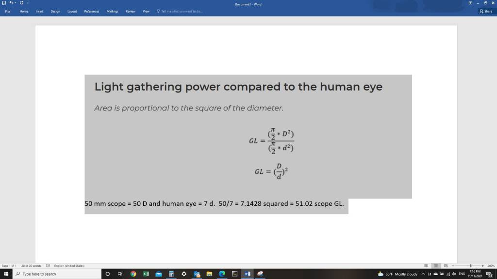

I believe that a 50 mm scope has a 51 times more light gathering than the human eye. That is without calculating any internal losses in the scope components.
Formula is:
D = objective diameter (mm)
d = eye pupil diameter (mm)
Example:
d=7mm
D=50mm
Formula is:
//www.w3.org/2000/svg%22%20viewBox=%220%200%20210%20140%22%3E%3C/svg%3E
Example:
d=7mm
D=50mm
https://www.optics-trade.eu/blog/light-gathering-power/ Of course old folks like me, 82+, probably have an exit pupil less than 5!
Sadly, this has nothing to do with light transmission or image quality. Even a coke bottle lens in a paper towel tube would give the same number. It is mostly meaningless, but to the average shooter, looks impressive. It is strictly a mechanical equation, and has nothing to do with the quality of the lens, coatings, or alignment internally of the internal complnents of the optic.
