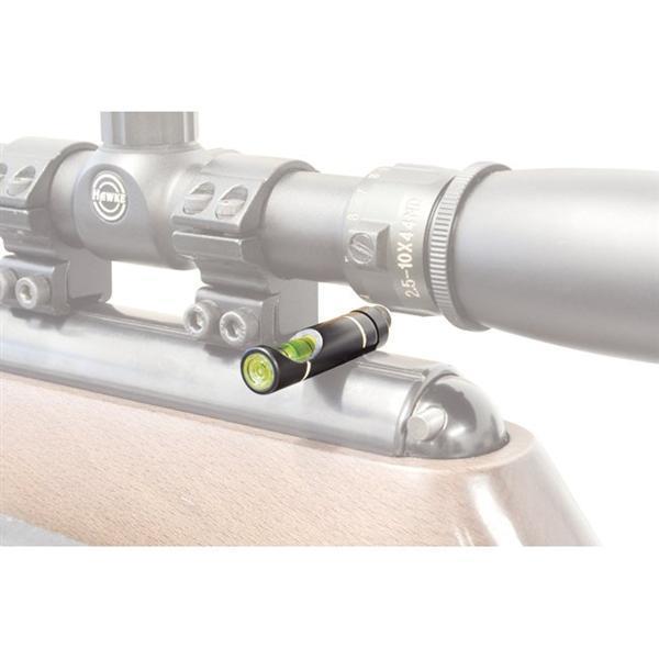

These levels can be had to fit picatiny rails or plain dovetail grooves, from Midwayusa or OpticsPlanet/Hawke. Just be sure if you order one that it fits your application.
