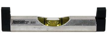

OK here is what I use for leveling my scopes and put a level on my scopes
first to level scope to gun I use
1. Wheeler 2 clamp set up level system
2, wheeler small level magnetic
3. a string or line with a weight on it and it is attached say 6 feet in air and the weight will hold string exactly perfect
Levels for guns
1, this is my favorite it is not a bubble level it is a ball level so way more sensitive best for Long range it can be illuminater with a a tritium phosphor capsule which can be bought on line
2,any bubble level attached to rail or to scope
3 some mounts have built in bubble levels so nothing sticks out of gun , most are pricey like
SPURH , STIENER , RRS ECT
4 I own 2 scopes with built in levels inside of scope , one is my US-OPTICS B25 , the other is my thermal ATN HD THOR 5-50
