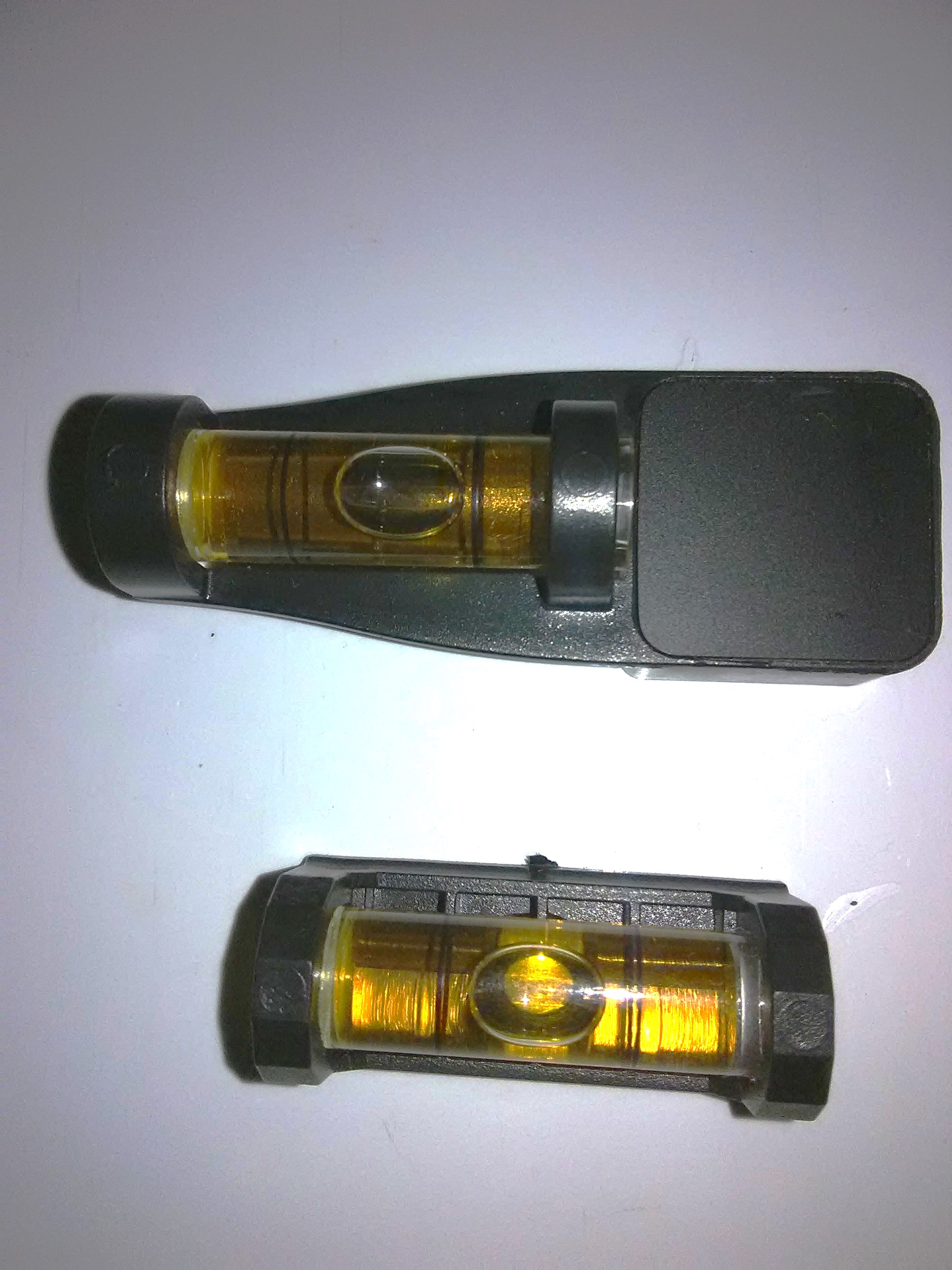

This is the one I use. I like it because the level can be folded back so it is not sticking out in the rifle case.
BKL rings awesome. They are made in The Great State of Texas. 'Merica!
That level looks like a good one, thanks

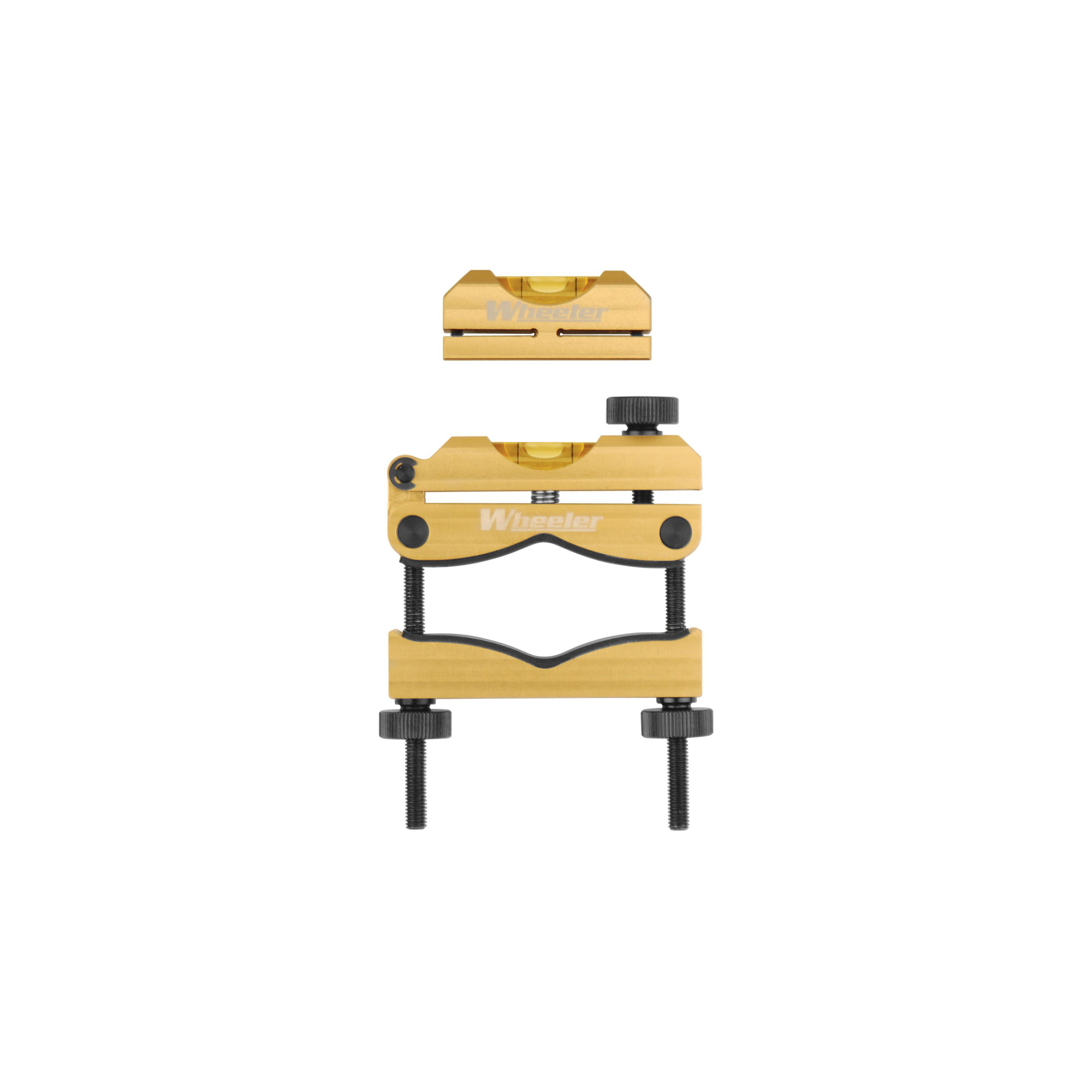

Wheeler Engineering makes a nice kit for getting your scope mounted properly:
As a gunsmith, i have used it quite a few times. Many rifles have a rail, so getting the scope level to the gun axis is pretty straight forward. After that, your rifle-mounted level will keep you honest when shooting.

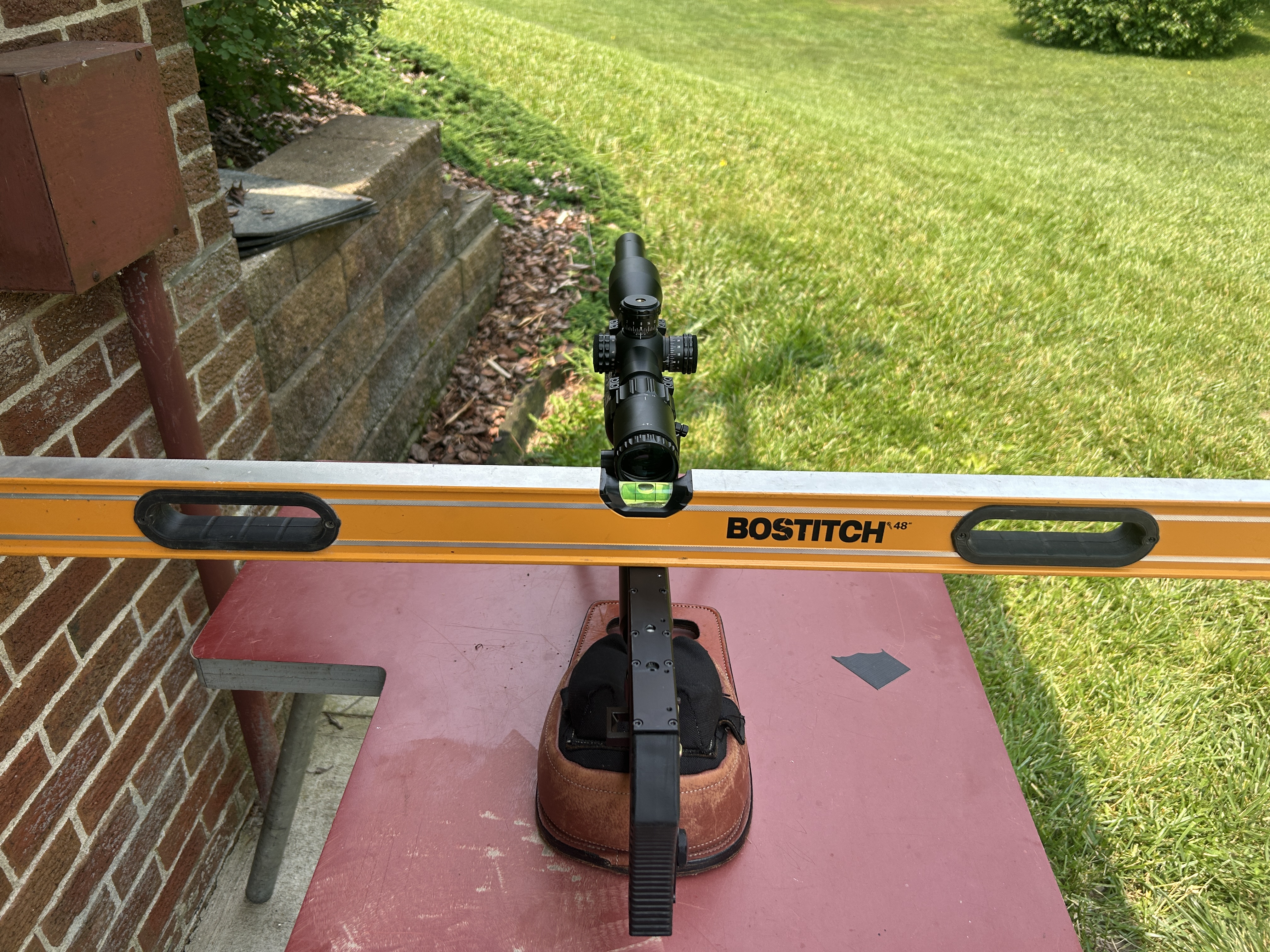

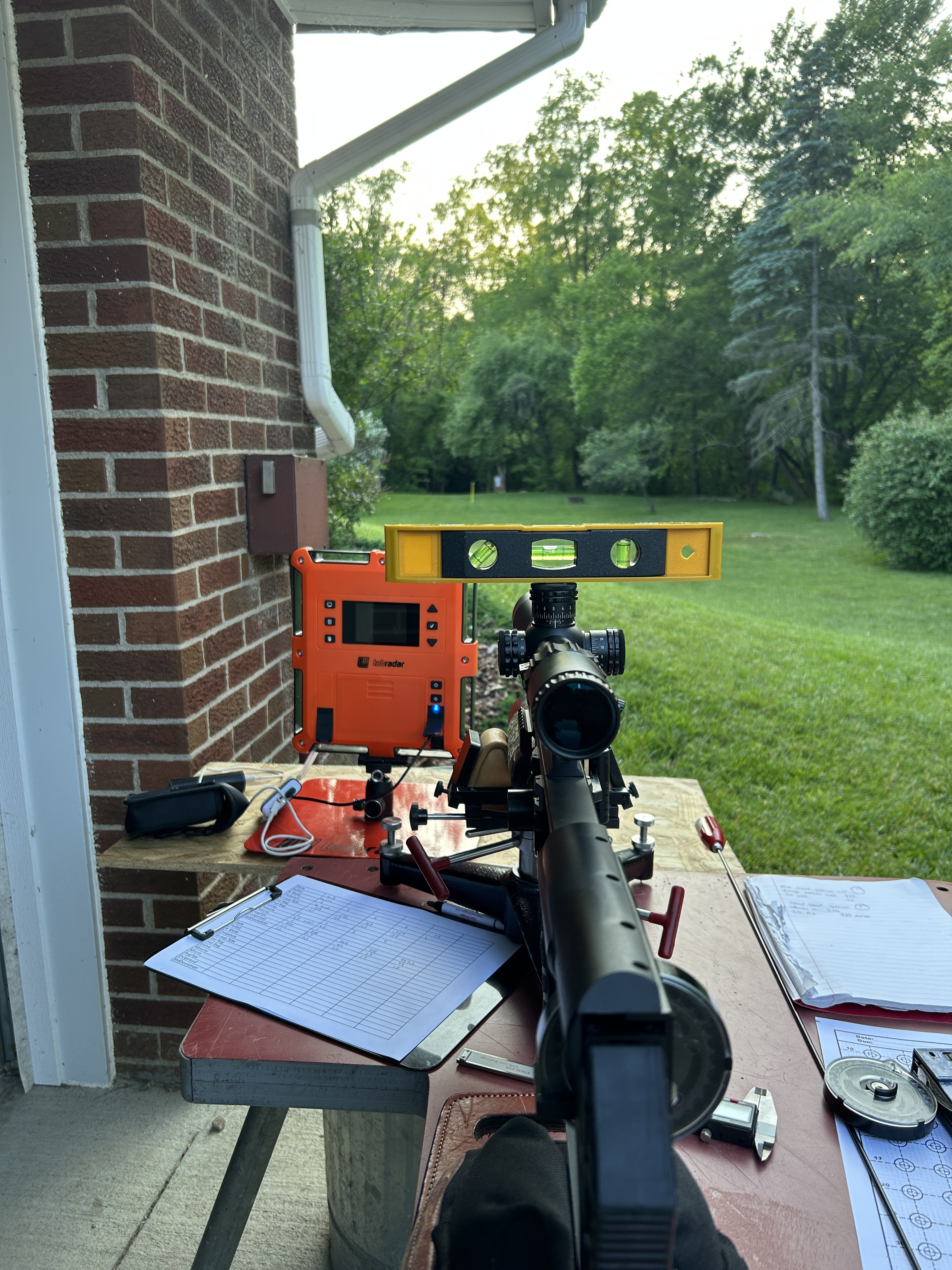

It’s interesting how a vague post can lead to thought provoking discussion, I was inquiring about a scope mounted level but I should have clarified from the start. I appreciate the recommendations. I actually did verify the scope was mounted level using a carpenter level and a plum bob at 75 yards, I couldn’t get the mirror method to work.
