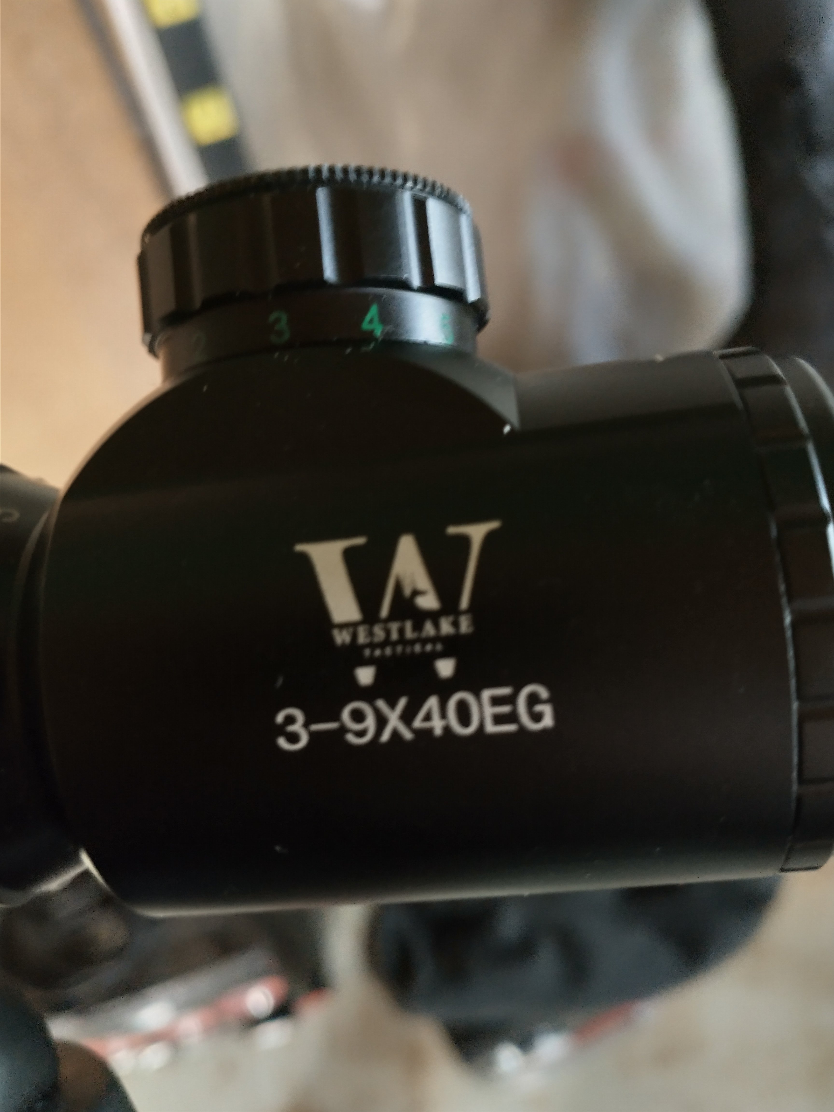

I got a different scope , a 3-9x40,, exact same issue with this one , maxed out all the way and still shoots too low. This sçope has a direct dovetail mount, no round mounts, so I can't shim this one to try that out.. I am a beginner, what the hell am I doing wrong here ? 2 Scopes can't be off, any advice is appreciated.

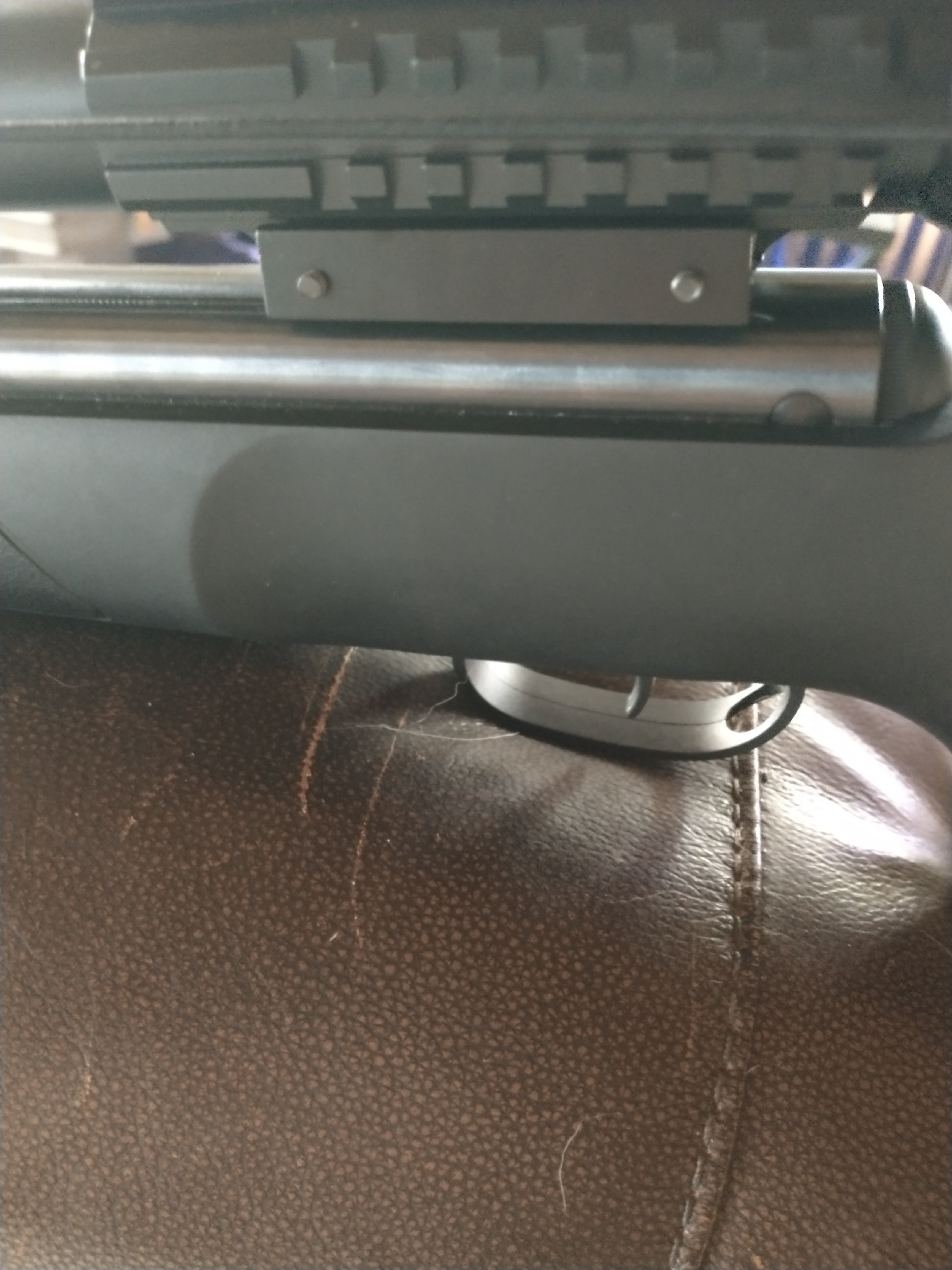

By saying it's shooting too low, I mean the POI is lower the center of my cross hairs. I need to lower the cross hairs more to match the POI, but I'm out of clicks

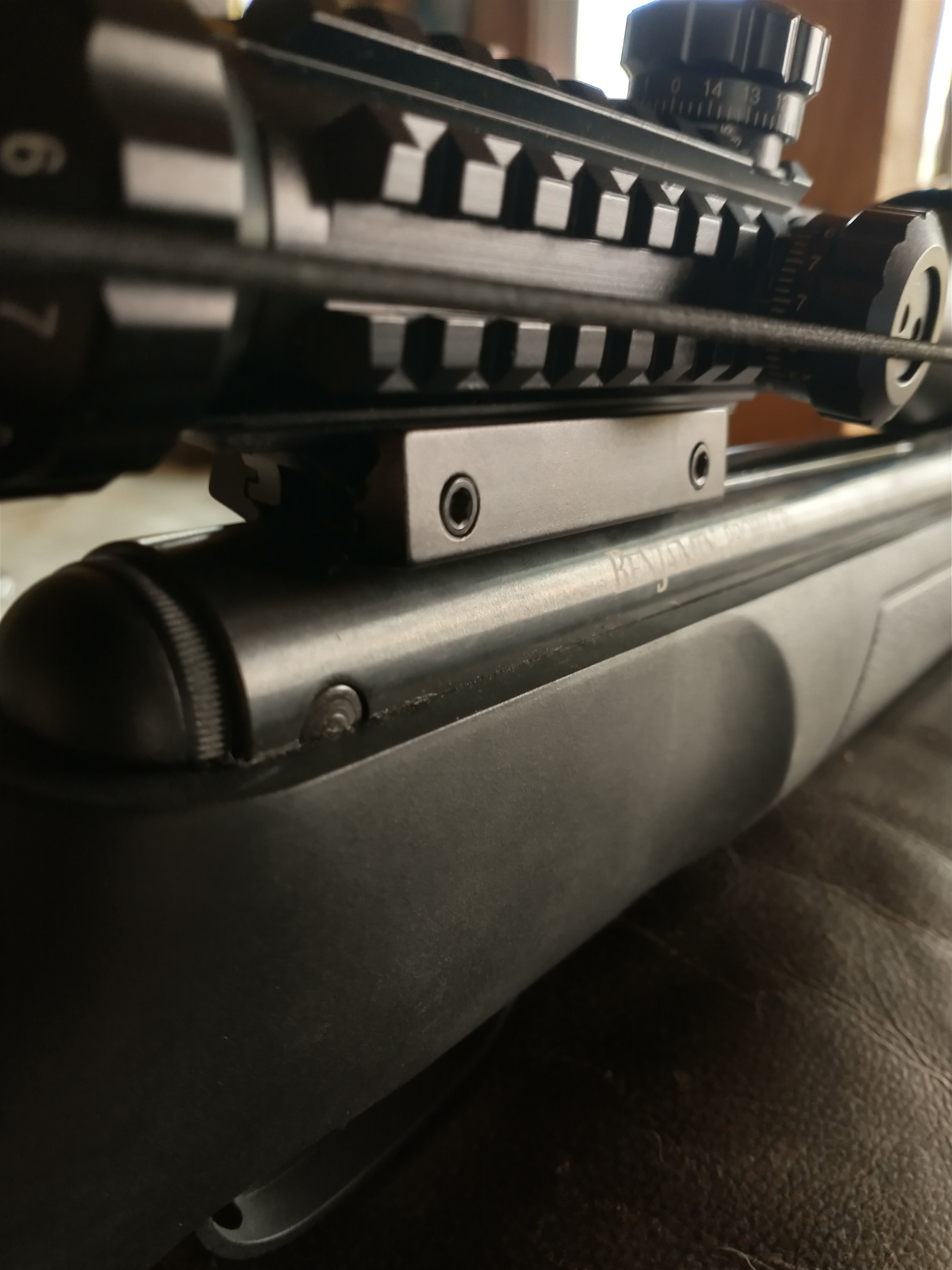

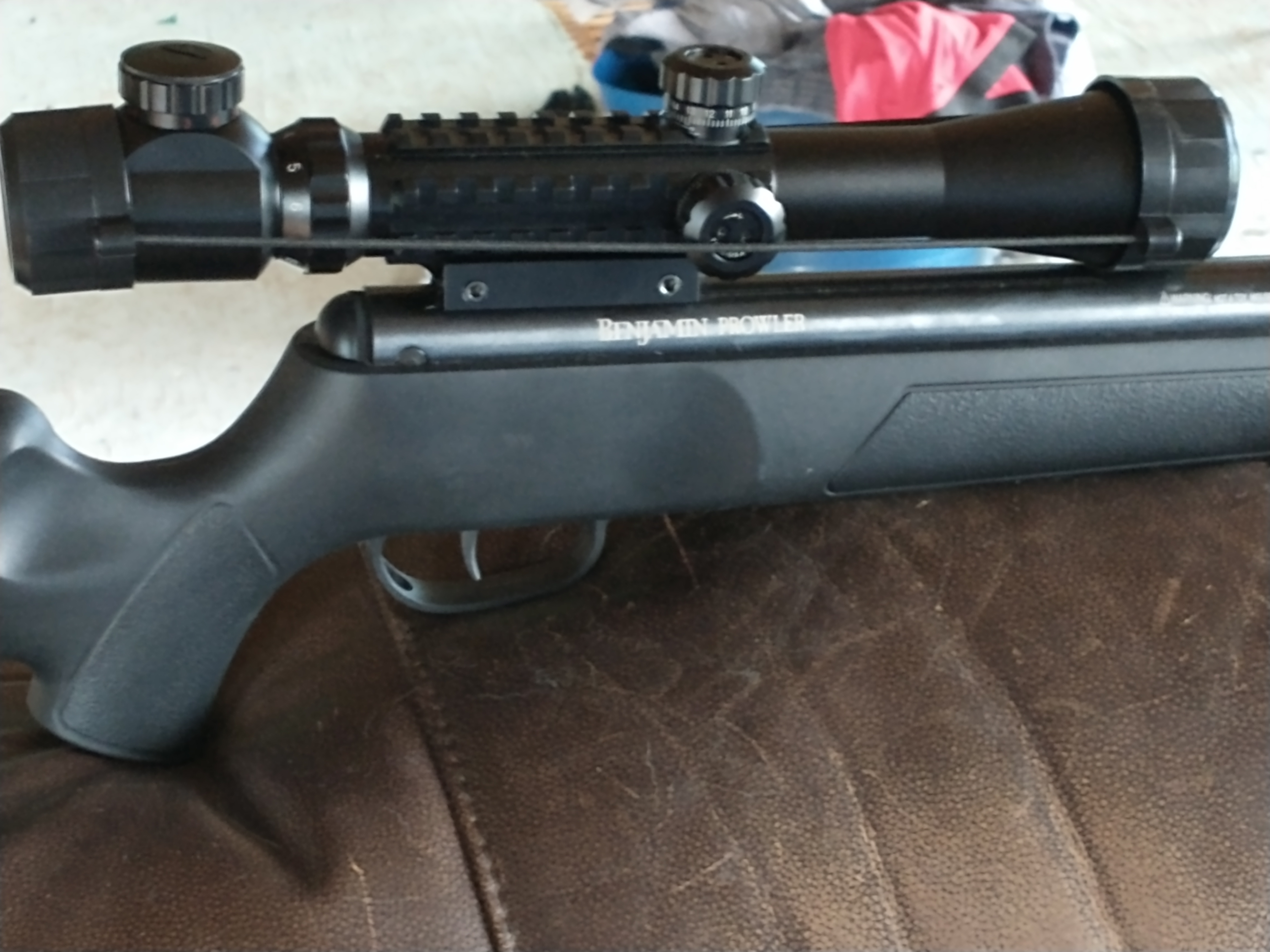

Lets see some pictures of how this scope is installed
Well that's new. Never seen a scope/mount setup like that before.

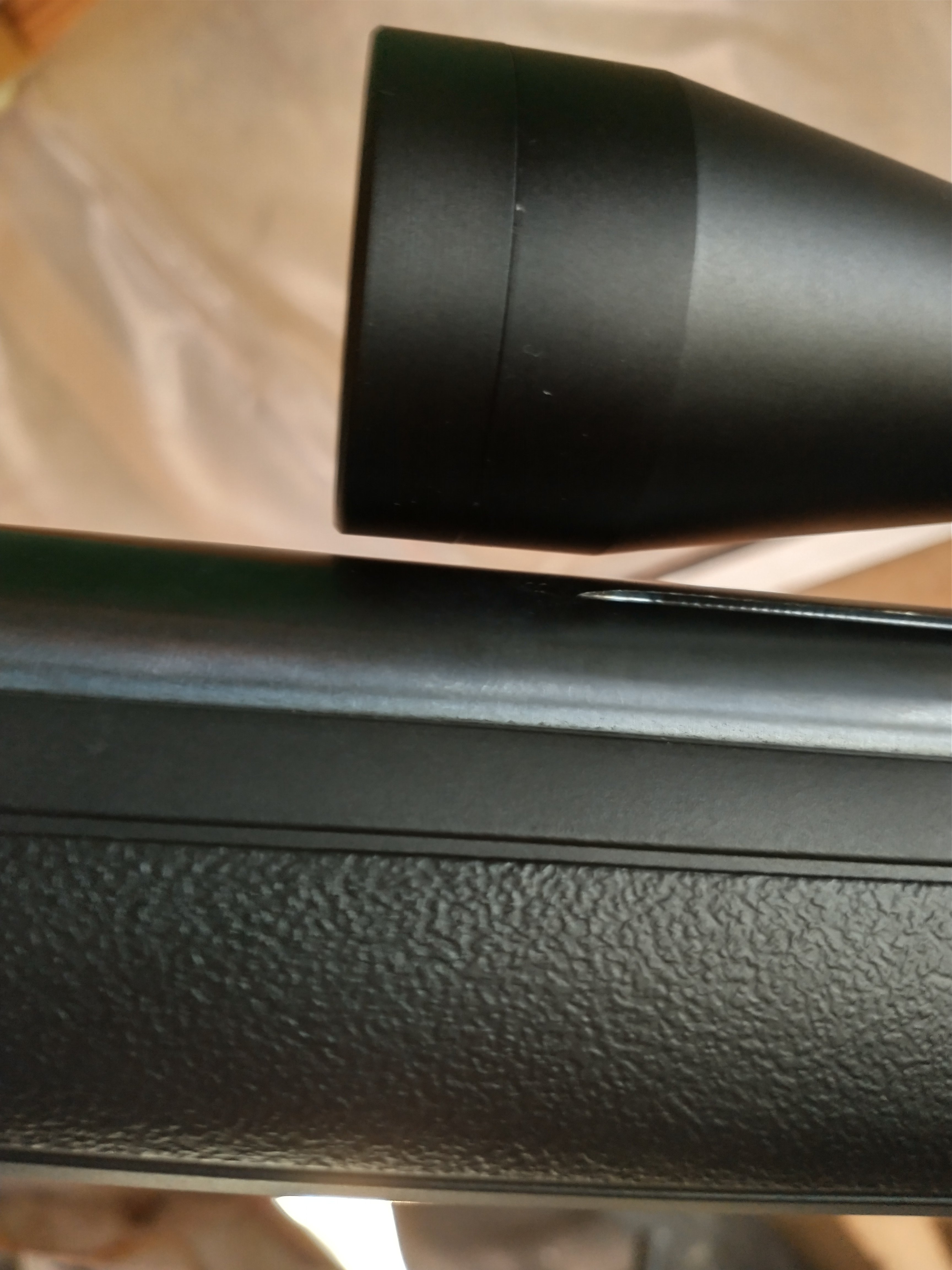

Is the front objective sitting on the main tube?

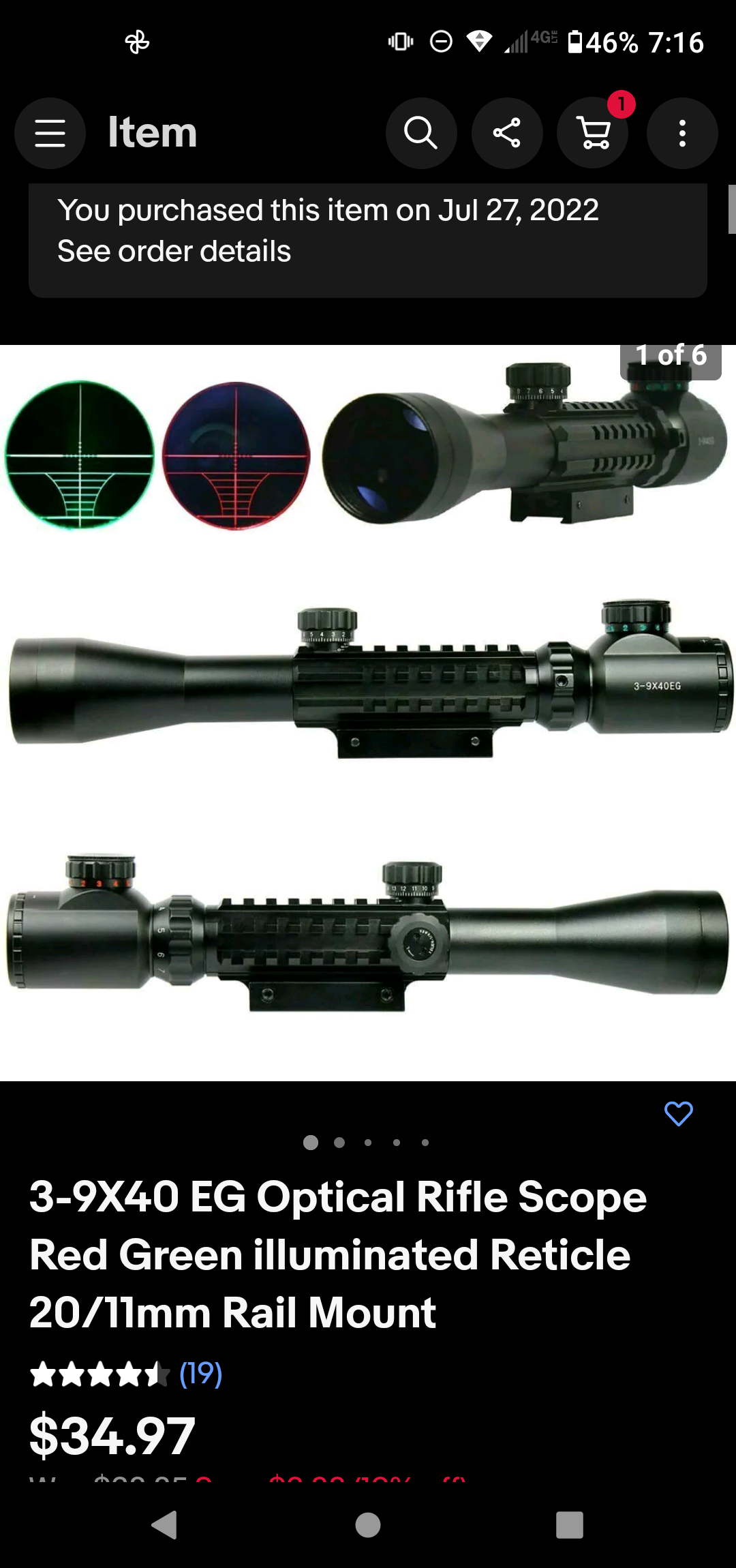

Yea apparently it's a newer thing, I mean the scope was $40 on ebay so it's cheap lol, but it holds firm and doesn't seem to shift at all, ive shot about 100 rounds today trying to zero it in.
And no the front objective is not touching the main tube. I took a picture to make sure that's what you meant lol 👍, I'm still a newb.

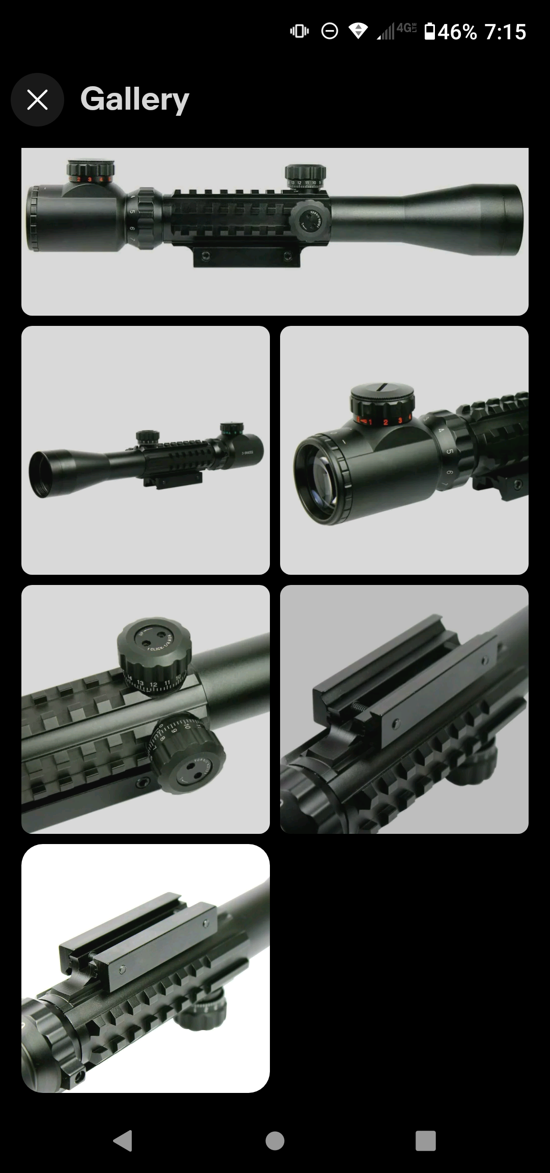

It's supposed to mount both 20mm picatinny and 11 mm dovetail. The two brackets on the outside come off for the picatinny mount
Thats exactly what I was looking for and yeah that looks good. Look down the whole length of the tube and at the barrel. Does the barrel look like it is pointing excessively downward compared to the tube? If so, you'll probably just want to have the gun warrantied out, especially since you already have the scope shimmed with no luck.
Lemme look.....
Now that you say that, yep. It's drooping downward towards the tip of the barrel.Its almost like the plastic molding around it isn't shaped correctly. Definitely a noticeable downward "rake". I double checked the break barrel part to ensure it was closed all the way, But yea man I think you're correct here. I got it from Bass Pro a few weeks ago I'll go talk to them about a return policy , I've been looking into a different springer with a bipod anyway, hence the other post I had lol, but yea thank you squirrel👍👍 any suggestions on a good Springer ? I'll get a pcp eventually, but for now I think break barrel while I'm still new

Spend a little more and avoid all the heartache man. We've all been exactly where you are now and it gets old fast. An HW50S from Krale will keep you happy for years. Its a little lower powered but it is still more than capable of taking game like rabbit and squirrel out to 40yds give or take depending on how good of a shot you are. In all honesty, it's probably one of my favorite guns.
That gun definitely has some barrel droop as well but that is to compensate for the iron sights. An RWS Lockdown Mount takes care of that easy peasy though.

Get a yard stick and put one end on the breech block with the rest hanging down the length of the barrel. It will show you how much droop your barrel has.
You could bend it and I know many do, but if it's under warranty, send it back and put the money towards something better.
