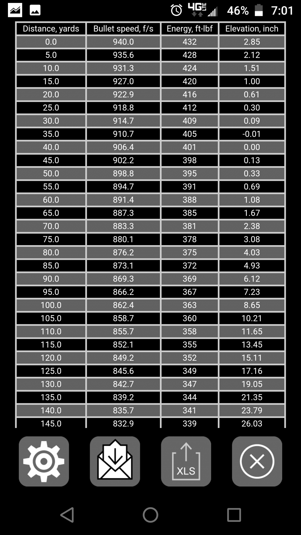

Try a 40 yard zero. Here's a drop chart from my 457 Challenge and 220 grain slugs.
@AncientSword I meant to ask, how high is that scope mounted (how much space is between the top of the barrel and the bottom of the objective? Is it mounted on a flat dove-to-pic rail, did you shim your rings, or does it have at least 20 MOA built into it?
It looks like it’s about 3”, but I didn’t measure it, just eyeballed. It’s a picatinny to dovetail adapter, no rings as I have my thermal mounted.
I’m thinking about going to a lighter slug to get a little more velocity out of it, but I can’t get the scope much lower very easily. I want to be able to use the quick change mount so I can move my thermal but keep my zero. Otherwise I would use the insert adapters.
