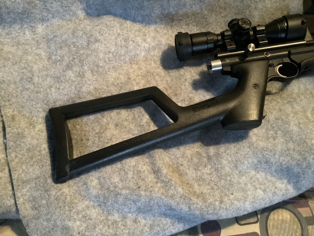

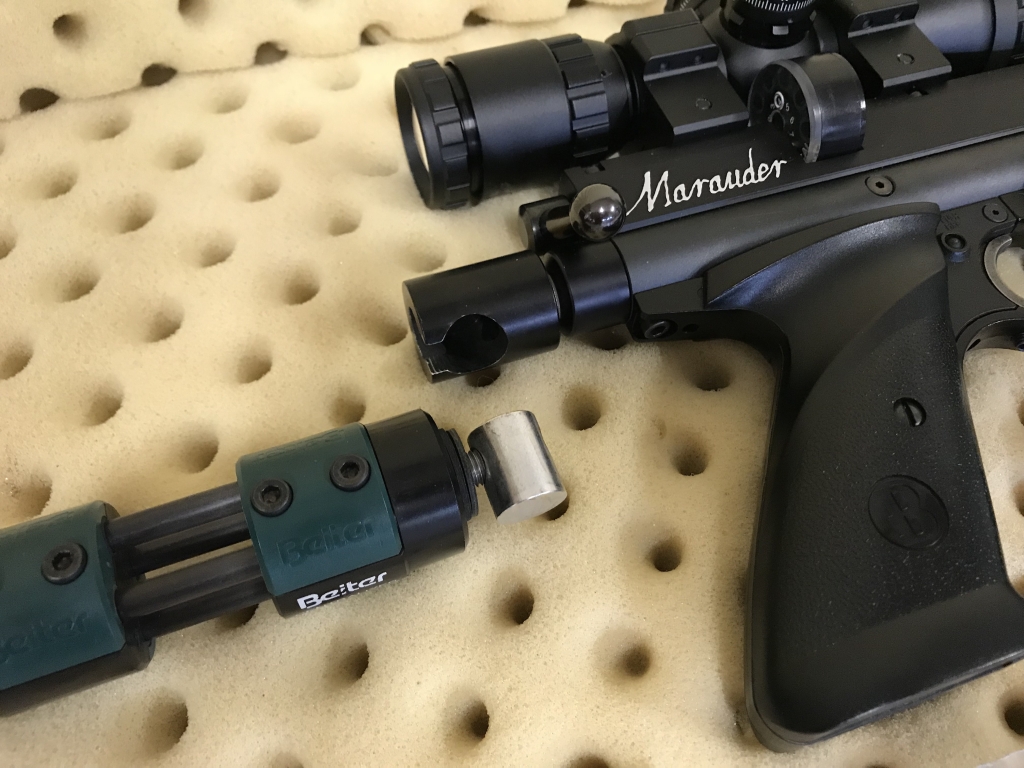

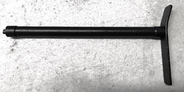

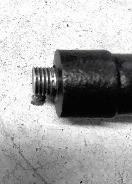

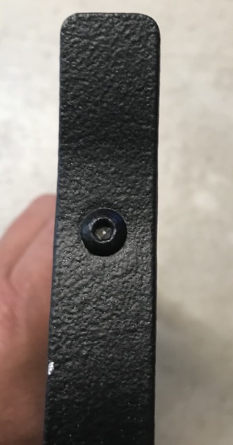

I have made a few of these diy stocks. It’s a copper tube and two end caps. The butt is I piece of aluminum bar stock. I have a bolt on the pistol side held in with jbweld and on the bit side a nut held in with jbweld. I didn’t care for the Crosman stock. This was cheap and easy.
I’ve had my prod for about a year and a half now with thousands and thousands of pellets through it and I never had that cheap plastic stock on it. It seems so small that it’s hard to believe that the LOP would be too long. Cutting it down or adding some aftermarket stock seems easy enough. Maybe a Steve Corcoran????
