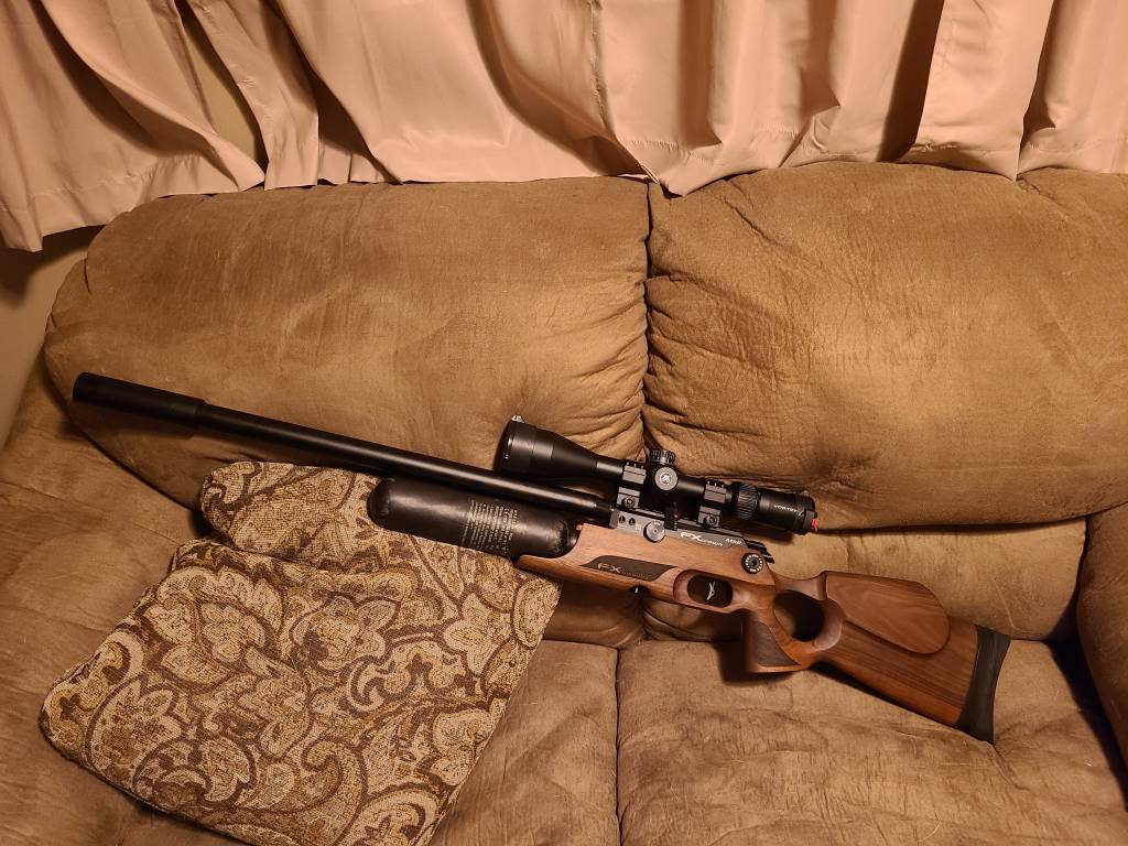

Scope for Daystate Revere
Getting the Revere in .22. Setting up for hunting inside of 100 yards, mostly inside 70 yards. Considering a fixed power with a decent reticle.
Any recommendations? At present considering SWFA SS 6 power with a mil/quad or MOA quad. A little heavy.
Another possibility the Bushnell Engage 2.5-10 x 44. With the Deploy reticle. Still kind of heavy.
Any suggestions appreciated. 60 yrs old with aging eyes.

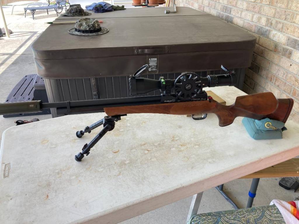

(3) How much of a magnification do you really need at the top end (depending on your maximum range and size of kill zone, AND the quality of your eyes)? I shoot mostly field rested (leaning against a tree or other structure), and I feel I'd like more magnification at 60 yards than the 12x I'm using on one of my rigs. For a 100y I have an 18x, and that does fine, though to see my impacts on a paper target it gets a little dicy. 24x would serve me better there.
