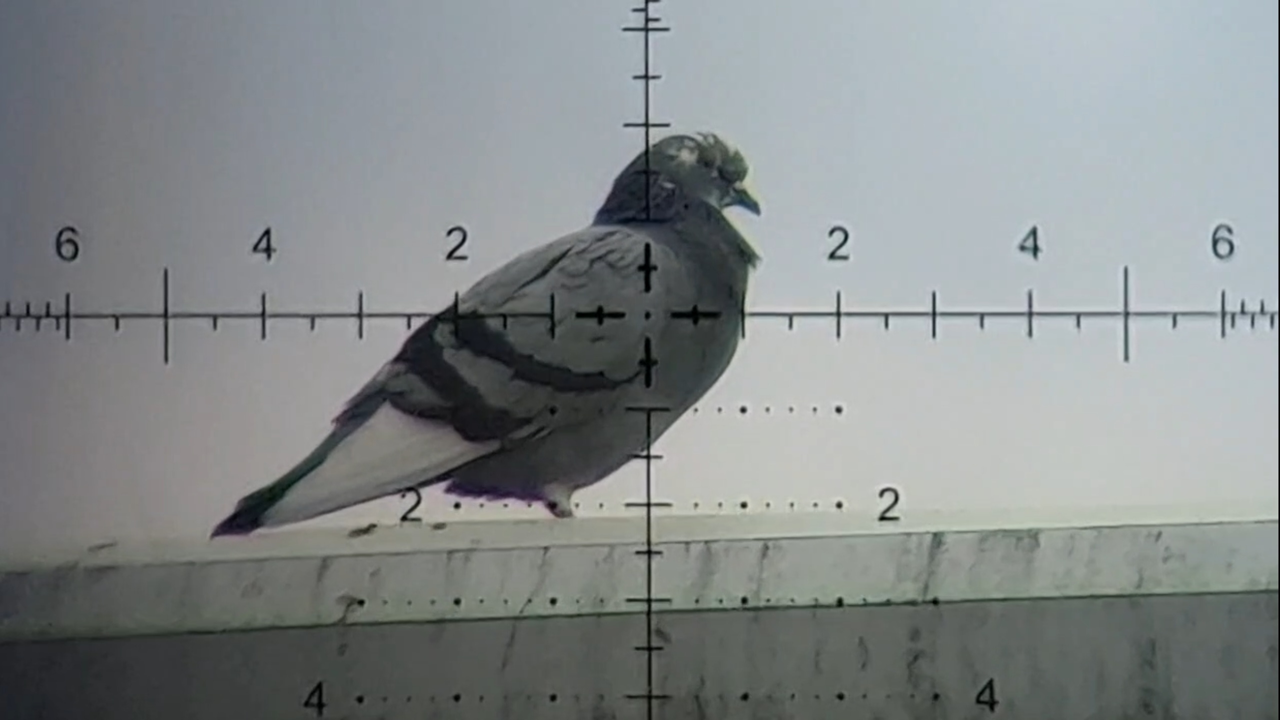

I have the scope cams that Ezana4CE has and currently have the tactacam. There seems to be issues with all of them. Mounting them to where the camera is centered in the retical with no shadow is one concern I always have but is less currently with the tactacam on my element. Keeping things always focus is not easy for me. But the big plus with the tactacam is that I just push record before shooting with a 128 gb card and I can shoot for about 2.5 to 3 hours without stopping. I always forget to push record when I need to so I try to push record early in the day after setup. Another thing with the tactacam is, you don't have to flip the image over when editing. With the gopro/scopecam because of the mirror image you do have to flip the image after recording to see the retical correctly. Easy to replace batteries is a big plus on the tactacam. One of my batteries does not last as long as the other two so having extras is helpful. With the go pro at least with my older one you cannot record for hours at a time because it cannot and it gets very hot if you have it on for a long time. Also with all the mirror setups so far i have issues with reflection and recording of the things behind me when i am not behind the scope. I do want to try the triggercam as it has some good reviews and easy setup. I'm sure it will still have reflection issues but that can be less if you wear a large hat with a large rim that extends behind you.
Here is 230 yards with the altaros slug. Not so focused.
and here is the 220 yards with the 38 gr nsa. This is where you can see the retical not being centered with the right side more focused than the left and the heavy shadow on the right of the picture.
