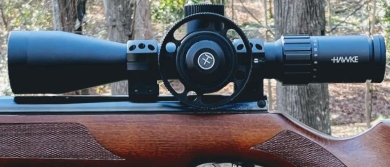

Can also use the HAWKE BRAND user adjustable moa base. Says adjust up to 100 moa.
https://www.opticsplanet.com/hawke-sport-optics-one-piece-11mm-to-weaver-rail-adapter.html

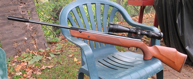

Hawke Airmax 4-12x40 scope in BKL double strap rings on my HW95 .22. I've also got a Beeman R9 .20 caliber which is the same rifles and has the same scope mounted on it only I used a set of reversed Hawke Reach Forward Match Mounts. The Airmax should easily take the recoil from a 15-16fpe rifle, it's what they were designed and built for...lol.
Neither has given me any problems and while others mileage may well vary, neither of mine had barrel droop to speak of let alone needing droop compensating mounts.
