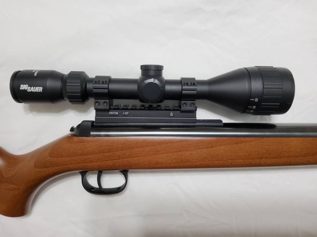

Another option which I now have on my M34 T06 is this picatinny to dovetail adapter mount. I have low Warne steel rings to secure the scope.
https://www.airgundepot.com/utg-drooper-scope-rail--11mm-to-weaver-adapter.html
Here's a picture of my M34's setup now. The UTG Hunter was replaced with a Sig Sauer Whiskey3 scope that I kept when I sold my ASP20. The scopes a little higher than I like but doable.
