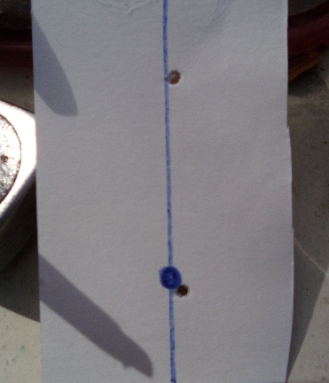

I'll add. Fresh hw /r you got to finesse in over time. In .177 my easy way for me is set up a card at 10m with a dot or tall cross shoot , learn that click amount that your off and zero on that aim point , once your zeroed on you should be pretty close at 50y and high at 30 . If you want zero at 30 then use / learn holdover/ unders on that scope or measure From the high hit to the bulls and make them appropriate clicks..
Like learned with this one gun. If I'm inch high at 10m I'm close to on at 100.
I keep that in memory and on scratch paper . So pretty much any distance I shoot I can first check and set the scope at 10m for this gun and pellet used . That cuts way down on wasted zeroing pellets spent....lots
Another thing using 10m card is I can do a quick trajectory check . If shoot it and see if my hight is pretty correct or if my windage is off before I shoot the primary range / target
Anyway more you shoot the more you figure this stuff that you finds best and easy for you .
( for a example)
A 10m scope check I just shot. Hight good ,windage good for this scope and gun zeroed @ 100y ( 2 shots 2ed the check shot )
My first shots get this or if something's looking off I got a easy check method.
If it's not then something's a miss somewhere
