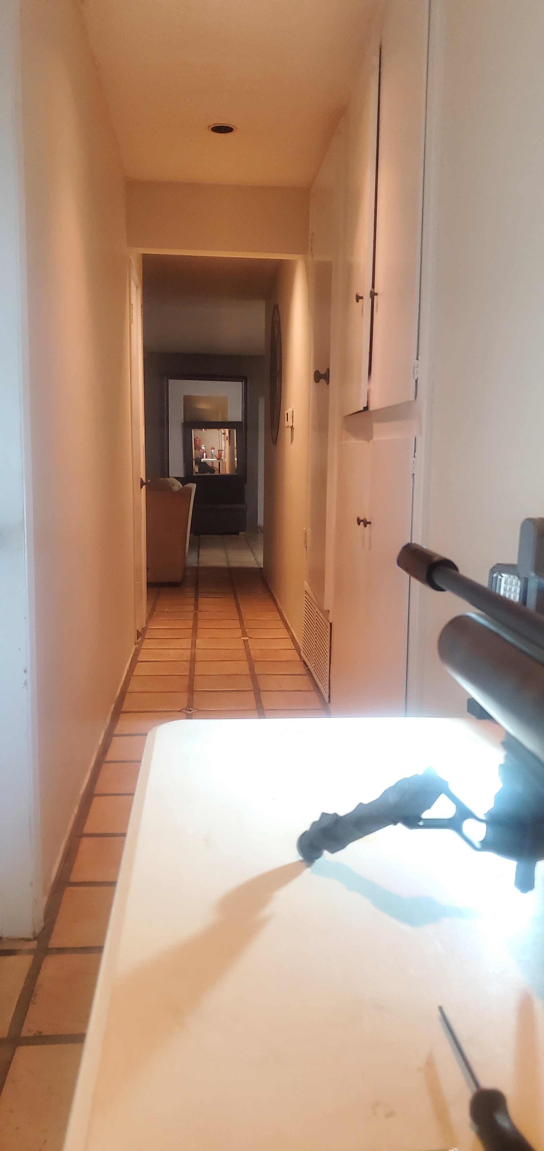

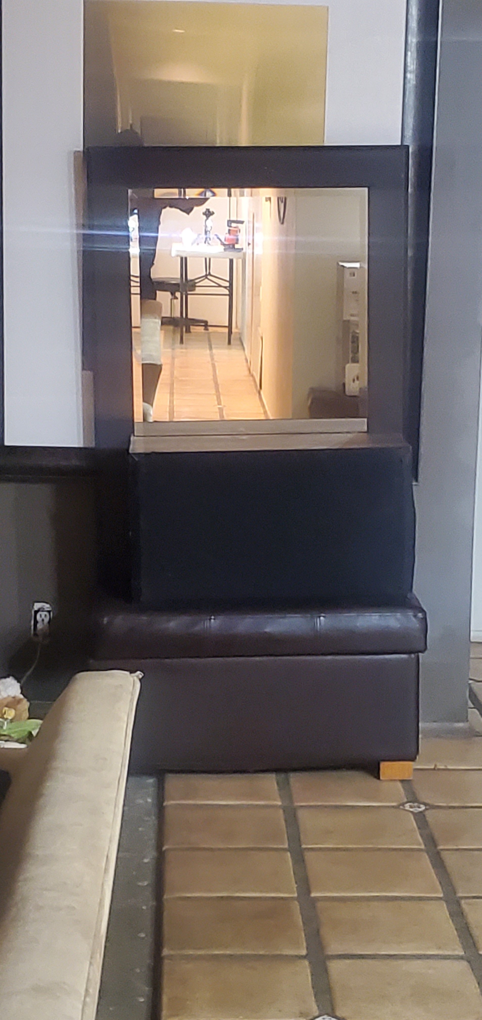

Well thanks for repeating what Scotchmo started. I decided to used another mirror rather than a closet door mirror that had some distortion in it. Why do I think it had distortion well the door frames in the reflection were skewed when looking in the reflection. So I got more of a dressing room mirror with lack of distortion when viewing.
And put it at the end of the hallway.

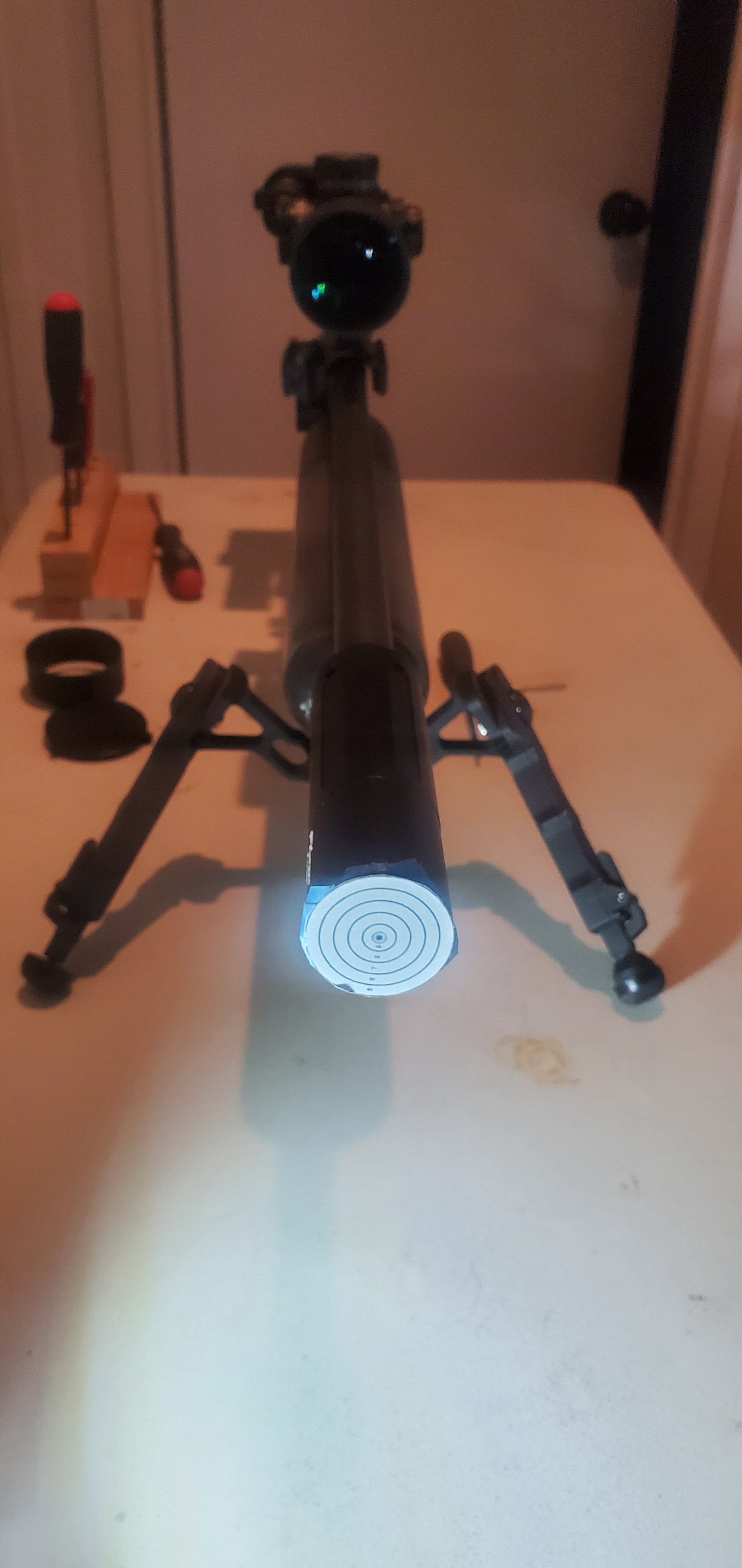

Then put a moderator with a targets I cut out to match the diameter of the moderator. This made it easier to see the center of the scope.

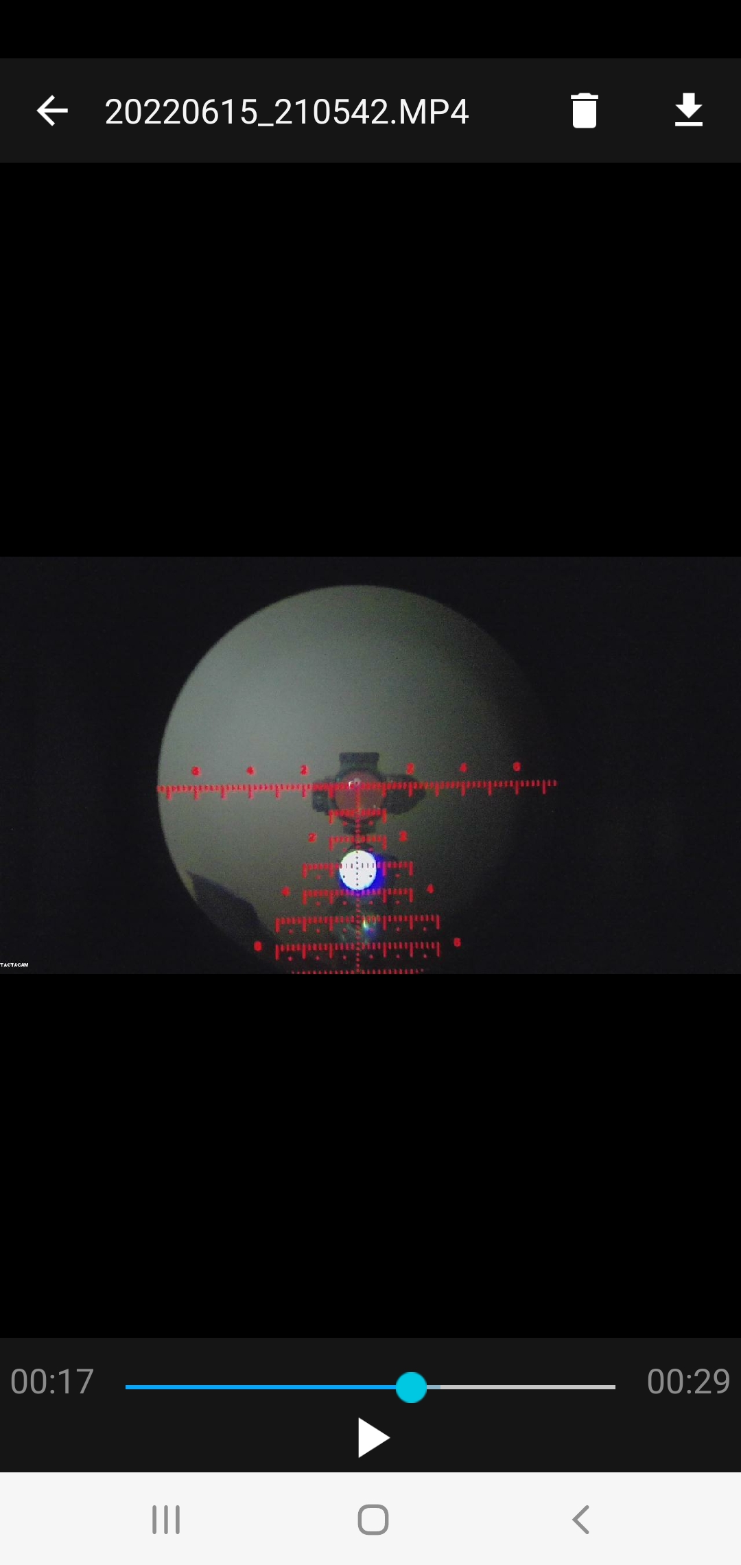

I shined a light on it to make it easier to see, adjusted the scope magnification up and it was easy to rotate the scope to line up the vertical retical with the center of the moderator and the bell of the scope. Wow not as far off as the first time.
