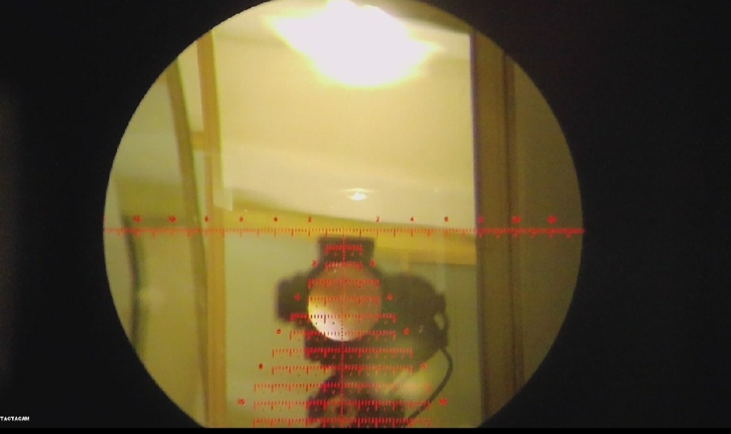

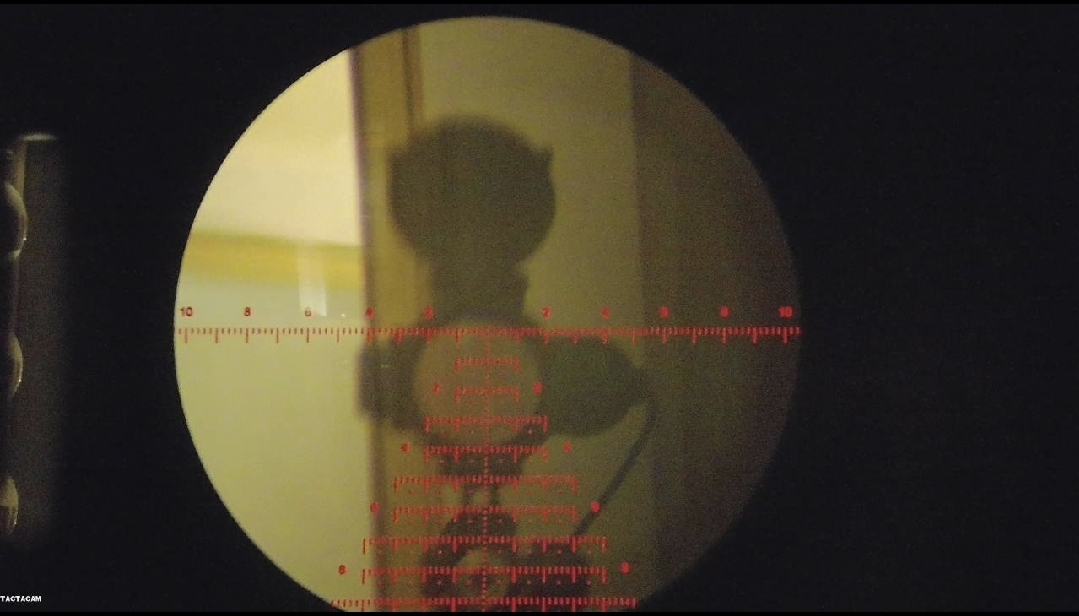

The retical is rotated in the scope? I am not sure if I am doing this right. I will have to try this again later tomorrow after work. But I thought my scope retical was in line with my scope because I used a special spacer made to fit under the flat part of the scope parallel with the rail. But when I did the mirror method it was off! A lot off! Notice how when the retical is centered with the bore, it is not with the scope bell?
