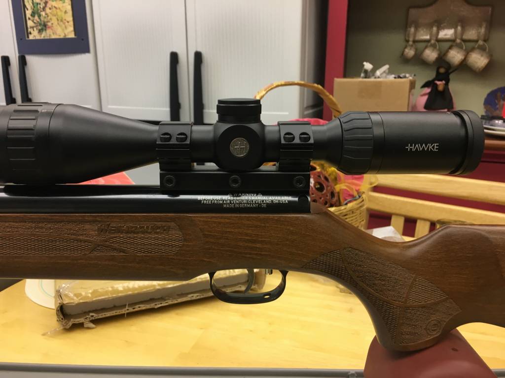

Hawke Airmax scope in UTG mount. I started at 20 feet. Center of target hold got me 3 1/2 inches low. Shimed rear ring until front bell touched receiver. Before shim I was four mil dots low. After shim I was two mil dots low. There is not enough adjustments in the scope to correct this. Did I get a bum mount? I’ve mounted many scopes powder guns. The mount appears to be installed correctly. Any ideas on what went wrong?
Finally, a resolution to the problem. Tried flipping the mount. No change. Tried Sports Match mounts. No change. Then I remembered the scope literature said it was factory set to optical zero. I went through the steps to reset to optical zero. That cut the point of impact discrepancy by half. It was a simple matter to dial it in using standard methods. Thanks to everyone for your input.
